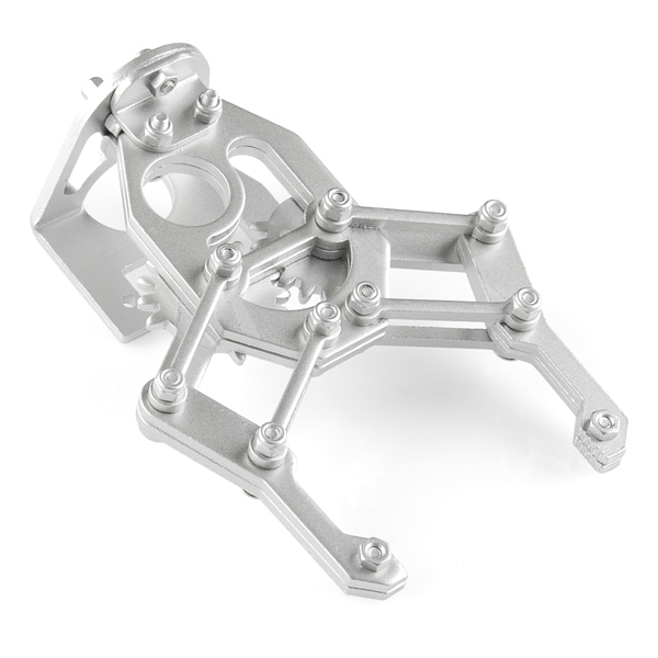

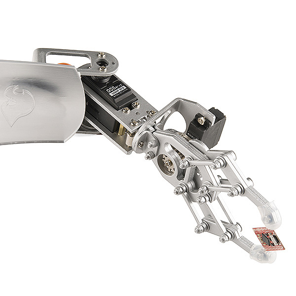

I am thinking about your two probe problem. I think this is hard.
I would build a "two finger hand". Two fingers = two probes.
Using parts form robot shops on line.
Program the hand:
1) set the distance between probe1 and probe2, The fingers move to 0.5 apart.
2)rotate the hand, set rotation to 90 degrees.
3)Move the hand to over the part.
4)move hand down.
From sparkfun.com Here is a two finger hand. Think of a probe on each finger.
They have many mechanical parts.
Program the hand:
4)move hand down.

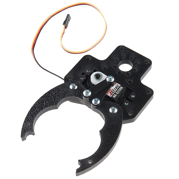

Servo city no longer has these. I have seen several different types. I like the (one servo) hand type. simple.
https://www.sparkfun.com/products/retired/11524
Spaarkfun.com does not have BUT They have a $6.00 and $10.00usd mini hand.
https://www.sparkfun.com/products/13174
---edited---
https://www.creatroninc.com/product/robotic-claw-mkii/
Found it $18.
https://www.spikenzielabs.com/Catalog/index.php?main_page=product_info&products_id=732
$12
https://www.spikenzielabs.com/Catalog/index.php?main_page=product_info&cPath=22_95&products_id=1078
