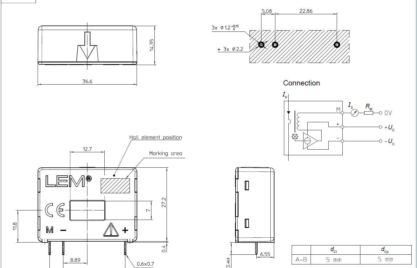

This extract from a LEM current transducer datasheet shows the internal arrangement, as part of the connection diagram:
The Ip "winding" is the cable being measured, passed through the window in the device, which acts as the primary winding.
The frame of the unit houses a rectangular ferrous core; some larger versions of these use toroidal cores.
The crossed box is a hall effect sensor that detects any field in the magnetic core - but for AC only, it could equally be another winding on the core.
The output of the error amp in the device passes current through the feedback winding on the core, at whatever level is required to cancel out the field produced by the primary, and that current also passes to the external sense or conversion circuit in whatever the devices are used in.

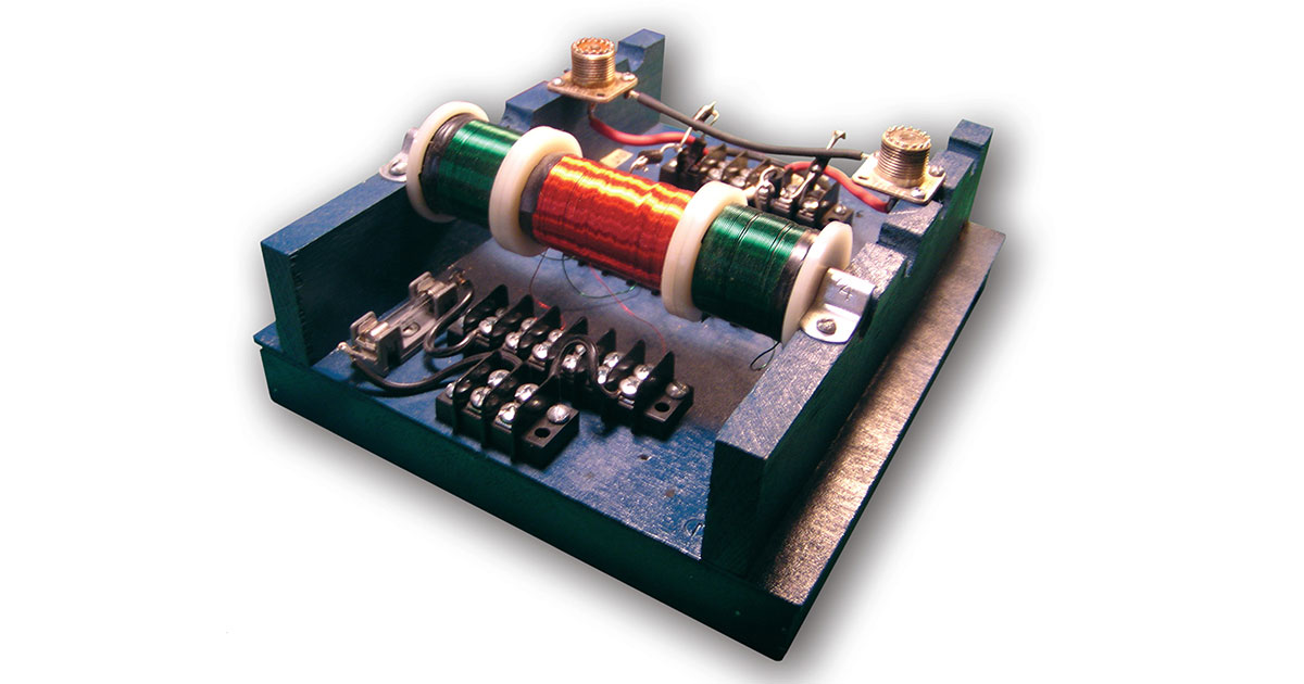

This will give you some basic ideas. To show concept.
Interesting!
The "Audio" one works exactly as I hypothesised one could in post #7 - two sections, two rectifiers for push-pull.
Still inefficient and overcomplex as an overall system, as you need to generate the carrier waveform (30KHz in the example, rather more for full audio frequency response), at rather higher levels than the required output power.
To control an existing AC signal or power, they are great; I've worked on many machines that use them, and using other core materials for higher frequency makes perfect sense, though I'd never seen those.
Creating a high power AC signal just to be able to use a mag amp seems a bit of a backwards approach, though..
