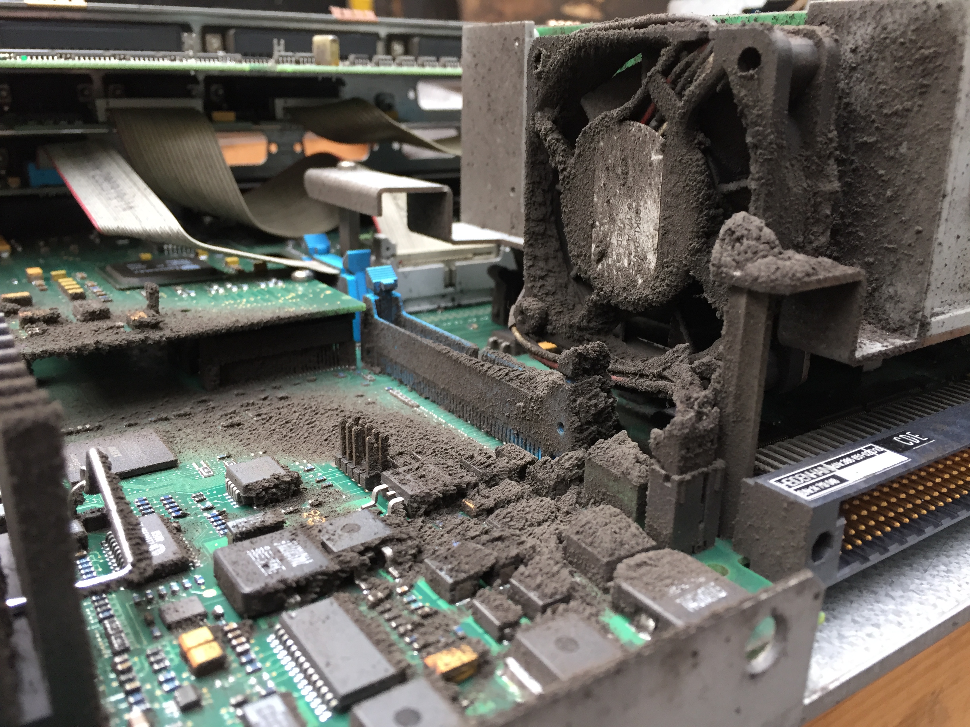

Just a bit of near comedy value stuff, while on the subject of cleaning PCBs:
Why electrical cabinet doors need to be kept closed and filters cleaned regularly!
The machine was apparently behaving erratically for a few weeks, then failed completely and we got called in to diagnose it.
The dust in a typical machine shop is largely metallic, plus carbon from cast iron. Overall, it's pretty conductive.
I'm amazed this one lasted as long as it did, and did not suffer any permanent damage!
(It's the main CNC module, several thousand pounds to replace it).

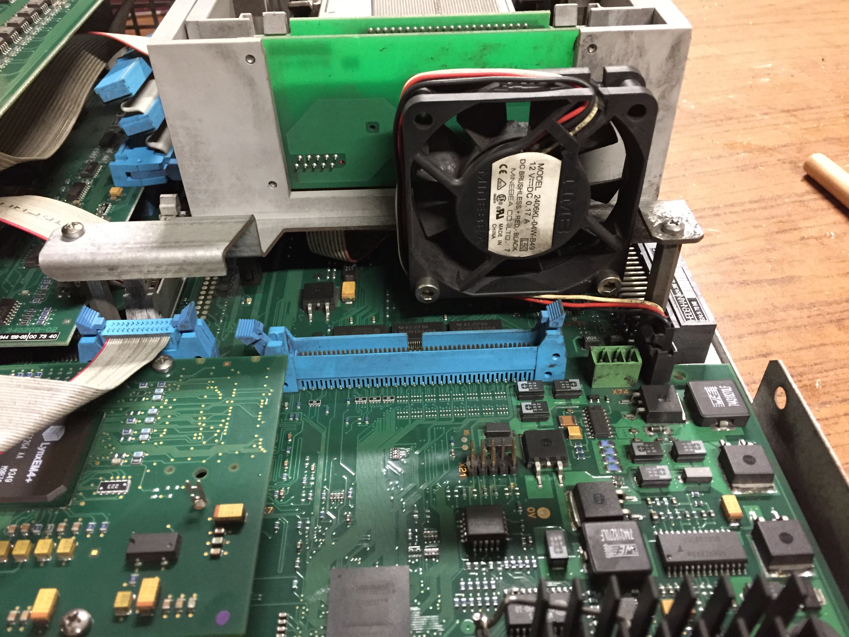

What it's supposed to look like, once cleaned:

Also consider that if this ESD event happened in the past two weeks or so, the low temperatures in the UK could have led to a dry atmosphere which is conducive with bad ESD events.

That cnc board is an ugly mess!
A good job for a vacuum cleaner and a soft paint brush :D
Which was how we used to clean out CRT television sets, although of course the dust isn't conductive and didn't cause any problems. We used to vacuum them out when we repaired them, mainly because it's too messy otherwise - we wouldn't advise cleaning the inside of your TV if its not faulty, as it won't help anything cleaning it out, and (if you're clumsy) you might actually cause damage. In the CNC case though, it's obviously as VERY good idea to regularly clean it.

wow.....amazing dust-scape with the CNC!
I woudlnt know where to start to clean that. Vacuum would worry me a bit in case any ESD effects from moving air from a hoover....but i guess you had it con coated too.
No conformal coating - if there was, the dust would not be able to short things out.
That was an unusually "dry" one, most CNC and drive boards that need cleaning have mist from coolant or oil mixed in with the dust, giving it a consistency anything from like heavy oil to something like cooked-on chip fat.
