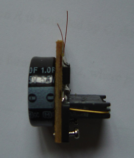

I think that the trick is that they have used a memory retention cap instead of a standard one.
This one has a value of 1 farad and a leakage current of 315uA.

seems simple enough, would there be enough current to power LEDs for 20 minutes though? Seams like it would take alot.. unless they weren't very bright LEDs.

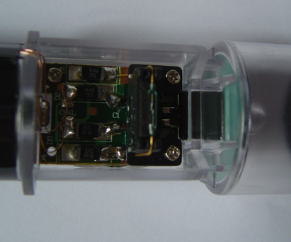

You were right, 1F, 5.5V capacitor. Heres some pictures from mine...
Any ideas on how you want the LED tested? At 5.5V maybe, to see current draw?
Oh, and the magnet inside is DAMN strong. Don't let your finger get between it and another metal object ready for picking up! If it comes within one foot or slightly more on my monitor, it goes crazy...

Ah!, That's great! We can see the bridge rectifier also.
The next thing is to find out what current the LED is pulling.
With what Nigel provided us, even at 10mA, a 1F cap would only last 100 seconds, so to get it to last 1200 seconds it would need to run at 0.83mA. That's very very little...
Does anybody know whether the torch can last for 20 mins after a 30 second shake?
I wonder whether they are relying on the fact that during use the torch will be moving, causing some recharging of the cap.

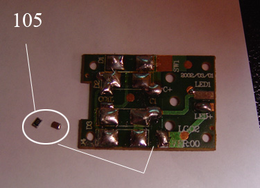

I don't know if it was a resistor or not, but it was kinda broken already i think. I tested the resistance, at 1.01 Megaohms. The little thing has 105 written on it. I've taken a picture with all the components removed. AS you see, the little thing, is sorta two things, though the one on the right has no connectors or anything.
There was nothing inside the plastic thingy, and nothing under the capacitor. There is one marking on the PCB called 'LG02' though. I've no idea what thats for.

The little things are just Surface mount resistors. You read there value the same way you would read a normal resistor. 105 means
1 0 and 5 zeroes
1000000 ohm

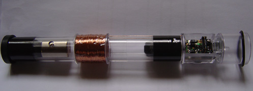

you need as many turns as possible.
since you have a small current trough it, you don't need very thick wires.
and the magnet....it has to be a permanent one, very strong.
building it was harder than i thought it would be or maybe its because im a beginner? anyway it is hard to find a really strong magnet to do the job. *sad*
