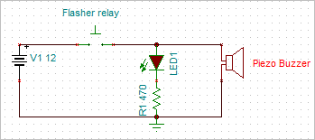

But, how about just find the "blinker" relay (there's got to be one somewhere, and generally close to the steering column area) and splice a line from its output to a simple piezo/LED circuit:
http://www.ebay.tv/sch/i.html?_sop=...rand=RadioShack&_dcat=14964&_nkw=piezo+buzzer

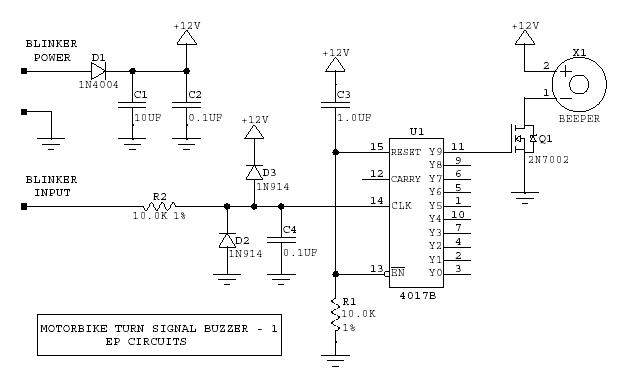

But wait, there's more. As a starting point, here is an all-digital (that just sucks, man) solution from last December on another forum. Rather than an R-C delay or missing pulse detector, it counts turn signal flashes and beeps on every tenth one. With one additional diode that can be changed to latching on after x signal flashes. Add the LED and its series resistor in parallel with the beeper.

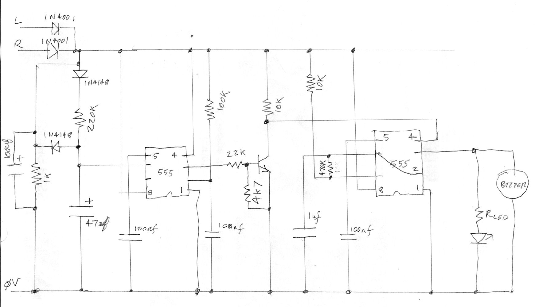

I think this should do what you want.
You will probably have to adjust the value of the 220K resistor as electrolytic capacitors have a very wide tolerance.
I am inclined to agree with DerStrom8 that just a noisy relay would be a better solution.

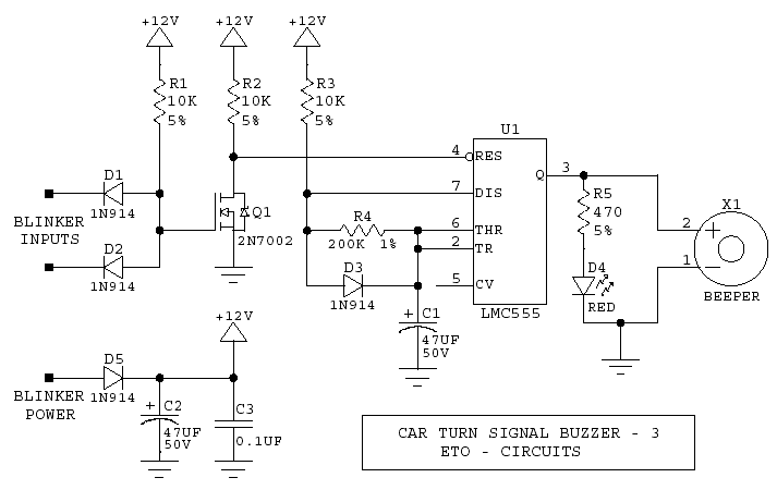

I agree with DerStrom - something that is rigidly timer-based fits only a narrow range of driving conditions. This circuit is more of a gentle periodic reminder than a timeout alarm. I haven't given up on the counter-based idea, but a gated 555 is pretty simple, especially when the available input signals are so limited.
D1-D2-Q1 form a NOR gate that enables the 555 oscillator whenever either turn signal connection is grounded. R1 secures the Q1 gate when both inputs are open. D3 makes the 555 wildly asymmetrical - 0.5 s on, 10 s off. While the two timing resistors do interact, it's not by much; adjust R3 for ON time, R4 for OFF time.

Doth Pin 5 get connected to anything?
Not in my world. That modulation input is a fairly low input impedance point, and a little induced noise on the internal resistor divider stack isn't going to affect the circuit operation noticeably. The universe has only so much capacitance to go around; save your 0.00000001 F for something else.

Hi AK,
My understanding is the kimbear wants to use a +12 volts signal to trigger the unit. That is my interpretation of his statement "12v dc is available at the turn signal switch, which is simply a on/off/on arrangement with the center position as off. Using steering diodes, I can combine the 2 into 1 =12vdc signal when either one is activated." in post #1o I understand this to be a solid 12 V (I.E not pulsed.) Also I think you must have been half asleep when you drew the schematic in post #19 Your negative OR gate output from the blinker inputs is connected directly to ground. I think your circuit will pulse the bleeper and LED on at about 0.05 Hz (Once every 20 seconds) Also a 1% tolerance resistor for R1 seems pointless when C1 will probably have a tolerance of +50% -20%
