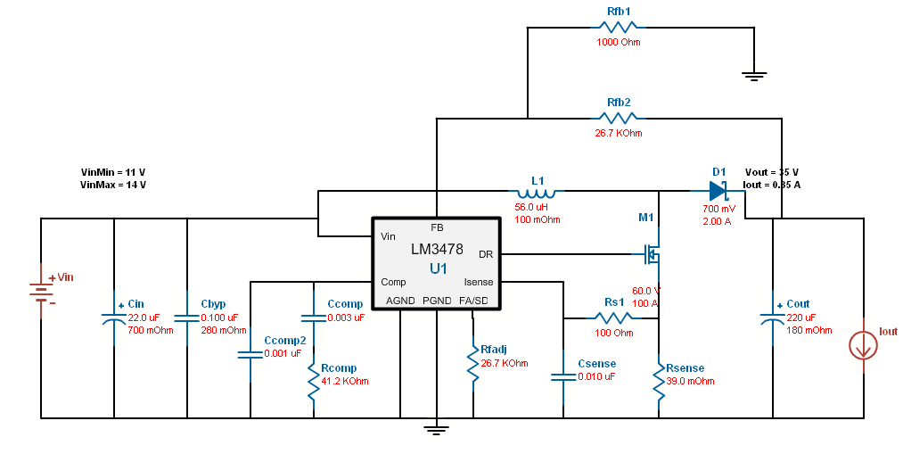

3. input: 12V DC
output: 32-36V and 350mA DC
So, How can I develop it? any idea? any design? any direct IC available?
thanks.
3) You did not state if the supply is isolated. So here is one not isolated.
