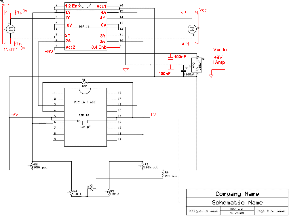

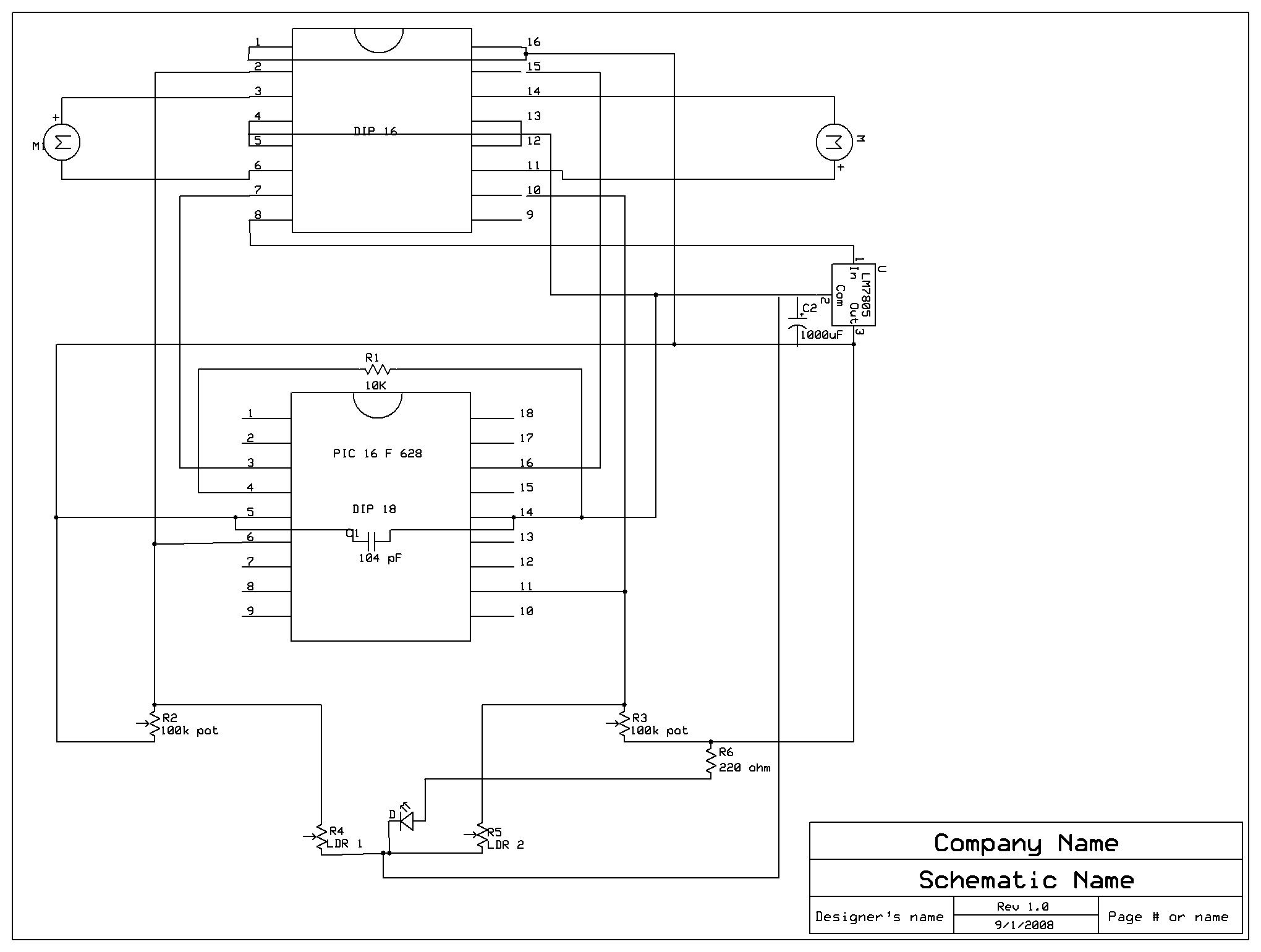

Really sorry about messing up with words, O.K. so this is happening :
After connecting that diode ckt (with 1N 4148) both motors runs very slow and after detecting light on one side ( deviating from black line on one side ) the corresponding motor get reversed ( yet very slow),
While on the other side ( i.e.: with the other motor, while the BOT goes off the line on the other side ) the whole ckt get hang and I have to restart it.
NOTE:
In this attachment I tried to show almost exact places of components, I have it on strip board so the horizontal connection are the strips only and actually it is not that much conjunctive as it looks.
As you can imagine some components actually not required wire connection as their leads are sufficiently long.
Edit: PLEASE CONSIDER 1000uF CAPACITOR IN REVERSE POLARITY. SORRY!:eek:

hi Chris,
Look at this marked up dwg.
The 7805 requires 100nF caps close to the input and outputs, these caps are required to prevent the7805 from instabilty.
Your schematic does not show the power supply input to the 7805.?
L293 pin9 3,4 Enb is not connected.
The 1N4001 diodes are required.
Did you write the program.?

Hi Eric !
First, do you mean to say that pin 3 and 4 are not connected in schematic ?, well I made that sch. in just few minutes so please excuse me for that, in actual ckt they are well connected where they should be.
I am using the typical 9V battery ( that adapter got some problem, I mentioned in some earlier post ).And yes I wrote the program which is in much much basic form:eek:.

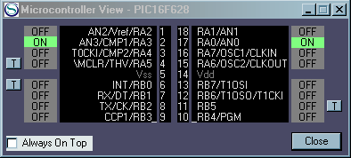

Anyway look at this program run result.
your code.
movlw 	b'00100001'
movwf 	TRISB		;set RB6 & RB5 as input
Look at the direction of the PORTB pins 5 and 6 [ in the image]
BTW: the 'T' means its an Input..
EDIT:

Thanks for those links ! Do you mean to say that I should not have kept pin RB 5 as input when I'm not using it ? Please be simple in language because this is my first ever MCU project.
You say in the program comments that RB5,6 are Interrupt inputs, but RB6 is set as an output, so an Intr on this pin will never be detected
