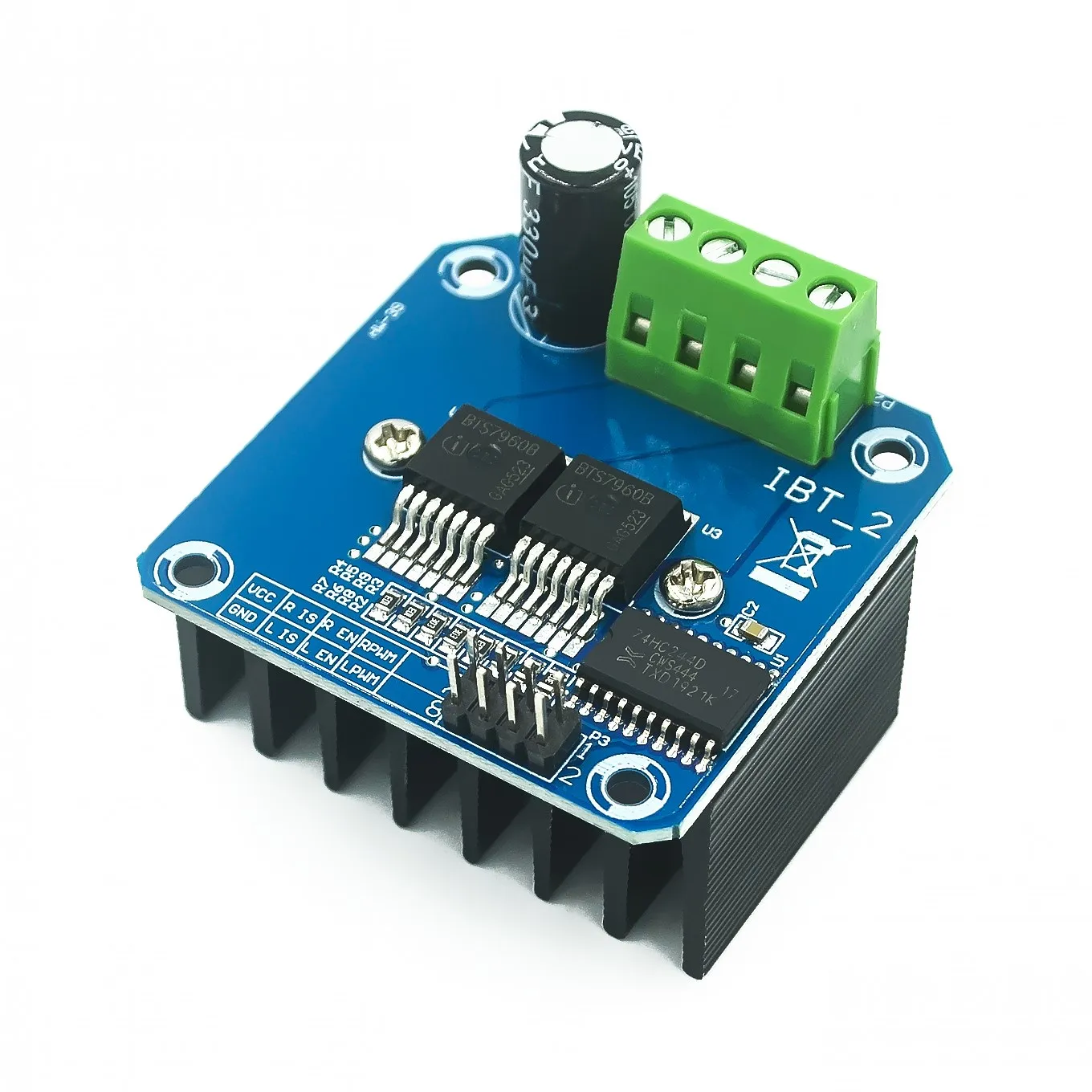

"Bare" DC motors are easy in principle, though you need something to control the motor power. That can be relays, simple transistor switches or pulse-width modulation using such as a cheap IBT-2 power module (from ebay or aliexpress), which can control things up to around 40A and up to 24V DC, using logic signals directly from an MCU to the module.

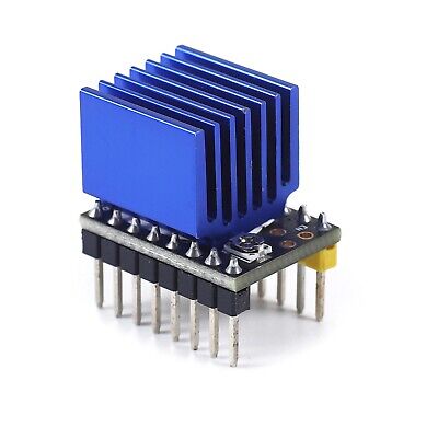

Fast and efficient stepper control needs a more advanced driver system; you can get stepper driver modules for 3D printers very easily, which can be used with MCUs.

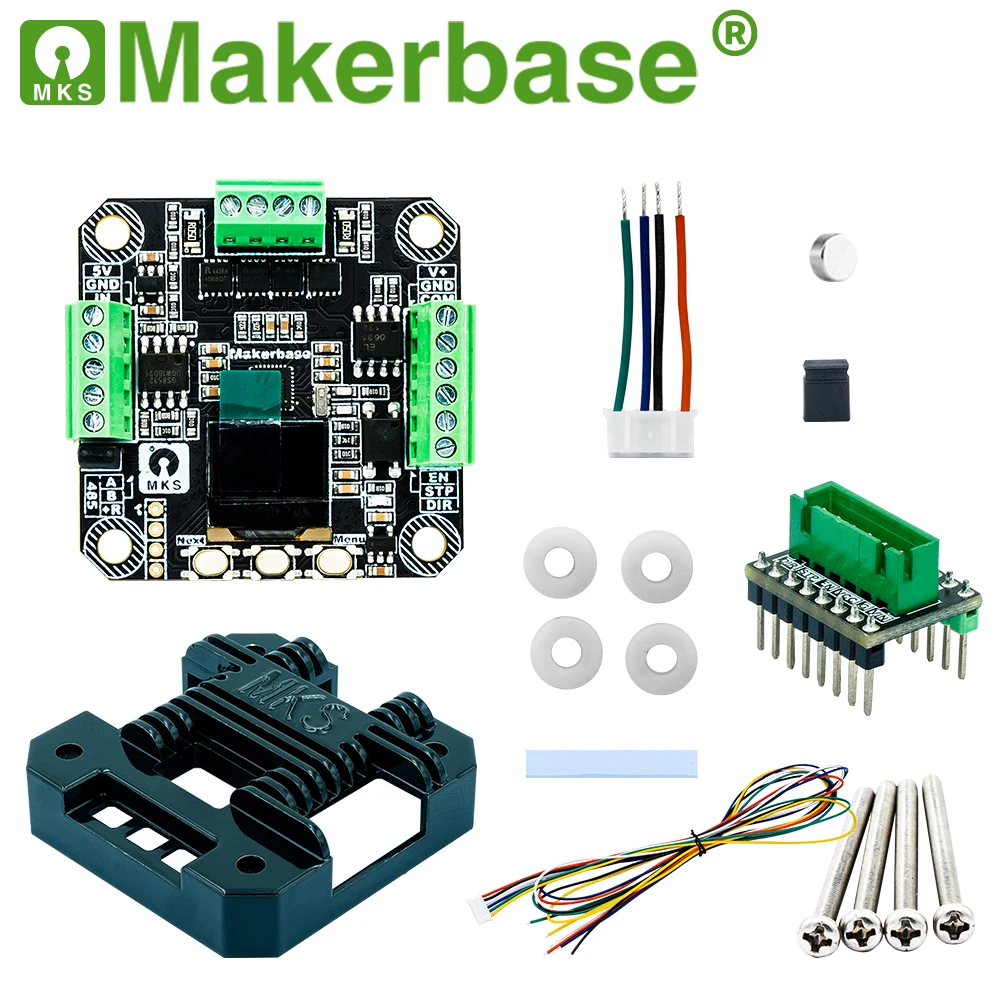

You can also get self-contained "intelligent" stepper drivers that attach directly to common motor sizes, and all work over a serial or CANbus link, so just two data wires and two power wires for several motors. These include a motor position sensor (encoder) so can be extremely precise. I'm experimenting with some of these at present.
