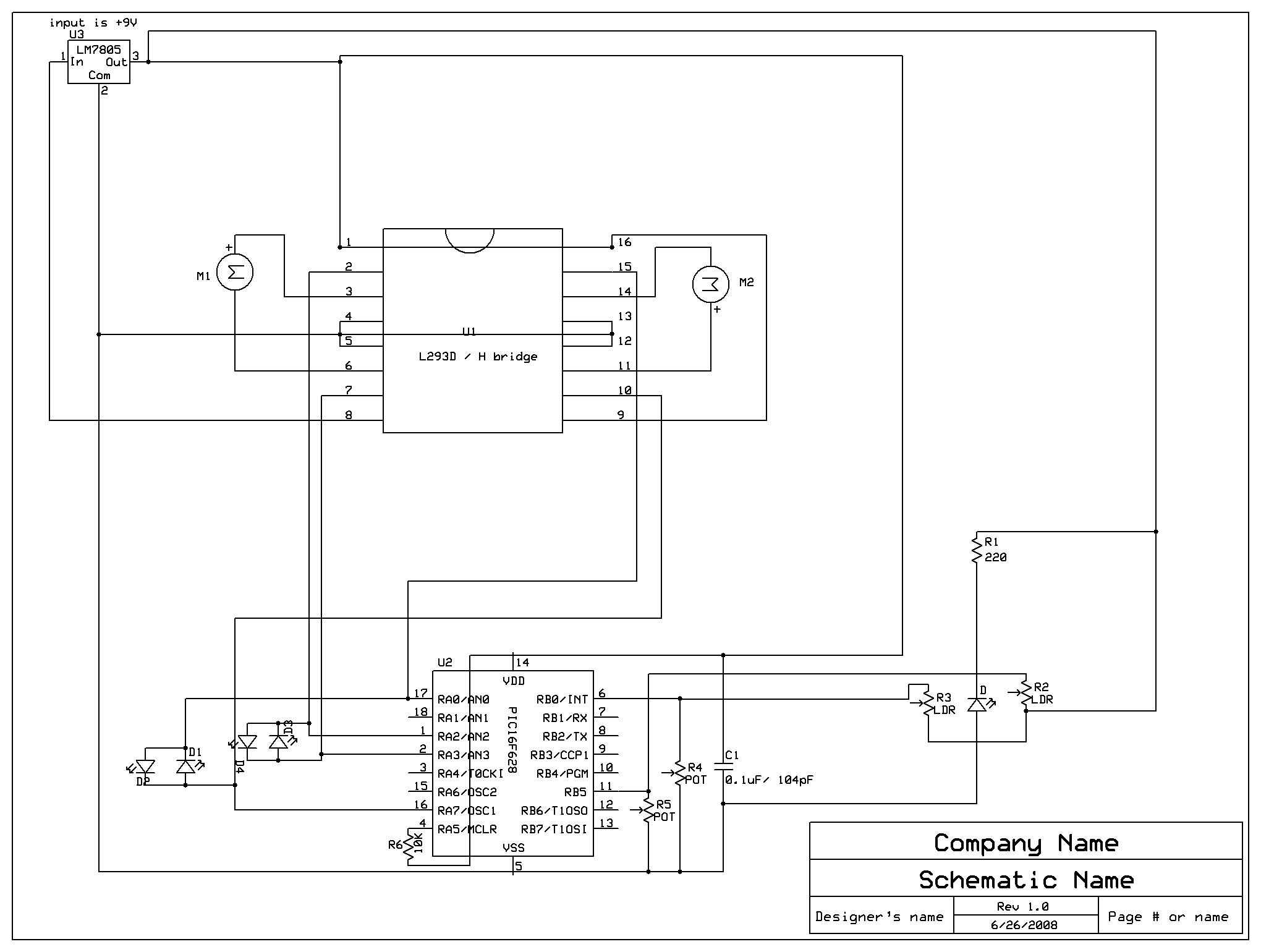

Hi there !
I been not able to work on my robot for a long time for some reasons and also not on electro-tech, but finaly I have finished it but it has just one problem that output of L293D is just 50mA. I am attaching a schematic of my robo.
The LEDs connected to MCU pins ( in alternate polarity to the same pins ) are the input pins for L293D and the LDR sensor section is shown far right. I know that these LEDs connected directly to MCU drop volatage so I tried removing them but did'nt help. I connected LEDs just for indication that at least digital part is O.K. Please help me I selected this robot for my collage project and have to submit in a week !
I am using 12V adapter for power supply for testing and then will switch to +9V battery.

hi Chris,
A quick look, whats the purpose of the reverse parallel LED's across the PIC pins to the L293.? Depending upon the forwad voltage drop of the LED's wont they clamp the L293 drive signal.?
Whats the current rating of the motor and the 12V adaptor.?
Yes it will clamp it and that's why I wrote that I tried with removing those LEDs but then even the current falls to 50mA, so I connected them back just to make sure that at least MCU is doing it's job, and that's why I add them in schematic actually they are not permanently soldered there so please ignore them, and the worst thing is that before I tried removing LEDs the current was at 160mA but that was not enough to carry the load of ROBOT ( the motors were moving ) so I tried removing the LEDs and then THIS HAPPEN JUST 50 mA:confused::confused:

Hi Chris,
The voltage you measuring from the adaptor, is that when the motor is trying to run.?
Some adaptors have a very poor regulation. It also sounds as though when you connect the 3V motors you are pulling the 12V so low its resetting the PIC.
Measure the adaptor when its on load.

hi Chris,
Taking the second part first, as I understand you said, when I connect the 3V mtrs the robot stops and you have to restart, is that correct.
If yes, most likely whats happening is that the +5V is being pulled so low that the PIC is crashing, so you have to restart.
Some of these small mtrs [3v and the like] can draw a heavy current when starting up, a battery will be able to supply this heavy current, but the regulator probably not.
Your drawing is not showing a large value capacitor on the +5V line. A large cap is usually fitted in order to supply current surges required by the mtr.
I would measure the current drawn by both types of motor using a 3V battery for toy mtrs and a 5V supply for the cassette mtr.
When doing this test apply finger pressure to the shaft of the mtrs so that they have a load.

hi Chris,
I have been convinced from the start that the problems that you describe are related to the adaptor and series regulator not having the voltage/current capacity to drive the mtrs.
The fact that it runs for a while with a 1000uF cap then slows/stops suggests that the 7805 or adaptor are overheating.
If the 7805 gets HOT it will go into thermal shut down, it may require a heatsink.
Also a 500mA adaptor is IMO under rated for the job, try a 9Vdc at say at least 1Amp.

I am suggesting an adaptor voltage that will give at least 3v to 4v drop across the 7805.
If an adaptor of a higher voltage is used the 7805 has to dissipate more heat.!
If for example the mtrs draw 0.5A, with a 12V adaptor there is 7V across the 7805.
Heat/power = 7 * 0.5 = 3.5Watts!......... for the 9v adaptor it becomes 4 * 0.5 = 2Watts.

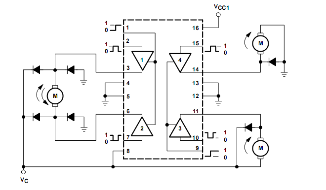

The 4 diodes shown in the dwg will reduce the back emf.

I don't get that how that reduce the back emf, I don't understand how the back emf voltage get grounded with those diode.

hi Chris,
Ref the diodes.
When the back emf from the motor is greater than the suppy voltage [+ diode voltage drop] the diode will conduct and clamp the back emf to to about Vsupply + Vdiode.
If any back emf trys send the motor connection to a minus voltage, the lower diode will conduct and clamp it to about 0V [allow for diode drop]
Back emf on the power rails can get back into the PIC and other logic, thats why its essential with motor and relays etc, the decoupling caps are present.
I would have at least a 470uF and say 4 or so 100nF on the +V rail to 0V.
A 100nF should be close to the PIC power pins.
