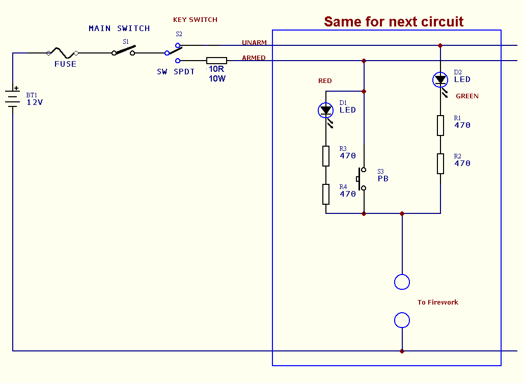

Hello, this project builds off the the work done here:
https://www.electro-tech-online.com/threads/electronic-firing-system-for-fireworks.21046/
My goal is to use a microcontroller to control the firing of a large number of cues. The exact number isn't important, but at least 64 would be preferred.
I'd like to replace the pushbuttons in the following schematic with mosfets.
The image is by eblc1388 and taken from the thread referenced above. I apologize if I should not have posted the image here. Please let me know if I need to remove it.
The mosfets would be controlled by an led matrix; for example: this or this. The mosfets would replace the leds in the matrix.
Is this feasible? Is there a better way to do it?
Each cue would require 1-2 amps for a few seconds max. Several cues may be fired immediately in succession or there may be a pause of several seconds between firings.
Thank you in advance for all of your help.
Not clear how you'd do that. The LEDs are 2-pin devices whereas the FETs are 3-pin :confused:

That was a manual fire system. If you want computer control you need to start over.

I would keep a physical switch to arm/disarm all fireworks. I would also charge a large capacitor for each firework and discharge that into the firework on cue.
Controlling 64 is easy from a micro. Use a series of shift registers to create a 3 wire port expander.
I can rustle up a basic circuit for one if needed.
My brother is into fireworks big time, **broken link removed** , and he uses a relay output based control system being relays are next to impossible to trigger with a stray static discharge event that would normally turn or even short a FET based output to full on plus the mechanincal contacts in a relay are far more forgiving to the occasional short circuits that happen in output lines as well.
Physical switch, in addition to other safety features are a must. Here I'm just focusing on getting the cues to fire. My concern with capacitors is that they may have a charge and I wouldn't know it, thus setting off a cue accidentally. Or don't I need to worry about that?
Is there a way to control mosfets arranged in a grid using one shift register to control rows and another shift register to control columns?
Source and Drain of mosfets would be connected to 12v car battery.
As you can tell, I'm not very knowledgeable regarding electronics. I'm trying to get the concept worked out and learning what each piece of the puzzle is doing.
