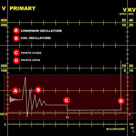

This is what you get on the negative coil terminal. The spike is over 100 volts. Electronic ignition is similar. Complete explanation at **broken link removed**

Thank you for that link. I would have never found that. This diagram is also very interesting. It shows the cycle between the cylinders firing.
Does this still mean I need to build a schmitt trigger? One that will filter out that triangle spike stuff in the middle of each firing? Also how do I bleed off that very high voltage?

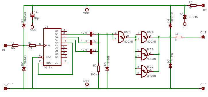

I build a similar circuit that you are looking for. I used a 555 timer, that was triggered but the spike from the coil. I used it with a PIC so the output of the 555 timer was 0-5Vdc, perfect. I shall look for the schematic and post it. It worked really well.
We could possibly design something for you if we knew a little more about what we have to interface with. What ICs are you using for your pulse-dropping circuit? Can you post a schematic?
I'm at work right now and can't find the new version but here's my original design I started with. It had a minor bug (somewhere around C1, C2, and C3) which I eventually fixed but the basic input and outputs are still the same. Hope this helps.
BTW I'm still struggling / learning Eagle Soft so sorry if it looks horrible :) You especially don't want to see my PCB designs LOL
BTW - I had help getting that design. I think for the most part I understand that design now pretty well but I did not come up with it on my own.

I've added a clipper (the input zener clips both positive and negative transients), a simple (too simple?) lowpass filter, and a Schmitt trigger.
If 2 parallel gates will give you enough drive strength to drive your tach, you could use one section of IC2 as the input Schmitt, avoiding the need to add another IC to your board.

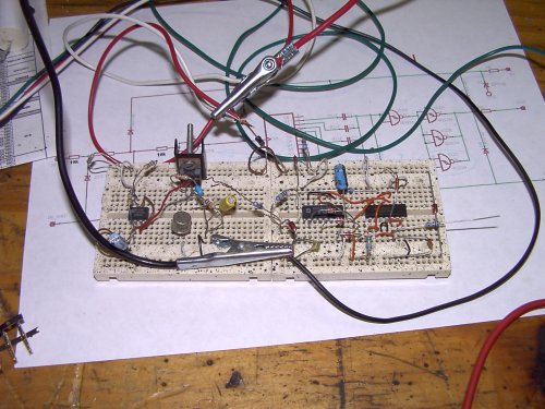

Thank you very much for helping with that modification you made to my circuit. I pulled apart one of my tach modules tonight to try and mod it but found there was to much to change on a pre-made circuit board so I built your circuit from scratch on a bread board.
I then made a simple 555 frequency generator to simulate an engine's ignition pulses to test the circuit and got it working. I have an after market tach on the work bench to check output and my multimeter has a frequency meter on it too which is really helpful. Of course that only tests that the circuit is working and I got all connections in the right place.
It was to late (noise) to fire up one of the trucks and test it for real off the ignition coil (primary negative).
So tomorrow I'll test it out and see what happens. Fingers crossed :)

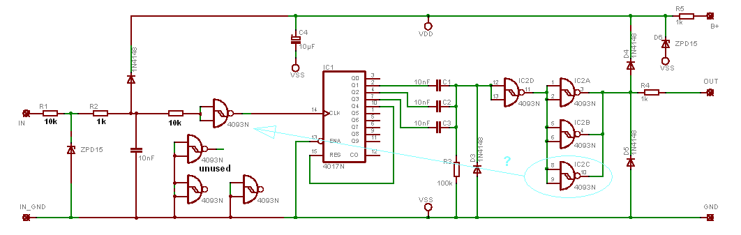

Roff,
I've been struggling all day and can't get it working. That capacitor you added in the front there makes a difference. I had to change it from 10n to 100n so that the needle would start responding. The problem is the needle jitters. I think the duty cycle of the output signal is off.
My after market tach has a filter that allows me to connect it directly to the negative terminal on the coil and it works fine. However when I hook it up to the output of my circuit it jitters.
Here's my updated circuit. I also added your mods to it. I ended up adding a second 4093 instead of stealing part of the one already there. Man I wish I had a scope. Can anyone recommend a cheap simple scope I could buy somewhere?
BTW - I looked up the specs on my after market ignition system and it says it outputs a 12 volt square wave at 20% duty cycle.
I assume that means it stays at 12V for only 20% of a cycle and then 80% at 0 volts? Anyhow I noticed the 4017 counter has its outputs at what seems to be 100% duty cycle and one output comes on while the last is still on. I made a 555 circuit going at 1 hz and the used LEDs to see the output of the 4017. One LED comes on and stays on, the next LED comes on and the other goes out what seems to be simultaneously.

Going back and looking at that scope output for a cars ignition it would seem I need a zener diode of around 5v on input (the one you added to my circuit). However all I have is a 15v zener and maybe that's my problem? I will see if I can pick up some 5v zeners on Monday.
Malcolm

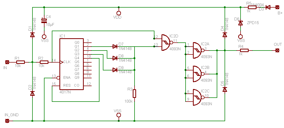

Malcolm, a 5V zener won't work. The circuit I drew (with the 15V zener) should work fine, as should the RC filter. Your logic following the 4017 is the problem. Try the circuit below. This should give you 3 pulses at the output for every 4 input pulses, and the output pulses should be the same width as those from the ignition.
You should probably use coax as the connection from the ignition to this circuit's input, as you need a good ground return path, and the shield may help keep EMI from the high voltage of the ignition secondary from appearing on the input signal.
