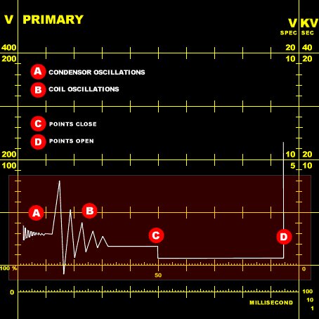

This is what you get on the negative coil terminal. The spike is over 100 volts. Electronic ignition is similar. Complete explanation at **broken link removed**

Thanks, a couple of questions about that graph though - which scale should I be reading ? At point C, what voltage does the coil drop from and to ? It looks like closing the points takes it low, or am I reading the wrong scale ?
The points ground the coil so the line between C and D is at ground. Use the primary scale on the left. It doesn’t say but I would think they are using the 0 to 200 volt scale.
So the spike would be about 115 volts. The coil oscillations do go below ground.
If I want to make a signal for a tach that is programed for a 8 cylinder engine with a points style ignition I just need to supply negative and break the current flow 4 times per revolution of the shaft? Sorry about the incorrect terminology, I am a beginner at this stuff and don't know all the correct words yet.
They are using the KV scale on the right of the screen.
D would be the actual firing of the cylinder when the points open and
C would be points closed for charging the coil.
