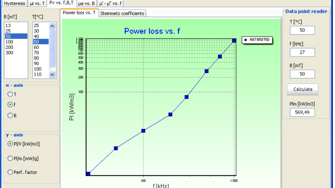

Ferrite Bead
permeability with more conductive metallic oxide, makes them lossy
- good for BJT spurious resonance and EMI control in switches and logic and DC motor & stepper motor noise
- not good for RADAR pulses, MOSFET PWM bridges and high speed switches where latency is important
Some theory https://product.tdk.com/en/catalog/datasheets/ferrite_summary_en.pdf
Mn-Zn for high Mu low f EMI
Ni-Zn for lower Mu UHF/uWave
One of the best in Ferrite is TDK who have a design tool
https://en.tdk.eu/tdk-en/180490/design-support/design-tools/ferrites/ferrite-magnetic-design-tool
Catalog shows more than most makers of ferrite, but they make more for customers.

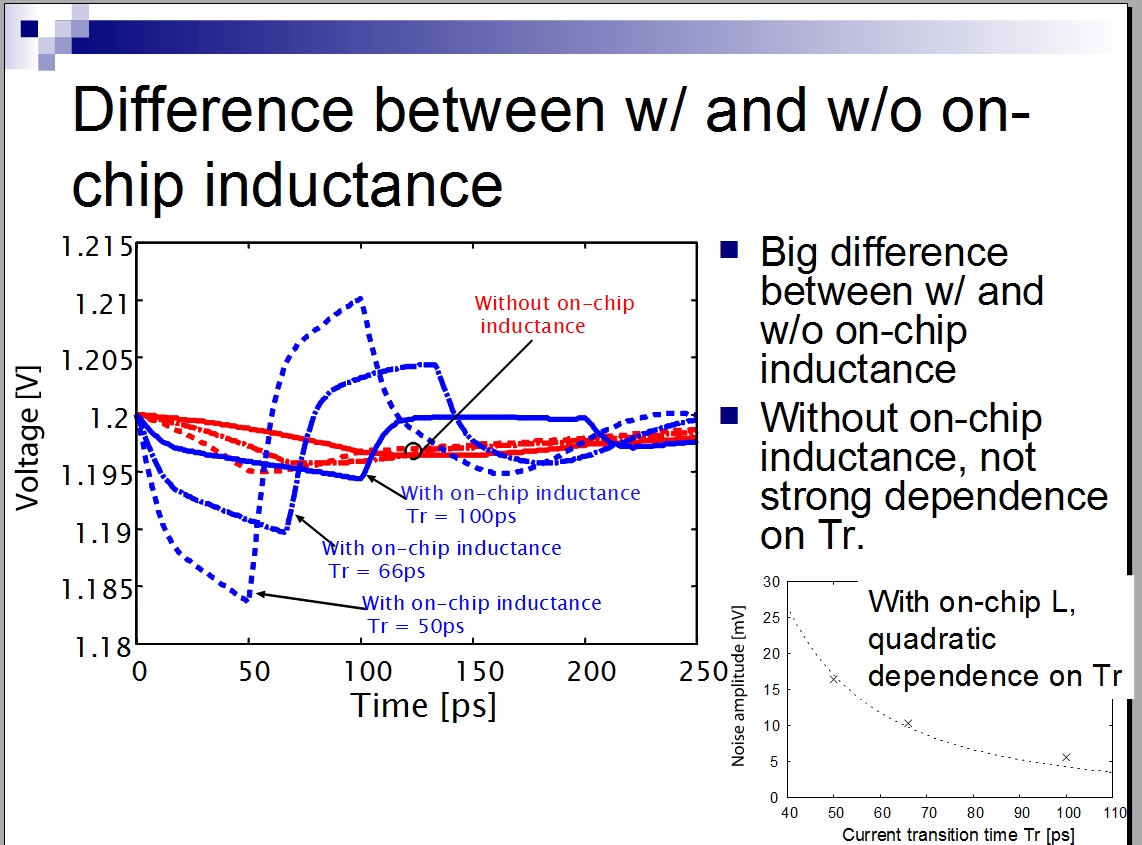

To add some perspective, IC design must consider ESL or effective series inductance in routing of high speed signals to reduce overshoot and ringing.
