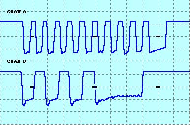

Making progress.
Got the beginnings of PS/2 protocol based communications working. Still need to work on parity, open drain, weak pull-ups, and some other little odds and ends before it's even close to finished. We can probably do some hardware tests tomorrow or the next day if things go REALLY smoothly. Here is a screen shot of sending the start condition, followed by 0xD4 (b'11010100' LSb first.)

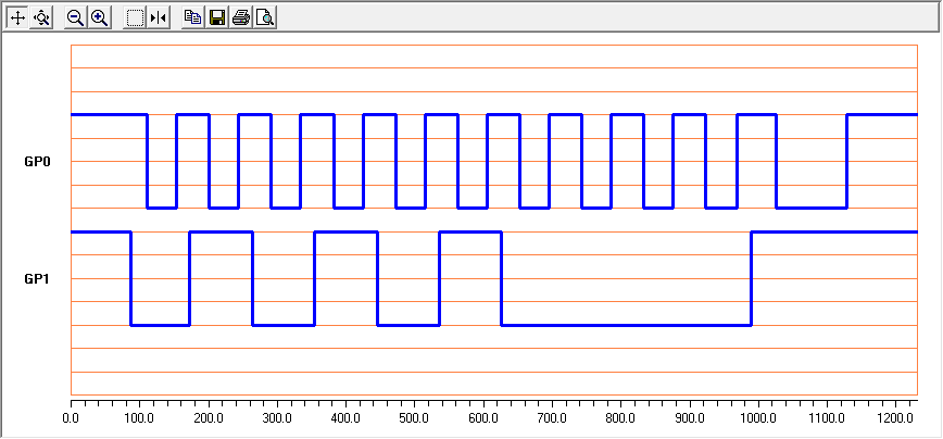

OK, another update.
Things have been going kinda slow. It's really hard to use sink-source-float capable PICs to make buses and protocols that are open drain/collector, do only to the fact that MPLAB doesn't have support for simulating pull-up resistors. Thanks to this, what should be 200~300 lines of code, is at about 500, do to all the if-then statements I had to add, just so I can make the waveforms show up in the dang logic analyzer and let me... analyze them. I have basically had to write all my code twice, one set of algos for the sim, and another that SHOULD approximate that exact behavior when in the chip.
And therein lies the crux...
We can't be sure, when we run into problems with the test circuit and chip, that it isn't a bug in my code, caused by the two different algos not matching in functionality, as I intended.
But we will deal with that bridge when we come to it...

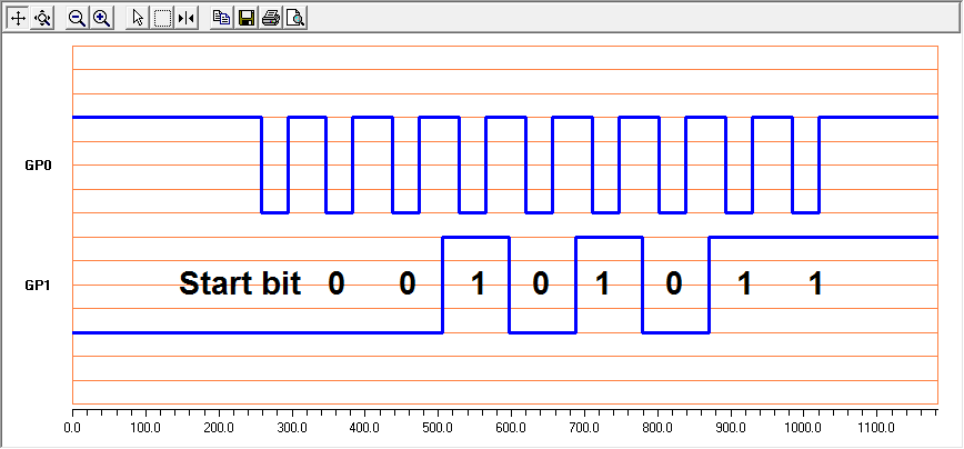

In any case, I *DO* actually have what appears to be fully working PS/2 transmitting capability in simulation as of right now. Does starts and stops, parity, LSb first order, checking for bus idle state... pretty much everything. Here is a screen shot of what the sim claims I'm sending out of the chip. The byte being sent is "Q" or 0x15 exactly as in the PS/2 article from before...
(I even duplicated the last low clock pulse lagging a bit, for kicks.)
And here again, is what the waveform for the same code/sequence/protocol looks like with a real device, from the same PS/2 article...

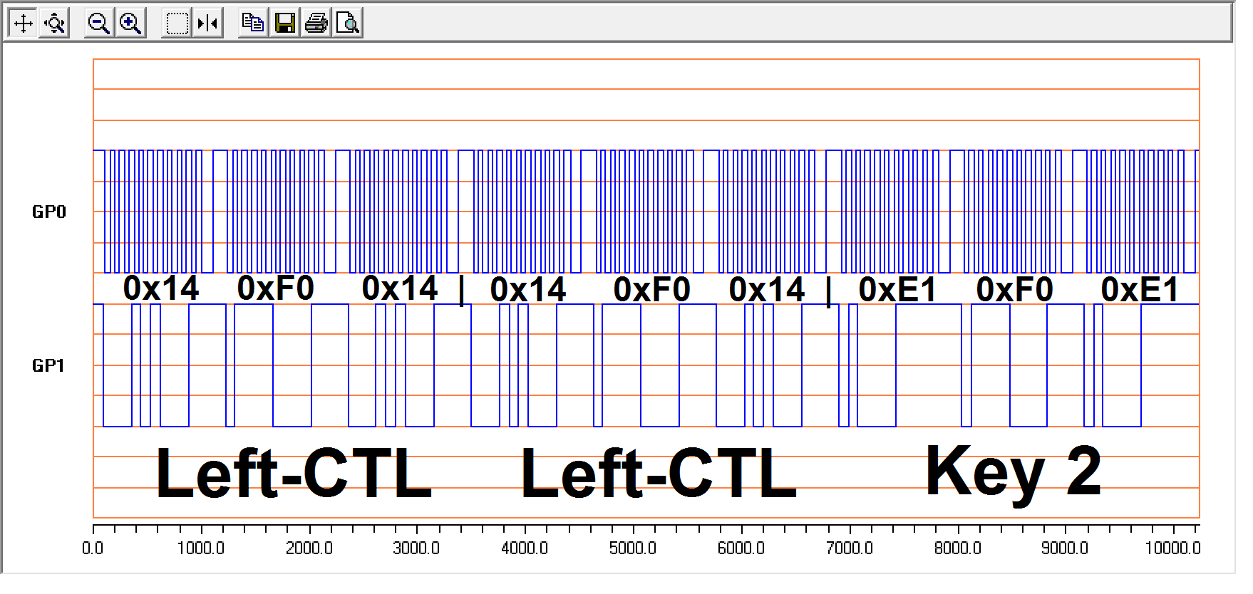

EDIT:
By the way, this is what it looks like with the full command...
