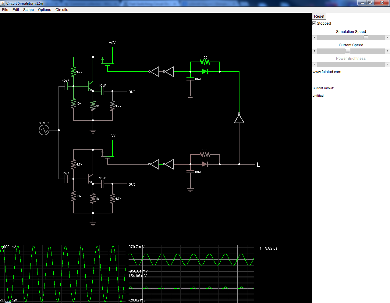

OK, I did some screwing around, tried to make a 1-of-2 signal selector using just BJTs, to more or less recreate the KVM. *CLICK THIS* for the simulation.
It doesn't work very well, murders your video signal, massive distortion. I don't see it as a workable KVM muxing/demuxing circuit, but you get the idea. Here is a screen shot right after a switch over. The scope view is what is on video out. The waveform on the left half is with "Video 1 In" selected, and the waveform on the right is "Video 2 In" selected...
I might be able to do better if I knew the exact circuit/schematic for the video section of the KVM. But the only other way I think they could do it is if they used the BJTs as shunts, to short the signal out rather than pass it through. But that is even worse than the above method I would think.
Edit: I suppose they could also be using them as amps, and just removing the bias or something to redirect the signal.

Like I said, if I had the exact schematic, I would know for sure what they did to switch the signal. I'm 80-90% positive the business end of the channel selection circuit is all the transistors near the VGA ports, and probably some stuff on the back side of the board. Their arrangement is a dead giveaway. Probably crude common emitter amplifiers, either unity gain or a very small gain to keep nonlinear amplification noise to a minimum.
EDIT: Probably *NOT* common emitter amp, I got mixed up. More likely common COLLECTOR follower if anything. Could also be common base amp.

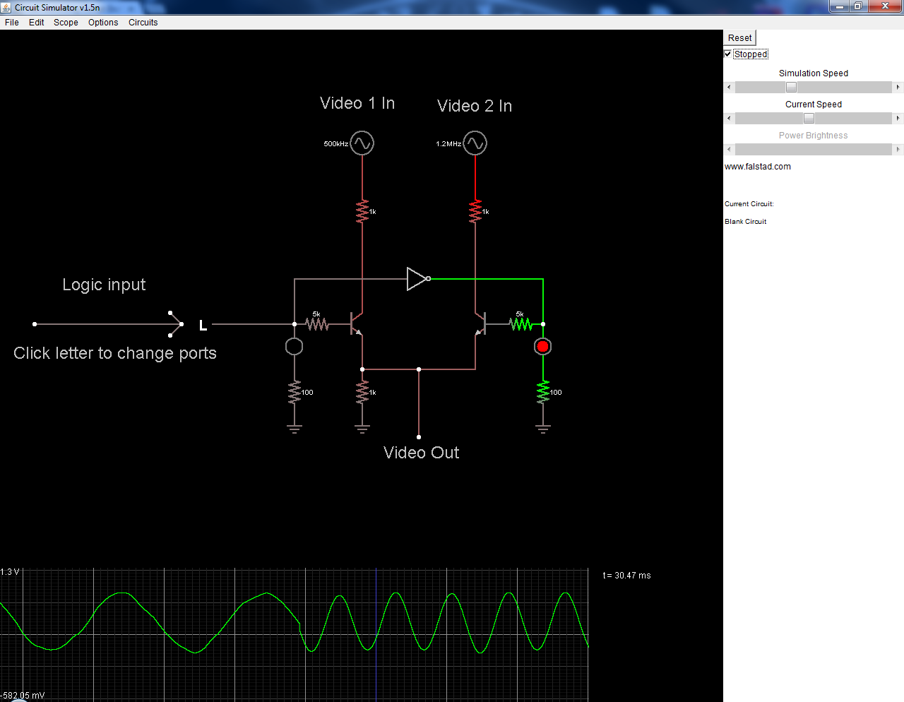

OK, I made a circuit that I think is possibly workable. *HERE* is a simulation of it. And here is an image...
I used common collector buffers that can be enabled or disabled by switching the power to them on or off, and thus, turn on and off that particular buffers output. Then I made inverter channel selection logic, some crude RC-diode based "break-before-make" logic, followed by some Schmitt trigger buffers. The biggest problem is that the channel that is supposed to be off has ~150mV of bleed through. I am currently thinking about ways to correct for this, but it is a minor problem when compared to the distortion that would be caused by other methods. Chances are if your display does not see a valid signal it will simply display black or something, but I can't be sure.
Finally, two very critical points.
(1) First, this is a very simple simulation, very rough draft. I have not validated it in a more accurate simulator. It's possible that a real simulation will expose bugs that indicate the whole design is impossible or highly impractical.
(2) And second, even if it does end up working well in a better, more accurate simulator, in the end it will all come down to whether or not we can use single/double layer PCB designing, or if it has to be some kind of super happy special fantastic PCB.
So there is no telling at this time if this circuit is truly workable for doing what you need or not.

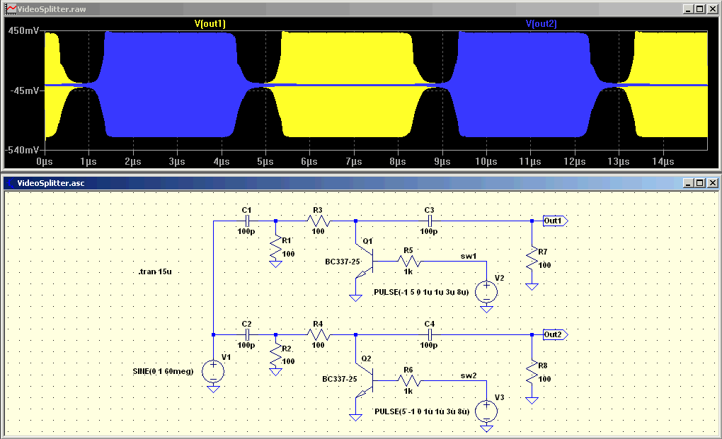

It may be that the KVM switches between signals by simply shunting the inactive one to ground, like this?
Hi Alec_t. I was hoping someone that knew what they were doing would jump in here and tell me how it is.
I had briefly considered a shunt topology, not long enough to try and figure exactly how though. I erroneously rejected the idea because it "felt icky". That was probably a mistake considering how well your way works, and that it uses about the right amount of parts. Given no better options, I would think that you more than likely have the correct answer to how his KVM works.
Is the output signal properly centered around ground? Looks like it is. My research suggests that this is a pretty critical parameter. The majority of the signal is positive, but special parts of the signal dip just below ground. I could see problems with this if the signal had even a small offset, but was otherwise reconstructed perfectly. But I could be wrong.
What do you think about layout requirements? Do you think either method can be done with just his PCB kit? Or do you think that this is going to have to be high end radio board design? I personally think he could possibly pull it off with the kit, *IF* all the connections are short and he uses the back side as a ground plane. But the signal he is working with is almost certainly in the low VHF range. So it probably needs to be treated fairly well.
In the sim a sine input gives an output centred around ground (within 8mV). The asc file is attached if you want to play.
Don't know what the PCB kit is or the OP's abilities are. Layout would clearly matter at video frequencies. I've little experience there.
