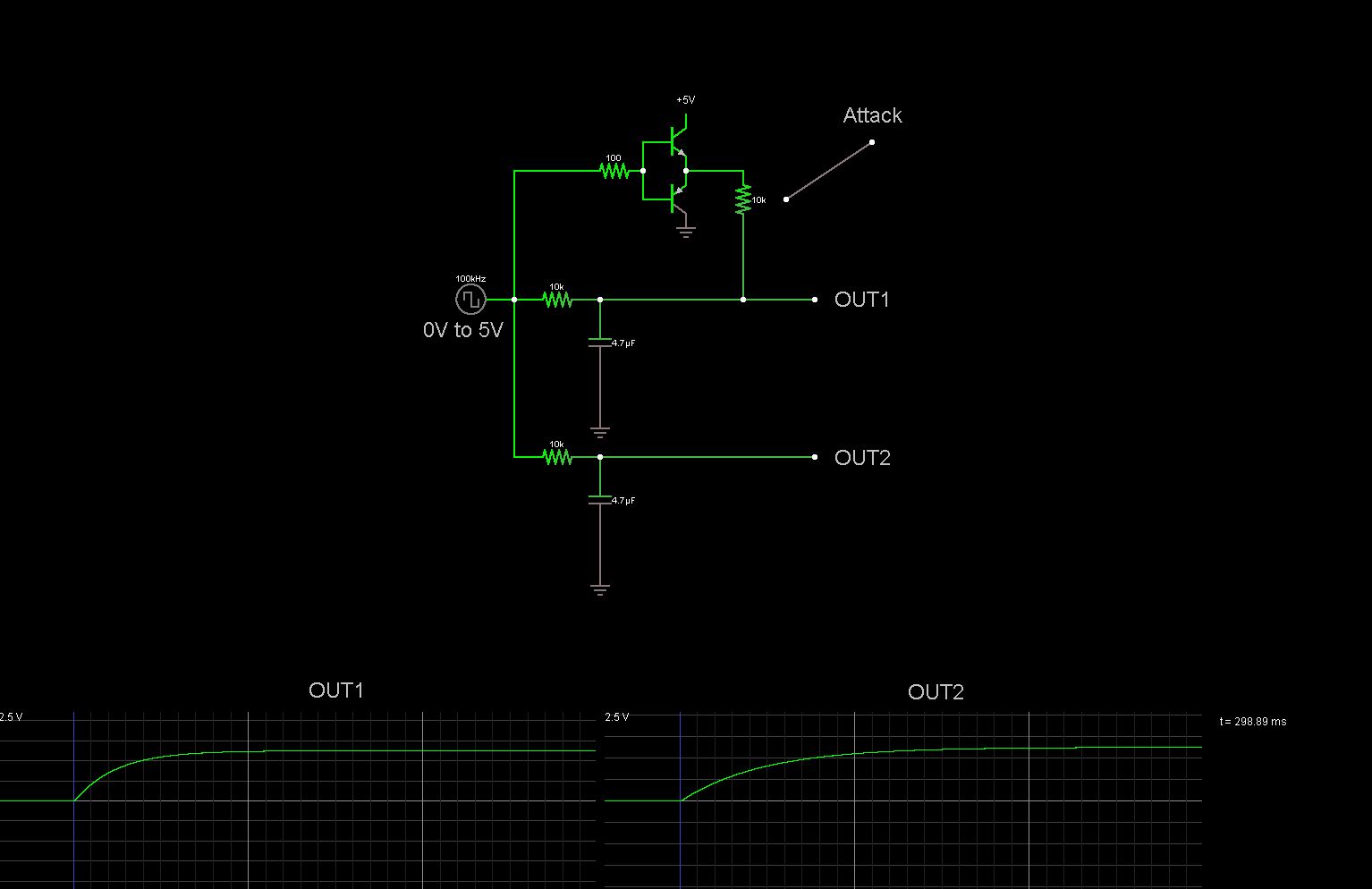

You could look at the "delta" between the output of the low pass filter and your "raw" signal and based on the amount of error between the two, proportionally update the low pass filter output node. At this point though, it's not exactly a low pass filter anymore.
The circuit I am thinking of in addition to the low pass filter is a push-pull drive commonly used to drive a capacitive load of a MOSFET gate.

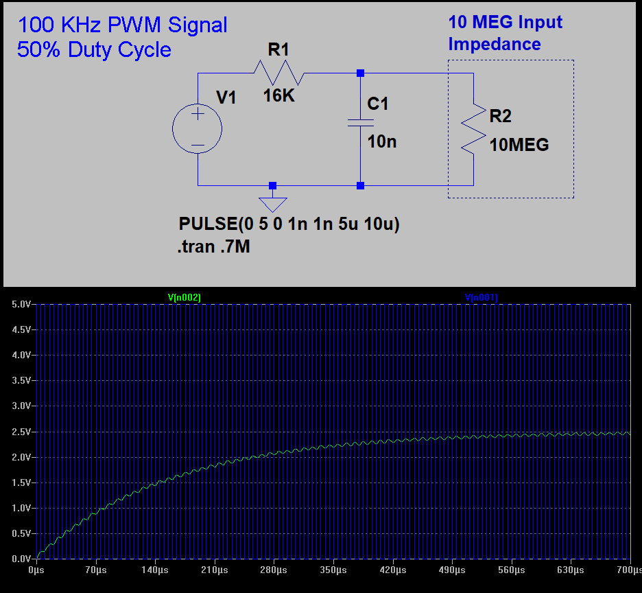

I doubt you will achieve that. The reason being is the RC time constant involved. You mention a low pass frequency of about 10 KHz.
The above image illustrates a 100 KHz 5.0 Volt PWM signal with a 50% duty cycle. The 100 KHZ has a period of 10 uSec. Note the time it takes for the capacitor to charge to 2.5 volts. You will not get an instant change. Also keep in mind a LP filter is not going to supply very much current depending on your application. In the example the load is 10 Meg Ohm. Think about the RC time constants and how many it takes to charge the capacitor.
Ron

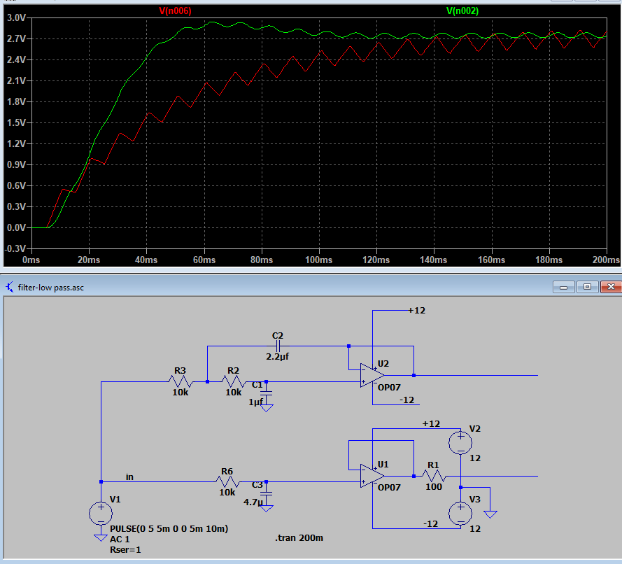

Here I made two filters. The bottom one is a simple RC filter with a op-amp buffer after it. (high ripple voltage) The top one is a second order filter with a small amount of over shoot. (using 10khz foing from 0% to 50%)
If we moved the PWM frequency to 100khz the p-p ripple voltage will be 1/10 as much. Or we could reduce the delay through the filter. Or we could a combination of less ripple and less delay.
Having done this many times, the "over shoot" can help with some of the mechanical delays in the system. I can make it over shoot any amount you want.

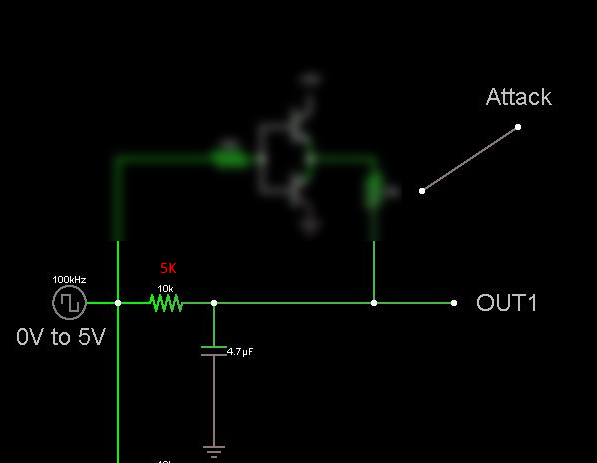

You can get similar results to post #11 and #12 with what I was describing in post #7 ... by adjusting the "Attack" resistor you can affect the filter response time.

" The attack resistor is the same as picking a different "10k" resistor " - Not exactly ... the transistors provide an active circuit that provides low impedance when OUT1 does not match the 0V to 5V input and a high impedance when they agree with one another.
Speed up the frequency by 10:1. Did not change the filter.

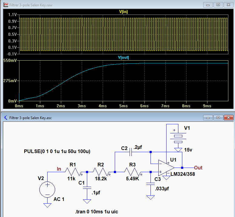

A 3-pole filter can improve the ripple to rise-time ratio.
For example, below is the sim for a 125Hz 3-pole filter with a 10KHz PWM signal:
