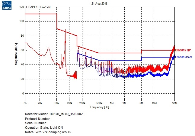

We recently took our 60W Offine , isolated, PFC’d Flyback LED driver (schematic attached) for Conducted and Radiated EMC scans.
The conducted EMC scan fails at a few spot frequencies as the attached shows.

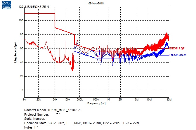

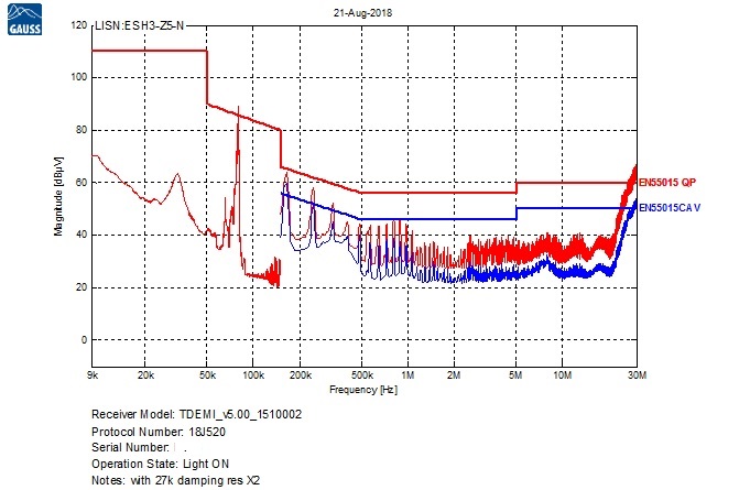

Thanks, ...In the meantime, we did another quick Conducted EMC scan, this time with the attached EMC filter. This performed much worse than the first EMC filter (shown in the top post). This worse conducted EMC scan (on 8th November) is also shown attached here. (the better scan of 22nd August is also attached here, for ease of reference)
We believe that the worsening is due to the fact that we no longer have a Y capacitor from primary to secondary of the 500mW bias supply transformer. We also believe that the change to using Radial Y capacitors in the AC part of the filter, as opposed to SMD ones as used in the previous scan, has also had an impact. –This being due to the increased stray inductance of the radial Y capacitors.
Also, in the worse scan, our LED load was sitting on a much bigger heatsink. Also, in the worse scan, the Power NFET was screwed to a bigger metal heatsink. (the tab of the FET being the switching node means that this made EMC worse).
So do you agree that we need to have Y capacitors between primary and secondary of both transformers in order to improve things?
I have also attached the (better) previous scan of 22nd August here. (Also the EMC filter schematic is also atttached)
