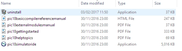

Hi E,
I didn't know about clearing variables, I'll try to remember to tick the box, Thanks.
My version doesn't show 'Initialise variable under the OPTIONS drop down?
C.
hi C,
Look in Program File/Oshonsoft, compare the file dates and sizes, see if they are the same as mine, ref image.
E
