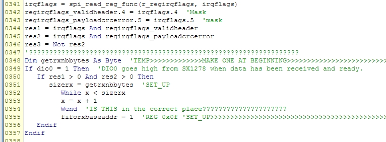

I'm programming a PIC that will control an SX1278 radio module.
I've come to a section where I read a BYTE then compare the BITs, see attached.
How do I do this please?
Camerart.

hi C,
You use the Bits location in a WORD or BYTE.
eg:
Dim Cam as Byte
say Cam Byte = 40h, 01000000 [ B7 thru B0, Bit7 is the Most Significant Bit]]
The '1' is at B6
so to test use Cam.6
If Cam.6 = 1 then
'do something
else
'do some thing else
endif
A WORD has Bits 15 thru B0.
Ok.??
Eric

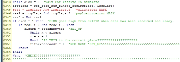

Hi E,
Does this look ok to you.
There are comments, I haven't got to yet, so only above the ??????????????????????????????????????
EDIT: read with image at #1
C.

hi C,
You are making the coding too verbose, trim it down a bit.
E
res1 =irqflags And irgflags.4
Note that res1 after the AND, res1 will '00010000' is this what you really want.?
Do you need an OR function ????
E

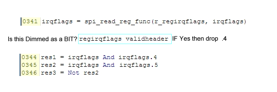

Hi E,
I'm copying from notes I've been given, here's a section:
if ((irqFlags & IrqFlags_ValidHeader) AND (NOT(irqFlags & IrqFlags_PayloadCrcError))) {
sizerx = SPIRead(RxNbBytes())
I asked about the & and AND in another thread, earlier. Oshonsoft requires the &ANDs to be done separately.
C
The program won't compile with this section:
EDIT:I'm guessing, from reading the code, that the IRQFLAGS byte is READ, and if there is a VALIDHEADER BIT AND there is NOT a PAYLOADCRCERROR BIT then OK. (I'm not certain though!)
C

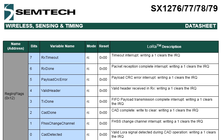

C, the way I read the other code, is that you check for valid header = 1, and check that the CRC flag is = 0
In simple terms, I would simply make a compound if/then/else. Like: (this example compiles ok). If any "IF" condition fails, it falls through to the "ENDIF" and "LOOP:"
Dim irqflags As Byte
'Read irqflags, but I set to zero for example
irqflags = 0
main:
If irqflags.4 = 1 Then
If irqflags.5 = 0 Then
'do the reading code
'rxsize = ....
'goto loop
Endif
Endif
loop:
Goto main
End
You could check other flags as well, if necessary. Just keep building another "IF" in the chain until all necessary conditions are met, then read the data. I would check the RXDone (bit 6) as well, to be sure. I don't see why one would need extra variables and lots of "OR" or "AND" commands, simply check the condition of the result byte bit by bit.
Bit testing is either a 1 or 0 result, no need for ">" type of testing. It is either =0 or =1

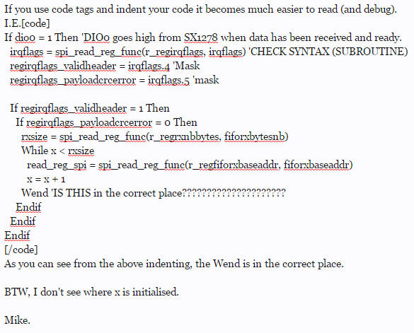

If you use code tags and indent your code it becomes much easier to read (and debug).
I.E.
If dio0 = 1 Then 'DIO0 goes high from SX1278 when data has been received and ready.
  irqflags = spi_read_reg_func(r_regirqflags, irqflags) 'CHECK SYNTAX (SUBROUTINE)
  regirqflags_validheader = irqflags.4 'Mask
  regirqflags_payloadcrcerror = irqflags.5 'mask
  If regirqflags_validheader = 1 Then
    If regirqflags_payloadcrcerror = 0 Then
      rxsize = spi_read_reg_func(r_regrxnbbytes, fiforxbytesnb)
      While x < rxsize
        read_reg_spi = spi_read_reg_func(r_regfiforxbaseaddr, fiforxbaseaddr)
        x = x + 1
      Wend 'IS THIS in the correct place?????????????????????
    Endif
  Endif
Endif
As you can see from the above indenting, the Wend is in the correct place.
BTW, I don't see where x is initialised.
I.E.
      While x < rxsize
        x = x + 1
    Endif
  Endif
Endif

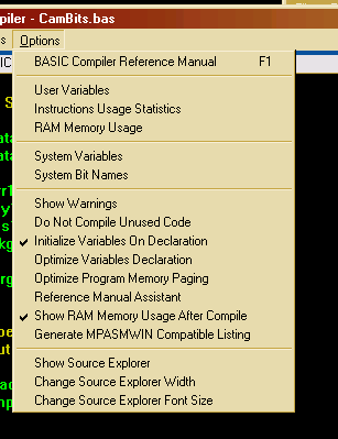

hi C,
If want to avoid initialising 'simple' variables to zero within your program, tick the menu option.
I always prefer code initialising.
E
