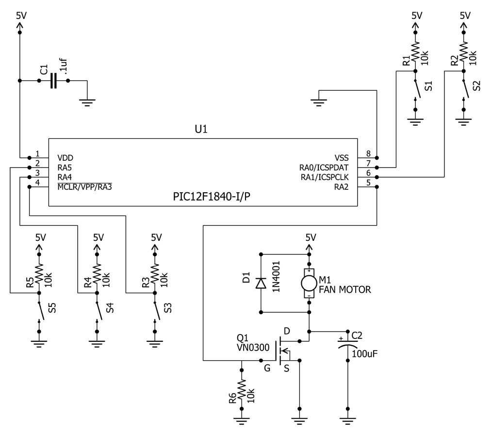

Here is the schematic that I came up with, simple as it is. Five switches control the fan - off, 25%, 50%, 75% and 100%.

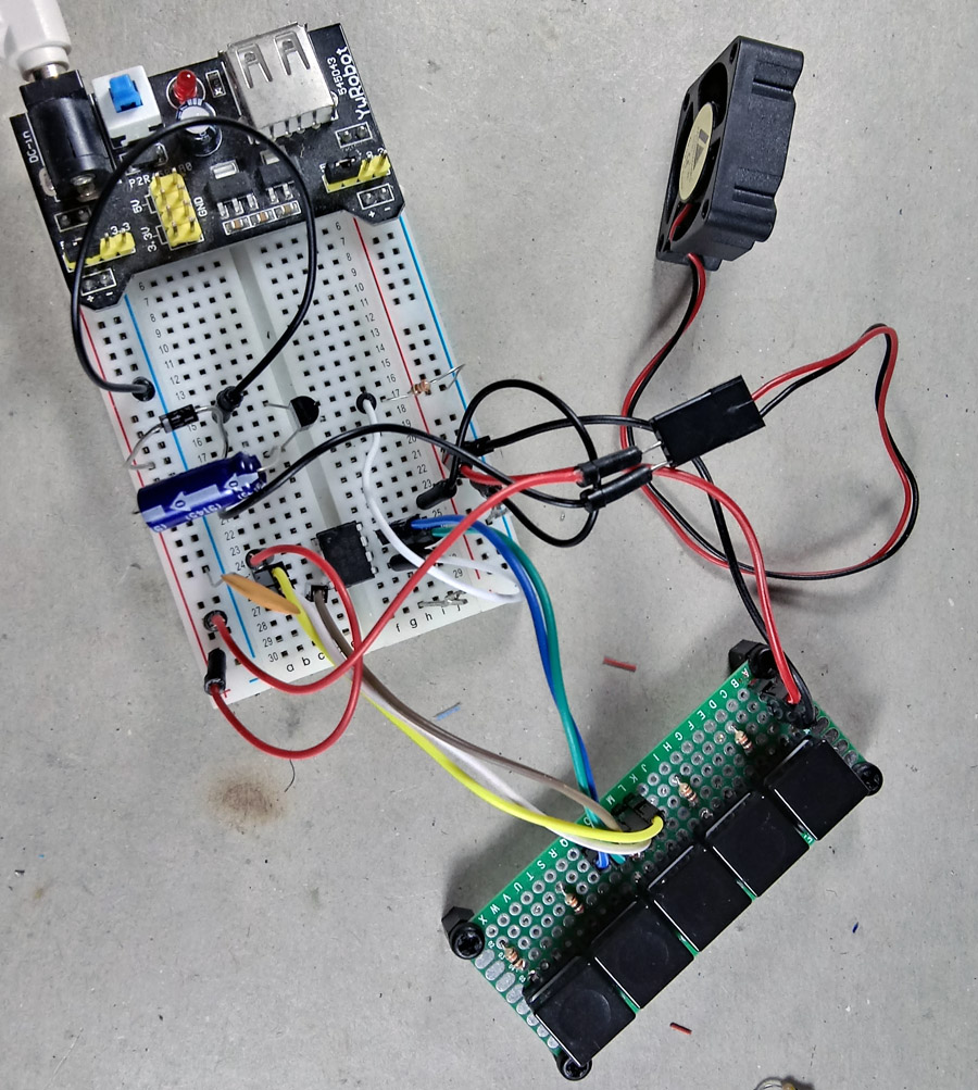

Then the asm code (see attached) and the bread-board circuit

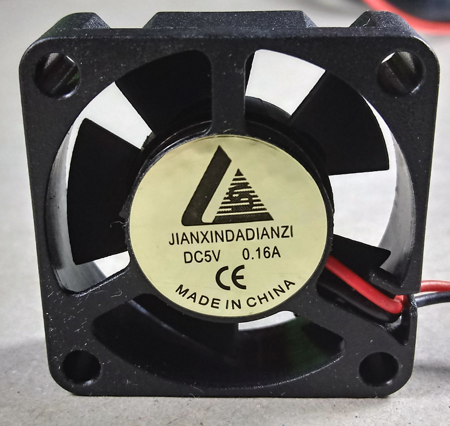

The fan that I used is *very* small, and very cheap, but actually performs well.
119622
The circuit and program work great! No whine, no stalling at 25%, it performs as well as I hoped that it would. Just a couple of notes...C2 is mandatory and a larger value might be needed for another fan. I did not use a serial resistor on the gate of the mosfet - I saw no difference if I added one. I still struggle a bit with determining when one is necessary. R6 is a habit with me, I like things pulled down if the thing could be floating. Also, there is a lot to using PWM with fans - read about that if you are interested.
On the code - it's pretty straightforward. I am using a 10K duty cycle (if I calculated correctly). There is a trade-off between PWM resolution and PWM duty cycle as I recall - so don't think that you can get ultrasonic frequencies with 10 bit resolution. Anyways, I am sure there are plenty of people on here who know much more about the details and there is much information on the subject available online (some of it quite good and some of it just plain wrong). While the data sheet can be cumbersome, especially if you are not familiar with Microchip, all the info is actually in there.

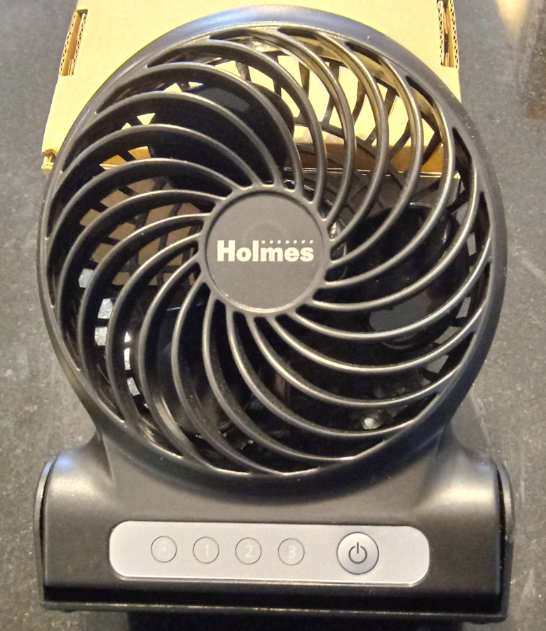

Then, I come across this in a brick and mortar store - can't remember exactly, but I think it was maybe $8.
119625
Has a built-in rechargeable battery. Can be charged from a USB port or charger. Runs while charging and works fine off of a 5V power bank when I have forgotten to charge it. Runs for a couple of hours on a full charge. Plenty effective for directing the fumes away from me while soldering. It is small enough (5.5" X 4") to easily position while soldering. Three speeds and the highest is effective even at a distance that is far enough to be well out of the way.
I simply can't do better than that.
I'm a bit dubious about the need for C2?, never mind 'mandatory', and 100uF already seems massively excessive?. If the fan perhaps one that can't be PWM'd?
However, R6, no problem - that SHOULD be mandatory :D
Just ordered some boards from China, on which I'm using 2N7000 FET's - I obviously added 'R6' (but 1M), and added a series resistor (10K) - like you, don't know if it was needed or not, but it won't do any harm , and could easily be replaced by a 'bit of wire'.

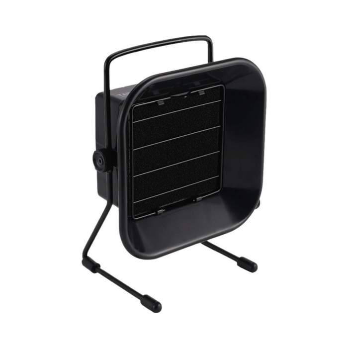

I use a fume extractor as well. Saves me some headaches once in awhile.
I have this one. Its really cheap. Works ok long as its close. Your fan honestly probably works better.

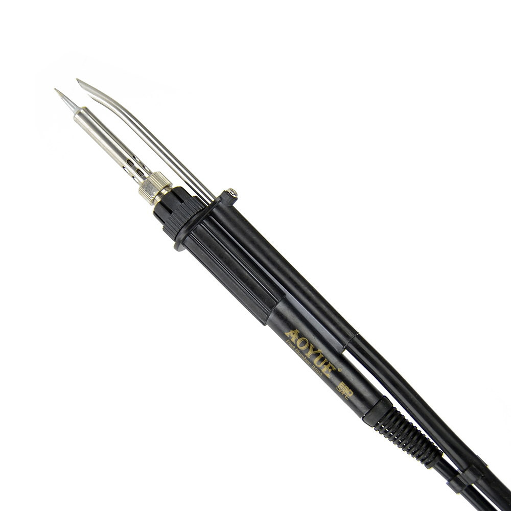

What works best for me tho is the extractor that is on the end of my soldering iron. My main station has it built in like below but I have been meaning to make another one for my secondary station just never get around to it. Its pretty simple to do and maybe you could make a fun project out of it.

Have you ever actually tried to make a tip extractor? I found it much more difficult since I can't seem to source any reasonably sized fans/pumps that can produce enough static pressure. I have found there are more than just solder fumes that bug me too...the flux solvent and cleaning vapours get to me and tip extraction doesn't work for those.
Mostly its the flux fumes that get me and these tip extractors work very well for it. Biggest issue is you need to keep it close to tip and you need to regularly clean the nozzle from the build up inside.
I have not tried to make one no. I have seen a few different styles done and it does not look hard to do.
You raise some good points and I am very open to discussing and learning more.
I chose the word "mandatory" in a deliberate fashion. In my example, on my bench, without C2, the fan will not turn below 100% duty cycle. Additionally, a small capacitor (say 10 uF, for example) would not change that outcome.
Using a larger fan (also 5v, specs here), it would turn at different duty cycles, but always with a distinctive whine. Adding a 220 uf capacitor, greatly reduced that hum, but did not completely removed it. Lower values were proportionally less effective. I looked into raising the duty cycle but, as I said, there are limits there and trade-offs with resolution. I agree with your "massively excessive" evaluation - it seemed that way to me as well
This is empirical for me. I do not know enough about motors and I am ok with admitting that but it does not mean I am comfortable with that.
I wish I had saved all of the reference and links that I went through with just this issue, but I have not.
Here are some that I easily brought back to memory:
There was a stackexchange thread where some one explained why a high value capacitor would work and I can't find it but I know I read it as it what led me to start trying "big caps"
I also note this "If the fan perhaps one that can't be PWM'd?" I came accross this language also. We all know that there are many examples of 12V PC fans that can/do use PWM. Further, if adding the cap (as in my case) makes PWM work, does it mean it can be PWM'd or does it mean using one will accelerate motor failure? I don't know, I would like to know, but I don't clearly understand.
Presumably adding the capacitor works as some kind of crude filter, so giving 'more' of a DC level across the motor?.
But it's rather crude and nasty, as is obvious the FET is shorting the capacitor to ground every time it turns ON.
Have you tried the capacitor directly across the motor? - I'd be much happier with that scenario, and it should be much more effective.
I have and I see no difference at all.
To be clear, a 4.7uf will "work" but will not start the fan at lower duty cycles. If you start at 100%, the fan will then continue to run at lower duty cycles. A 100 uf cap will start and run the fan at all of the switch-selectable. Changing the position from what you see in the schematic and picture to across the fan leads makes no difference.
EDIT: This is the thread that I read to try a large cap.
Just a total guess here. Is it possable that your desired fan speed, from the PWM output, is to low to overcome the starting(stalled motor) current? Since your using a micro to generate the PWM, couldn't you program a "ramp down from full PWM" in to it?
Yeah, well it sure sounds that way to me - not getting to the starting current. To summarize:
With El cheapo motor in the pic:
No cap, only works at 100% duty cycle. Starting at 100% and going lower (75,50,25) will stall. Will not start at 75,50,25.
Adding a 4.7u cap (cheap electrolytic) Will start at 100, but not below. If started at 100, will continue at lower.
Adding a 100 uf cap, will start at all duty cycles (sometimes takes a sec or so at 25) and will readily go back and forth without stalls.
Not a whole lot of hum or vibration as long as it is not stalled.
_____
Using the second fan (I linked the specs in #8) there is no stalling without the cap, but there is hum or whine at < 100% (and the pitch changes slightly at different duty cycles). A 200uf (or was it 220?) almost completely removes the hum. Using a 100uf reduces the hum, but not as much.
I may try lowering the PWM period to 100Hz with that one.
Thing is, for soldering, I have solved the issue with the little commercial fan so I want to pack it and stash it...still, I would like to know more. There is always more to this stuff...it never stops, you people with the motors...you start them and you stop them...what's the problem? :):):)
