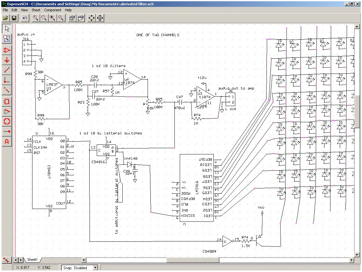

Eqlizer circuit for review and suggestions
MrDEB
this is ONLY one channel, ONE of ten filters and ONE of 10
bi-lateral switches.
A version of the Vellman equalizer circuit.
the diode/capacitor feeding the lm3916 acts as a peak detector for the display
the 4017 cycles the bi lateral switches acting as a multiplexer.
Any comments welcome
NOTE this is an abreviated version of entire circuit
Don't know why but click on the pic then left click the magnifyer to define the gif pic.

This equalizer adjusts of the level of a band of frequencies down to zero. Equalizers usually adjust the amount of boost and cut equally because their adjustment pot is in the feedback loop of an opamp.
The signal feeding the bi-lateral switch is zero volts because it is the virtual ground input of the following opamp.
The filter should feed an RC peak detector that should feed the bi-lateral switch.
The input of the LM3916 needs a resistor (1M) to ground.
The LEDs will be extremely dim because the average current in each will be divided by 10 due to the multiplexing.
If your project was in a single topic then things will be easier to find such as the original Velleman circuit and the Oriental display project.
Maybe connect BEFORE the pot?
I take it the diode/capacitor won't do the deed? Maybe insert the diode/capacitor before the bi-latteral switch? I contemplated this approach.
Reason??
I kinda copied the oriental circuit in combination with the Vellman circuit (the 2067 no longer available) so I am using a lm3916. not real sure it will work but you may be right on tooo dim.
any suggestions?

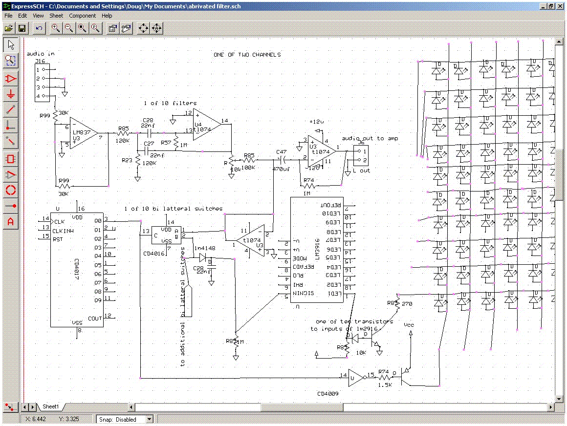

The filter's level control should feed the audio output opamp plus feed a buffer opamp that feeds the peak detector diode. Before the pot won't show changes to the response made by the equalizer.
Yes, the diode-capacitor peak detector should be fed from a buffer opamp so that the peak detector doesn't cause distortion. The bi-lateral switch needs to route the level from each peak detector to the LM3916 one-at-a-time, not having then all paralelled together.
Reason??
The input of an LM391x is a PNP transistor that floats high if the input doesn't have a 1M resistor as a pull-down.
The Velleman circuit has a powerful transistor driving both ends of the LEDs.
Add a transistor to each output of the LM3916.
circuit revisions
here are the revisions suggested.
The peak detector circuit is basically cycled via the 4017?
hope this is what you are refering to in last post?
as to revising the possible grounding of the op amps input--would adding a 1K resistor to ground do the deed in series with the pot?
The new U3 opamp in the center of the schematic (please number parts separately) is an inverter with an extremely low input impedance and it is connected where there is no signal voltage. It needs to be a high input impedance buffer and its input can be the slider of the pot or the output of the filter.
The peak detector must be driven from the output of U3. The output of the bi-lateral switch feeds the input of the LM3916.
The new transistor is turned off by the LM3916 when the LEDs must light so it won't work. I think you have plenty of supply voltage so the new transistor can be a PNP emitter-follower. It will need a pullup resistor from base to emitter to turn it off.
Add on the schematic a note where all the filters' 100k resistors from their volume controls connect to the input of the output opamp, and where the outputs of all the bi-lateral switches feed the input of the LM3916.

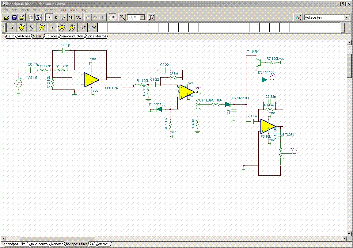

peak detector revisions
I think I solved the filter output problem of zero voltage.
I added a resistor in series w/ pot(R4) and added transistor circuit to filter output.
added C4 as the circuit wouldn't work otherwise??
The T1/D3 output connected to bi-lateral circuit.
The peak detector will take all day to charge. It is supposed to be fed from the low impedance output of an opamp so it can charge the capacitor very quickly, not fed from a 100k resistor.
The output opamp does not receive audio anymore. It receives DC instead.
D1 and R6 are not needed.

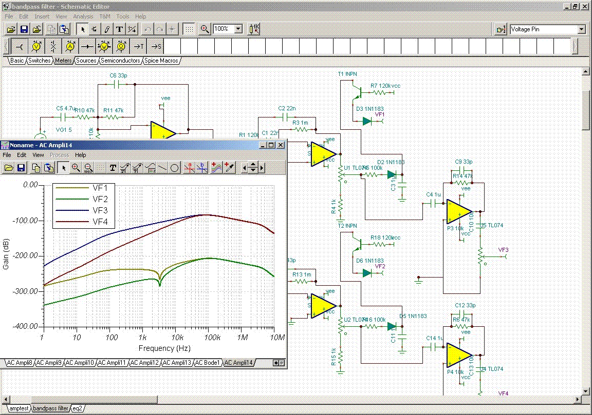

changed input to op amp etc
took care of the dc issue and moved the input of output stage so 100k resistor no longer feeding.
I really appreciate all your input
I think the glitch is showing that the peak detector is working?
No.
the peak detector diode needs to be fed from the low output resistance of a new buffer opamp so the capacitor charges very quickly, not from the 100k resistor and pot that take a long time to charge it.

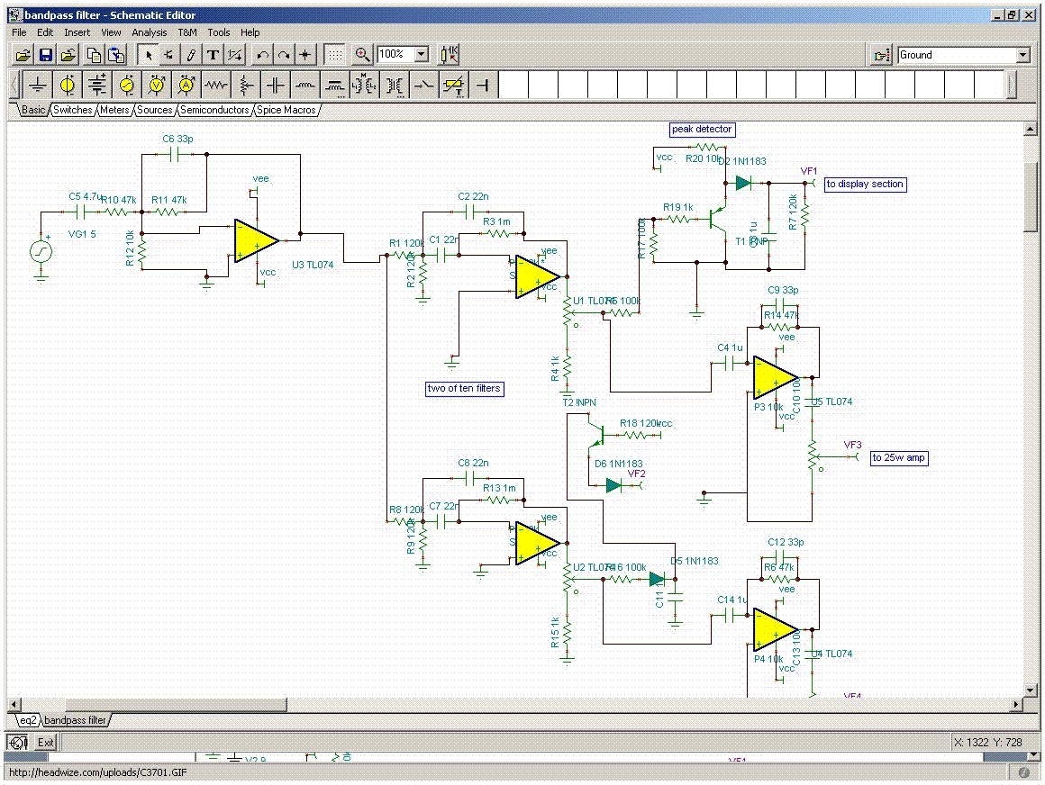

lets try again
attached pic
do you have TINA? I can send you the compressed file as well?
  • bandpass filter11.zip
I don't use Tina.
I saw the peak detector in the LM3915 datasheet.
I think it should be fed from the very low output resistance of an opamp, not from the high resistance of the level control plus 100k. The transistor will cause distortion in the audio when its base voltage is driven below -0.7V.
I sketched a peak detector that is similar and uses an opamp as a high input resistance buffer.
