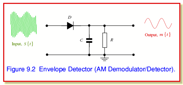

Hi everyone,
I'm thinking of using an envelope detector in order to detect the presense of a 200Khz waveform. When an envelope detector is used for the task which it was originally designed for, you feed in an AC signal which has been modulated with a much higher frequency waveform, and the envelope detector then strips away the high frequency part leaving just the original AC signal as in the attached diagram.
However, all I want to do is detect the presense of a 200Khz AC signal. If I were to feed a standard sine-wave 200Khz signal which hasn't been used as a carrier into an envelope detector, am I correct in thinking that I would get a DC-level output directly related to the amplitude of the original 200khz waveform?
Any thoughts on this?
Brian

Yes, it's simply an AM detector - or more simply, a rectifier. You input AC to a rectifier and you get DC out - this is no different.
Personally I think you are making it sound FAR more complicted than it is by calling it an 'envelope detector' :lol:

Rectifier or Envelope detector - all depends on how you use it, but yes, it's the same circuit.
If you're trying to detect a certain frequency, you could run your signal through a high-Q bandpass filter before rectifying it, and then use some sort of comparator to see if there's a decent voltage level at your rectifier output. That seems like it would detect a certain frequency for you. I don't know what other kinds of signals you must differentiate from though.
Another idea would be a simple mixer in line with a low-pass filter, but you would need a 200kHz local oscillator. And the mixer would probably attenuate your signal a lot, not sure though.
Hope that helps you out.
Part of my design does incorporate filters before this rectifying stage, but that's mainly because the 200Khz signal has to be extracted from a 50HZ mains AC waveform before it can be processed. By the time it reaches this rectification stage, all I really need to be able to do is detect is the presense or absense of the waveform and provide this information, in TTL form, to a microcontroller. I don't need to maintain accurate reproduction of the 200Khz signal, I only need to be able to detect the presense of it.

The crude AM detector scheme isn't likely to perform terribly well, and the FM suggested probably wasn't what was really intended?. The usual method is to use FSK (Frequency Shift Keying), where you transmit one frequency for HIGH and another for LOW, and you use an NE567 PLL tone decoder (or similar) to restore the digital signal at the receiver. This is simple, efficient, and reliable - the transmitter can be nothing more than a 555, and the receiver an NE567.

For this case a quick and dirty OOK (on - off keying) would work wonderfully. Instead of transmitting a square pulse simply transmit (for example) a few cycles of a 24khz sine wave for your 1s. And for your 0s you can simply do as you did before.
Now to receive this you can use that rectifier circuit you were thinking of (or envelope detector to us comm people). Simply rectify it and use a LM 311 comparator to clean up your waveform and convert it back to TTL levels.

No I'm not transmitting square waves over the mains, I'm transmitting pulses of 200khz which, via my filter stage which will later extract the 200khz pulses and a detector which will convert them to a DC level, I hope to "create" a square-wave type signal which I'll buffer so that the proper TTL logic levels are presented to the Microcontroller. So the transmission starts out as pulses of 200khz and finishes with logic 1s and logic 0s which depend on the presense or absense of the 200khz pulses.
If you're familiar with X10, this idea is extremely similar.
Brian
Oh then yes you're doing OOK just as I stated above. You're envelope detector will work nicely. All you need to do is choose your RC time constant significantly longer than that of the 1/200khz period. I'd say like the time constant should be 5-10 times longer than the period. I could give you a better estimate but I'm not certain if your signal is unipolar or bipolar.
Once you've done that use an LM 311 comparator (set up in TTL mode) to give you a very nice clean TTL signal that you're looking for.
