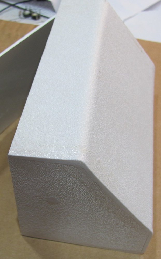

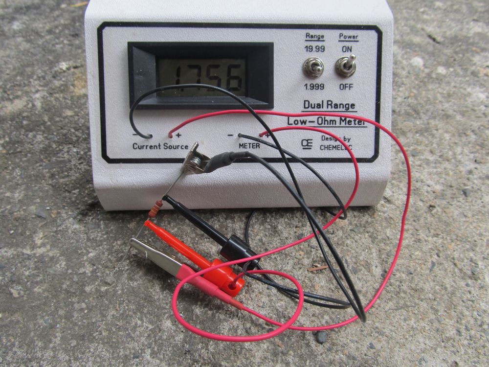

If you have access to ABS Sheet Plastic, You can Easily Fabricate Boxes of any size or Shape, also make them look quite professional. Here is an Example of one I Made.
To Cut the various Pieces to Size, Score it with a Razor Knife and Break it.
Than using MEK or Acetone, you can Glue (Melt) these pieces together.
Also possible to Bend it with a Hot Wire.

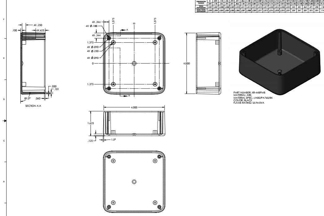

Polycase has a number of square and near square enclosures around 4"×4" - 5"×5".
An alternate is a laser-cut acrylic case, which is nice if you need cutouts for switches and so on.

The Thinner White ABS Plastic I have is about 2.3mm Thick and some is 2.5mm thick.

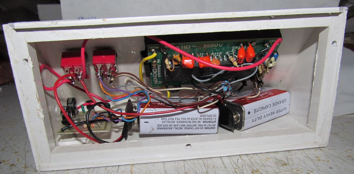

Here is a Picture of the Back Side, With the Back Removed.
The Decal on the front was Reverse Printed on Transparency Film, so the lettering Can't Rub Off.
This was just made for my Home Use, Not ment to be FANCY, But Reasonable Looking.

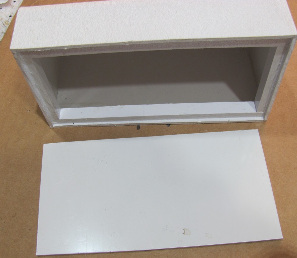

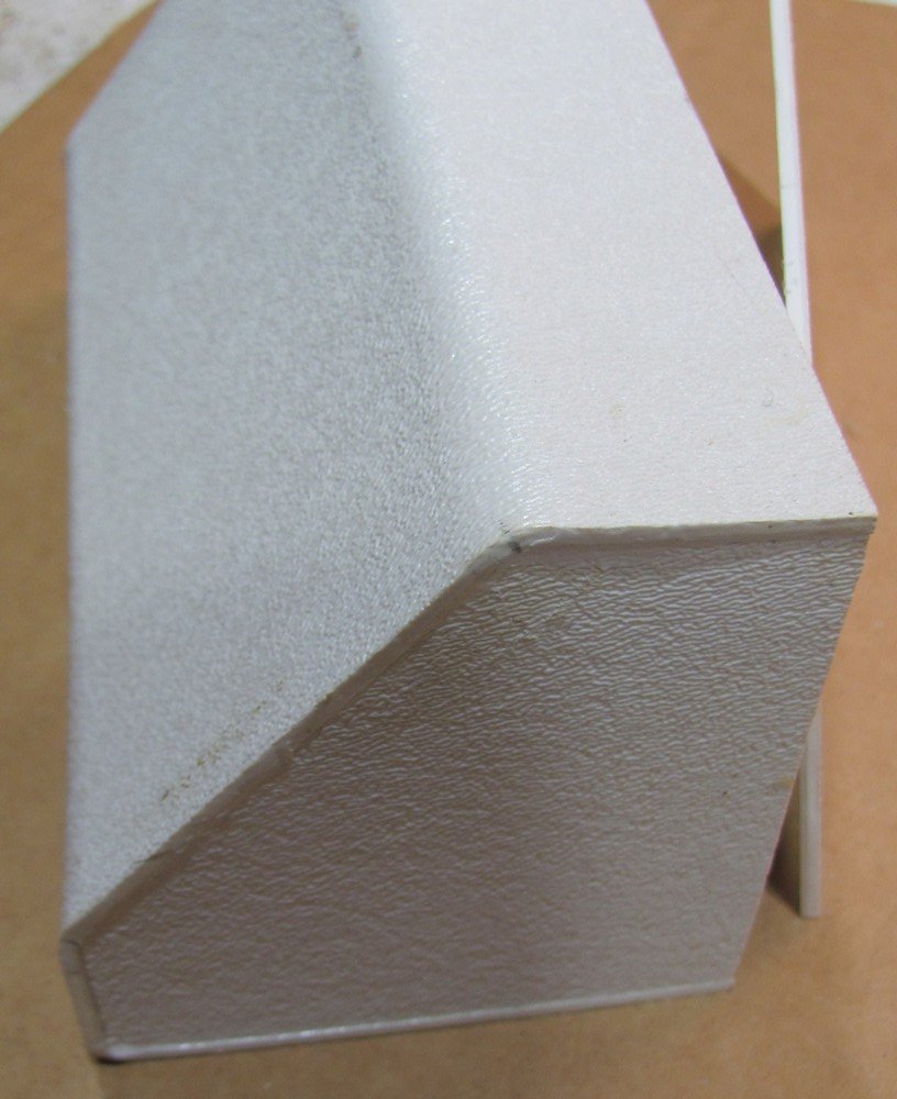

Here is another case I made, but never finished off.
One End Sanded and wiped with MEK to seal it, but cracks could also be filled a bit.
Other End Not Finished.
And a Rear View.
