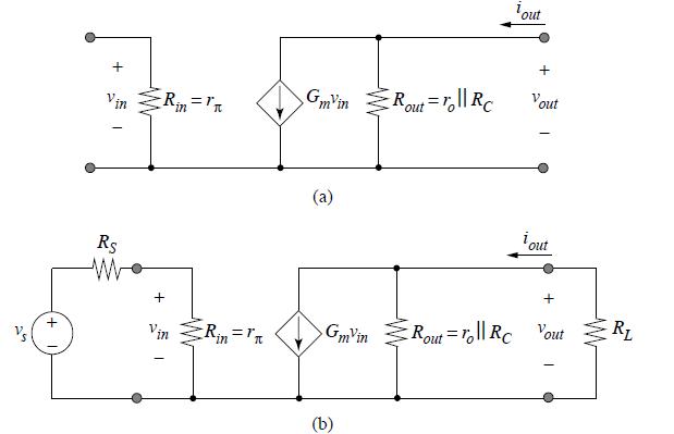

Please let me refer to RLoad as Rc (which is how its usually called).
Usually, Rload is the resistor which is DC coupled, so only the ac signal will reach it (RL in the attached image).
How did you conclude that the gain of a CE amplifer is RC / RE?
For the intrinsic amplifier (circuit 'a'), the gain is gm,
and for the loaded amplifier (circuit 'b'), if we assume impedance matching (Rout >> RL, Rin >> Rs), then the gain remains gm.
If you wonder how i concluded the gain of the intrinsic amplifier is gm, then when finding transcoductance gain, the output is shorted.

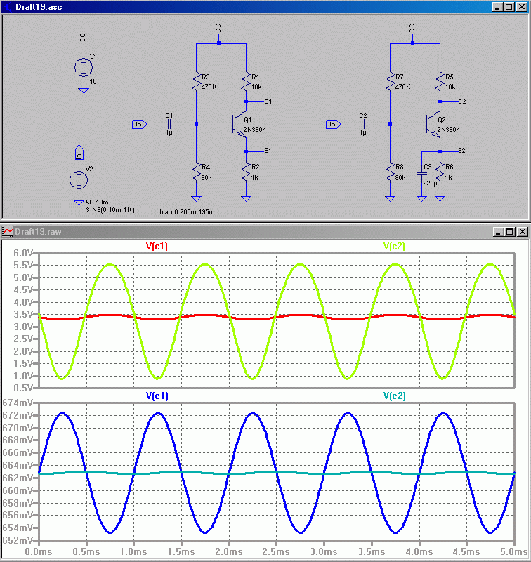

Look at my previous posting again.
Hey,
Thanks for the great simulation.
Lets focus please on the non-bypassed emitter circuit (the left one).
I estimate Vout (Vc1) to be 0.1V * sin(ωt), according to the graph.
Now:
vin = 10mV * sin(ωt).
iout = vout / Rc = [ 0.1V * sin(ωt) ] / 10kΩ = 0.01mV * sin(ωt).
(vin, iout and vout are small signals, ac signals only).
Therefore: Gm = iout / vin = 1mS (S = 1/Ω).
Thats the attenuation i was talking about.
Its interesting:
gm = IC / vth = [(VCC - VC) / RC] / 25mV = 26.4mS (I assumed T to be at room temperature, therefore vth ≈ 25mV).
gm*RE = 26.4 >> 1.
Therfore: Gm ≈ 1/RE = 1mS, which is exactly the result i received above.
