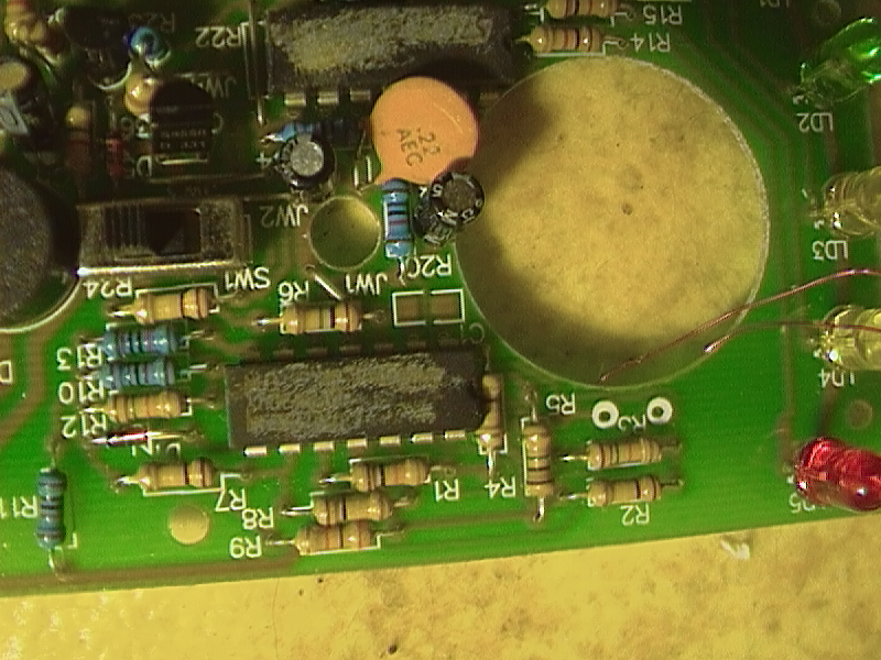

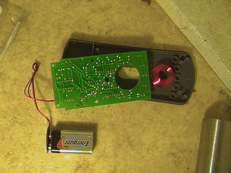

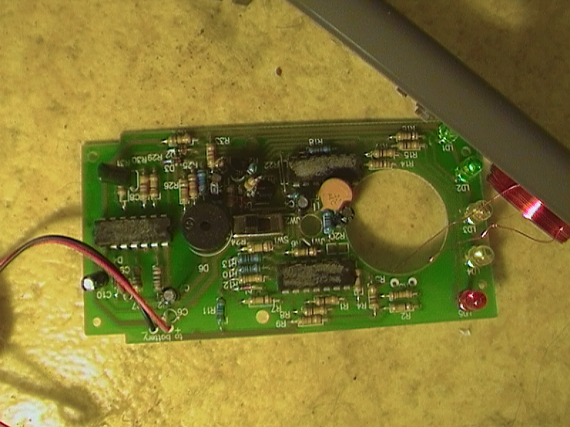

Here is a famous one made by Velleman. It's a very simple pcb, one layer only. could be very simple to reproduce BUT Those bastards drills the 3 UC !! so we can't see anything! It only shows that 2 Uc are ST electronics probably the same type (lm324??!) and the last one no idea. Here are pictures of this device ( cost around 40 usd ). It has 5 led to measure on-1-3-6-10 mg.

I did receive a K2 (rev4). I'm very disapointed. It's much less sensitive than the velleman emf ( the one above). and cost much more. It has no hall effect capteur, the coil is such a very simple 4 track printed on the board. it uses 3 npn transistor and 4 pnp (generic one: P100 and P200). besides that it use a lm324. So very simple very cheap and cost 60-50 usd !! defenitly go for the velleman with a real big coil not for this sh**.
