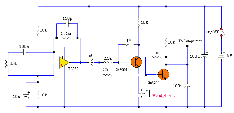

Regardless of usage, I built a meter that I would like to use to pick up low to medium-frequency electrical fields. I don't care what's creating the fields, be it 120V wires in the walls, the TV, ghosts, leprechauns, spy satellites, what have you. If there's a field, I want to be able to measure it.

Update: I built another amp circuit (basically the op-amp section in the schematic on page 1) and tried it with my "Coil from Hell" and a pair of headphones and my scope, and it works great. Picks up 60Hz like it's going out of style, and I even get a signal when I wave a magnet over the coil (LOW frequency response!). Sweet. I'll have to play with the gain to minimize the hum, or maybe add a 60Hz notch filter.
Which brings me to the next stage. I have the output of the op-amp going into 2 separate transistor amplifiers. One to drive the headphone jack and another to provide a signal for the comparator. The issue I'm having is an oscillation at around 3-4 KHz that seems to be brought on by/rides atop the 60Hz hum picked up by the coil. I took a .1uf capacitor and stuck it at various points in the circuit but had no luck suppressing this noise. Then I added a capacitor (100uf) to the output of the transistor amplifier circuit that will be providing the comparator input, since I want that to be a DC signal corresponding to signal strength, and then the entire circuit stopped picking up signals, and oscillated at a much lower frequency (click every couple seconds or so).
I'll have to sketch/post a schematic, but any suggestions off the top of your heads? The op-amp circuit alone works great, it's when I add the transistor stages that I run into the issue...
EDIT: I doctored up and attached a schematic (may not be exact, once again I'm at work and the circuit is at home).

1. When you disconnect the coil from ground, you turn it from being mostly a time varying magentic field transducer to an electric field transducer. From the schematic, it was originally intended to respond to magnetic fields.
2. Threading the coil through a ferrite toriod coil assures that it will not respond as a magnetic pickup. Wind it on an open core, or better yet, make it air core.

By the way, when making my earlier comment, I failed to notice that one end of the sense coil is bypassed to ground with a 100 uf capacitor. This would reduce the sensitivity to electric fields. Still, its a good idea to shield the inductor, leaving a small gap in the shield to prevent a shorted turn, in order to further reduce susceptibility to electric fields.

It seems that you have solved the gain problem. Good going. I don't know whether I had mentioned this in an earlier post, but you might find that shielding the loop will reduce the 60 Hz further. I found it to be beneficial on one project.
