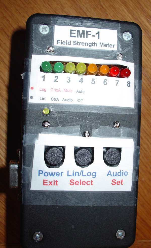

I do have the unit assembled, and it works, though it isn't perfect. One issue is that it doesn't respond well to low frequencies such as 60hz hum. I may redesign the input stage in phase 2. It also picks itself up to some degree, I added a shield between the boards and the coil inside the box which helps but it isn't perfect. Maybe that's why commercial EMF meters don't have microcontrollers in them. ;)
Yeah they're usually pretty basic analog devices, which belies their cost. I've never made one before so I don't know what the optimal number of turns would be, did you count how many you have on the coil you're using? I wouldn't buy 10 miles, yer not gonna get that much on an am loopstick core and you probably wouldn't wanna try anyways. Also give some thought to feeding the output of the amplifier stage into an audio amplifier so that you can hear it too, personally I don't think the little VU style meter is worth a damn. The human ear can pick out modulated EMF pretty well. Use the right coil and you can pick up passing cars, can just about guaruntee you'll pick up lightning from many miles away. ULF transmitions and sferics is a modest hobby for some folks, just don't call it a ghost hunter and people will take you a lot more seriously.
I forget how many turns I used, but it's well over 100. Maybe over 200. It was a pretty small doughnut I used though, if I used a ferrite stick I could get a lot more turns on it. As long as the stick is short enough to fit into the project box. I need to post new pics now that I have it stuffed in the box.
I guess it all boils down to... if it's in "antenna mode" (one end of coil floating), what length of wire is needed to pick up frequencies below 60hz. If it's in "coil mode" (one end of coil connected to circuit ground), then the amp would just pick up anything inducted in the coil by EM fields, and more turns = more gain. So far I haven't had much luck with picking anything up in "coil mode", but I'll play around on a breadboard socket and build another amp stage circuit so I can get to the bottom of it.
I do have a headphone jack so I can "listen" to the signals. That's how I know it isn't responding well to 60hz. I can hear it pretty loud in the headphones before the meter responds. It probably has something to do with the filter stage.
Basically, the unit consists of an op-amp input stage with a 4M7 feedback resistor, coupled via capacitor to an NPN transistor which further amplifies the signal. The bias on this transistor is adjustable via a trimpot, to get the optimum sensitivity without causing falses. The headphone jack comes off this transistor, and it is also fed to a RC filter circuit (w/another transistor) to convert the AC signal into a steady DC level to feed into the comparator stage. The comparator (another op-amp) has the filtered signal from the analog section going into one input, and a filtered PWM output from the uC on the other. The software in the uC uses successive approximation to determine the level of the signal and lights the LED display appropriately, and beeps an attached piezo speaker.
I did put the amplifier/filter section on a separate board from the uC so I can "upgrade" it with a better design down the road.

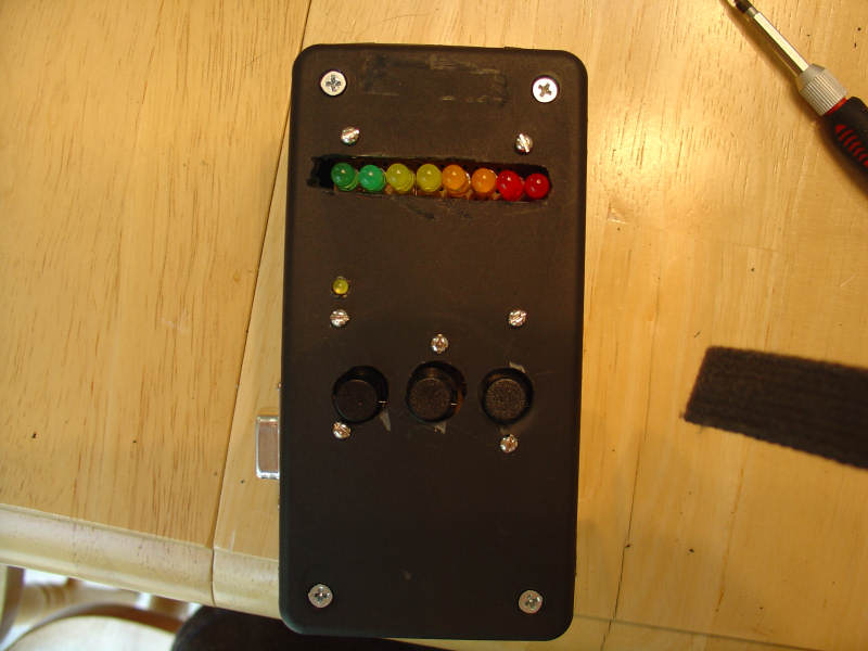

But, back to my project. No more ghost talk to rile up the skeptics. I attached pics so you guys can see the end result. Yes, messy I know, I'm not that good with a dremel, yet.
I'm also starting work on "Revision 2". I wound the "Coil from Hell" last night. Almost 400 feet of 30-gauge magnet wire on a ferrite core. The thing is almost an inch around. Some informal tests with an op-amp and a pair of headphones doesn't show much of a gain increase over the original circuit, but I am still working on the op-amp circuit. Sort of doing the "Op-amps for Complete Morons" google course at this point. ;) My goal is get it to have good gain down to a few hertz.
