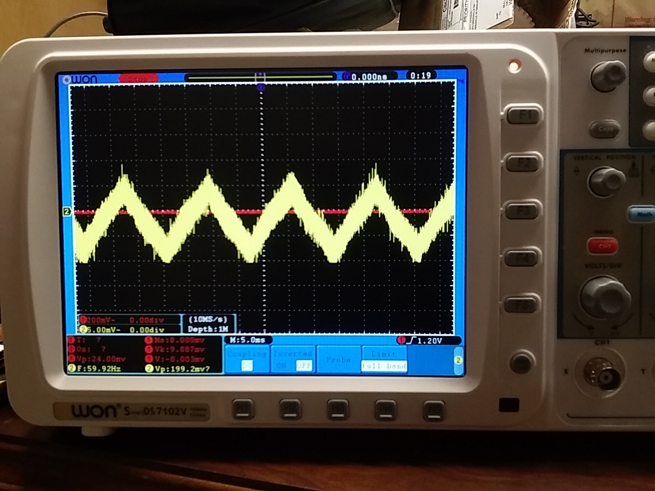

Well, here is where I am. I got a piezo transducer working as a trigger but it appears, as was suspected, noise and response will be tricky. I need a little help understanding a few things here. The noise you see on the yellow CH2 is 60hz but not sinusoidal. I need to look at the scope more but I noticed my setting of 5mv/div showing about 19mv pk-pk but the Vp measurement below is showing 199mv. Not sure on that one just yet.
Any thoughts or ideas how to proceed?
I used 1/2" Copper coated grounding rod for this test. About 2ft long and 4ft apart. I am unable to get a resistance value because I have effectively created a capacitor so my meter will start at about 30ohms and climb on up to 3000 or so. I did not leave it to see if it would stabilize.

The source impedance of any signal voltage between the two rods cannot be measured by a meter as you tried but thanks for trying anyway.
As we suspected it looks like noise will be a problem.
How are you connecting the rods to the scope?
I think you will need a battery powered differential amplifier (instrumentation amplifier) placed physically between the rods so that the connecting cables are as short as possible and equal lengths.
The cables from the rods to the differential amplifier need to be screened cables (coaxial cable) with the screens connected to the scope earthy point. But the cable screens should be left unconnected at the rods.

I do not currently have an amplifier but looking for some recommendations on that as I need one for other things. We have used an audio amp in a pinch in the past.
By connecting things now, my only goal here was to review the noise levels knowing that it will be 10-100x worse with an amp. I need to get real on signal conditioning apparently.
Right now it is only connected with a pair of automotive jumper cables and back to the scope leads. Total length is about 15ft. Obviously my leads are not grounded if "earthy point" and "screens" are how you describe grounds.
I am sure I could reduce some of the noise but it is very obvious at 60hz. I made a quick Low pass RC filter to see if I could improve things. I used a 500ohm resistor and 1uf cap so I think that is about a 300hz filter. It cleaned things up a bit and reduced the stray voltage but still way beyond the signals I will need to see.
Alec - I was thinking the same thing on the seismic source that I continuous low freq device could sure help home in on things and filter everything else out. Right now I am using a hammer/plate method but research has proved it can work if you work the scope signals right.
You certainly need a good differential amplifier, but I don't think a simple low-pass filter is going to help you much. What I'd suggest is a notch filter, such as a bootstrapped twin-Tee, tuned to reject 60 Hz. From the looks of your scope waveform, it might be necessary to have notch filters to get rid of the 3rd and 5th harmonics, as well.
Low frequencies are better at penetrating ground than high frequencies.
If you used a vibration source of, say, 40Hz and a sharply tuned receiver, then the 60Hz noise and its harmonics might be less troublesome.
You will definitely need screened cables for your receiving electrodes.
