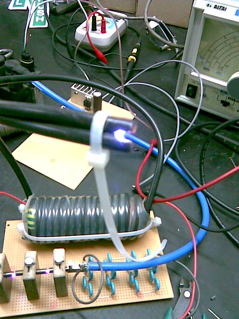

Heres the hf start circuit I put togther for my mobile weld set, the circuit below is the spark gap osc with cap array (in series for extra volts rating), and the board above is just a 555 pwm circuit, I think it generates 100hz or so, the big black thing covered in heatshrink is the coupling transformer, its full of ferrite rings, hf from the spark gap osc goes in on 7/0.2 cable and effectively comes out in series with 200amps of weld current on the 12 guage black cable, you can see the hf spark where the tie wrap is:
Its also really good for stick welding rusty old junk too, it bites through rust, with an agrresive 6010 rod you can weld better than you'd think through paint, rust and crud.
