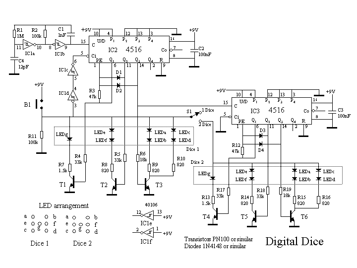

Here is one that I did some time ago. The switch allows one die or two dice to be selected.
The 4516s are configured to count from 1 to 6.
It could be modified to include 7 segment display drivers and 7 segment displays.
