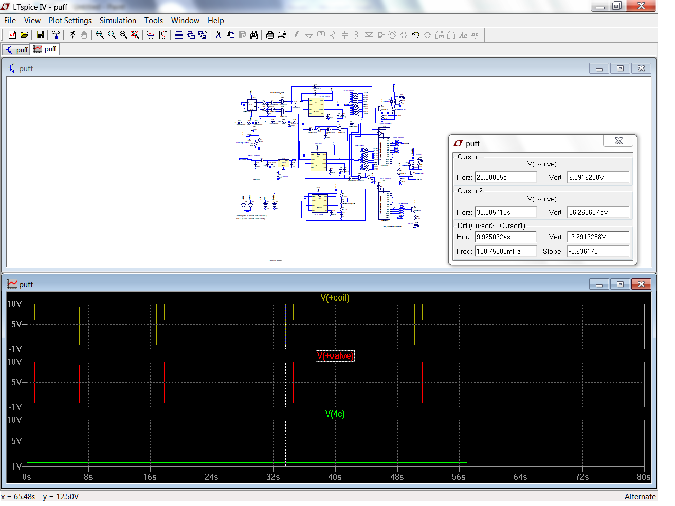

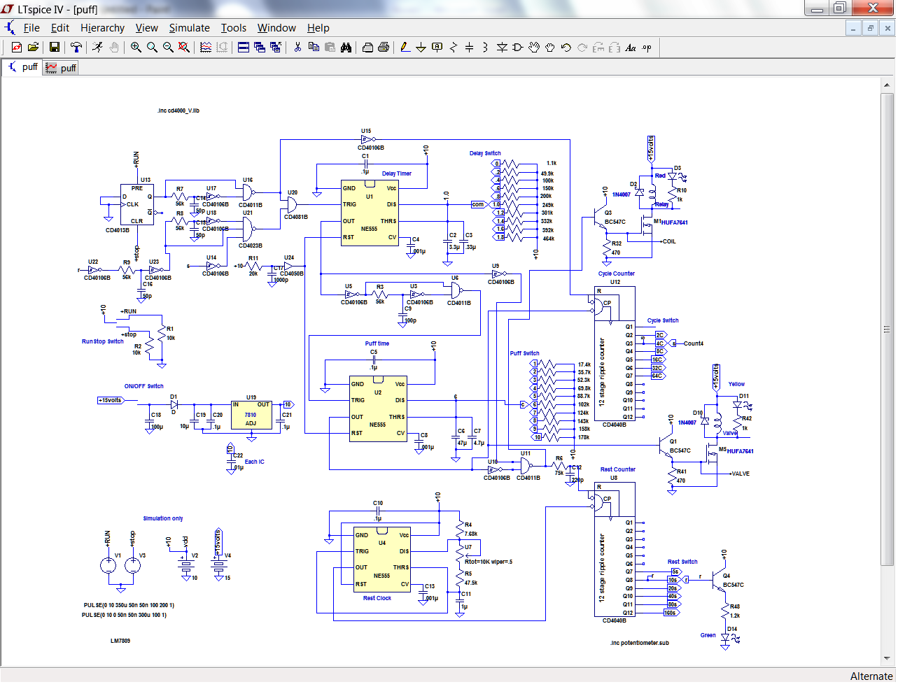

OK, Here you go.
This is a schematic and simulation of the box.
The top trace is the coil on signal. the second the valve on signal, and the 3rd the cycle count.
The switches are set for 1 second delay, 6 second puff, 10 second rest and 4 cycles.
The schematic got a little busy for 1 page, but I think it will be ok if you print it or have good eyes. :cool:
Looks great! Will it work? My eyes aren't all that great. :D
Looks like a lot of work. How are your eyes?''
No, seriously, I do see the 3 timers. I assume this will be powered by a 15 volt 200 mAmp power supply and there will be 2 output terminals one for the valve and one for the coil. How long does it take to put it together?

The simulation looks ok, but sometimes I still miss something.
Yes, same power supply. I guess you are running your 12 volt relay and valve off of 15 volts?
It would probably take a month. I could send you the parts list to buy and you could ship them to me while I was laying out the PC board. That would take about a week. I could then check that the parts look like the datasheets and check them against the layout. Then send it off to get boards made. About 2 weeks. A week to build and test it and away we go.

Yes, the 12 volt relay is being driven by 15 volts. For some odd reason I thought it was a 12 volt system. The valve doesn't have a voltage written on it and I haven't been able to find the specs for it online.
