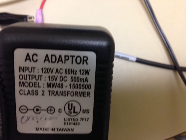

I don't have links to the relay and valve but both are 12 volts. I think the relay can handle 10 amps.
Both devices are being driven by the same controller which is fed off a little wall wart. I can put my meter on the connections and see what it says.

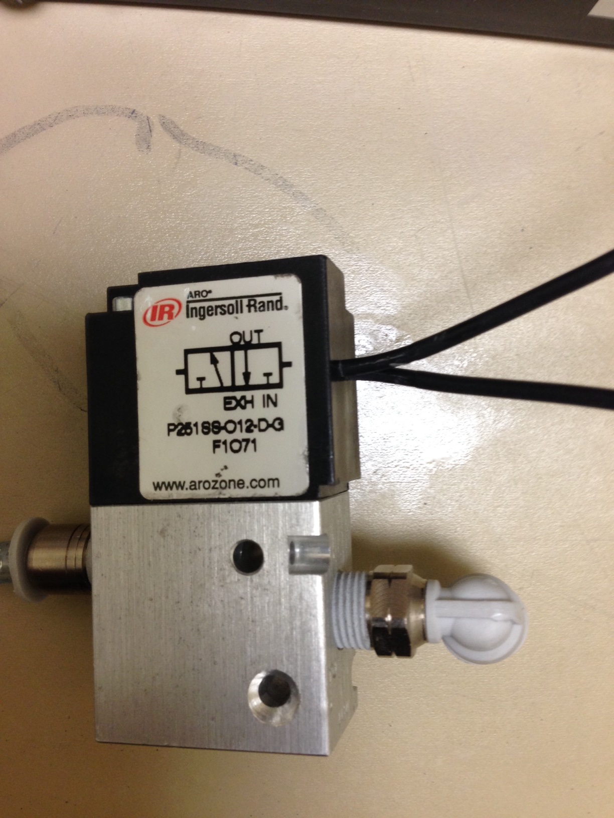

I just need to know the current so I know how big the transistor to turn them on needs to be. I think you said they were both 12 volts.
Oh, I see now it is not a relay, but a solenoid to push the button. :D

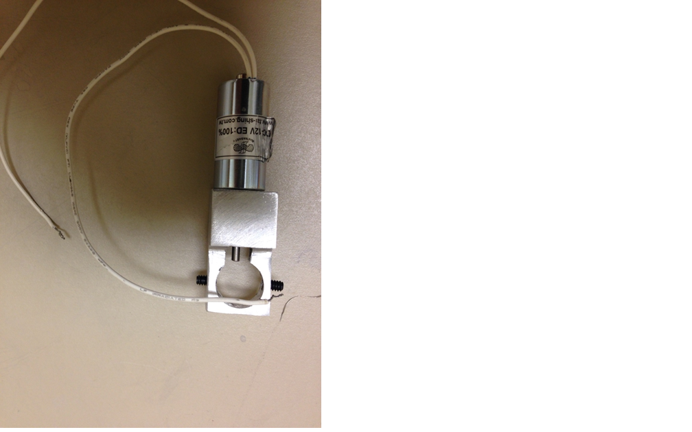

Here are some better pictures which might help you see what's going on. I was wrong about the 12 volts. It's 15 volts and 15.8 on the meter when the controller fires.
The battery solenoid picture in the above post is what I use when I want to test EGo type batteries for comparison to the power supply. It is replaces the relay switch for the power supply when testing battery power.
Let me know any other information that you need.

Just a stupid question since I have no interest in e-cigs.
They basically just have a power switch? I suppose you decouple or want to de-couple the power from the draw? i.e. Make them separate.
e.g.
1) Force the switch closed (i.e. tape) and apply power some other way.
2) Modify the e-cig, so the power switch is used.
The e-cig vents when the solenoid is off and goes to your apparatus when engaged.
There should be no reason to substitute anything but a constant voltage power supply for the e-cig supply?
