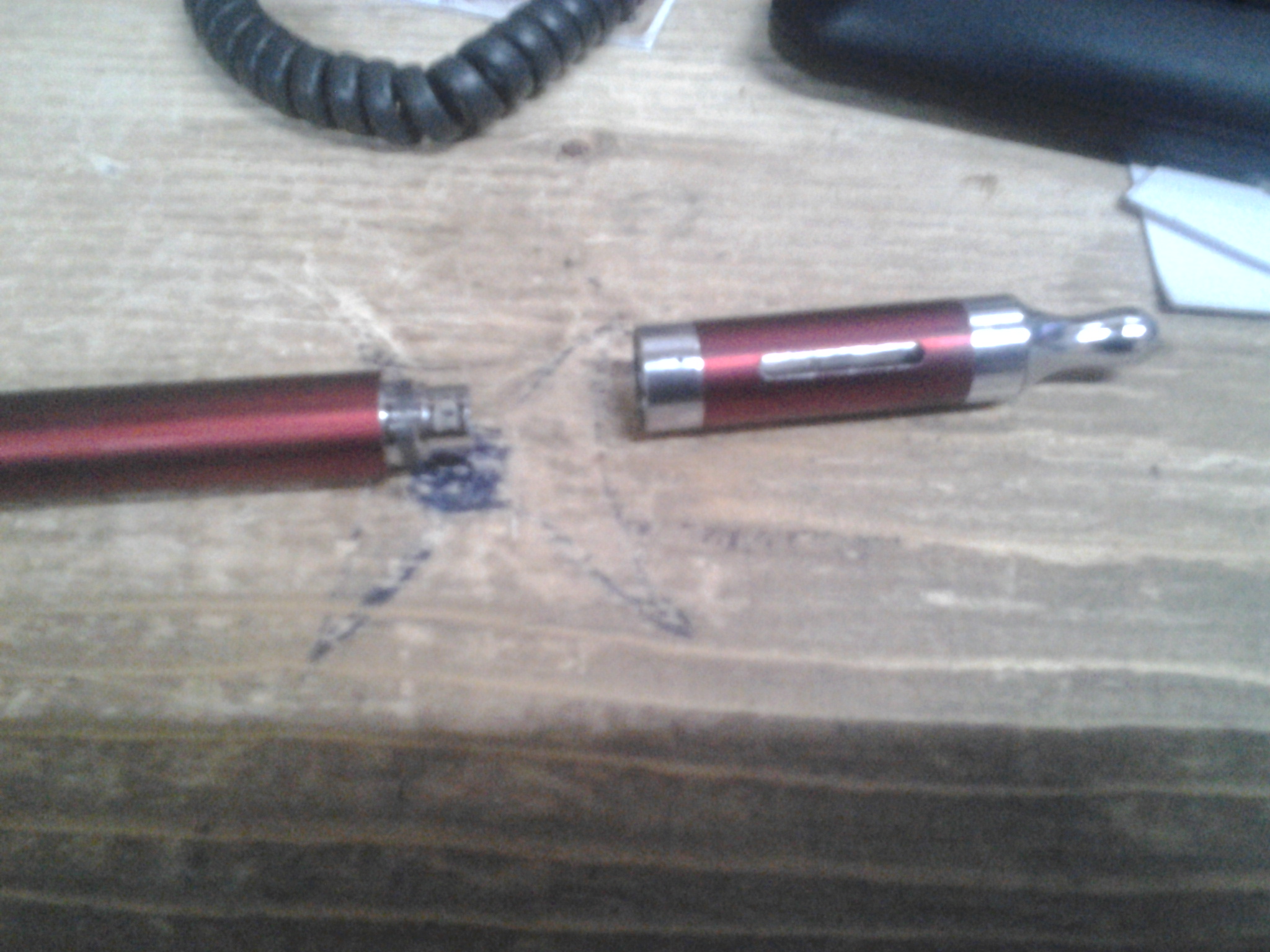

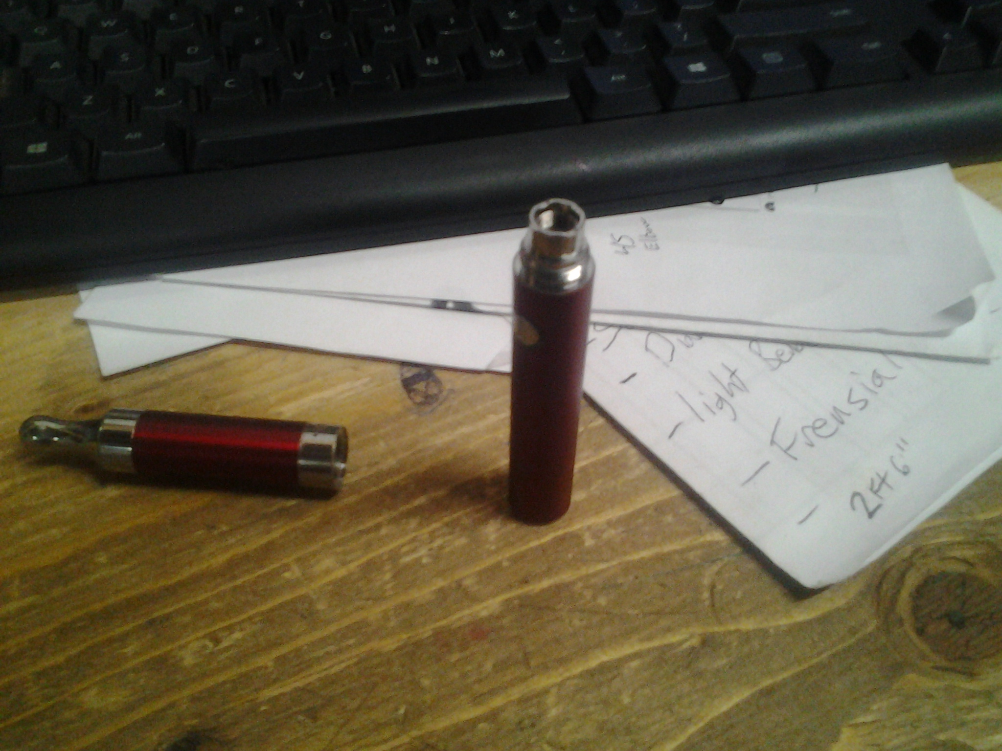

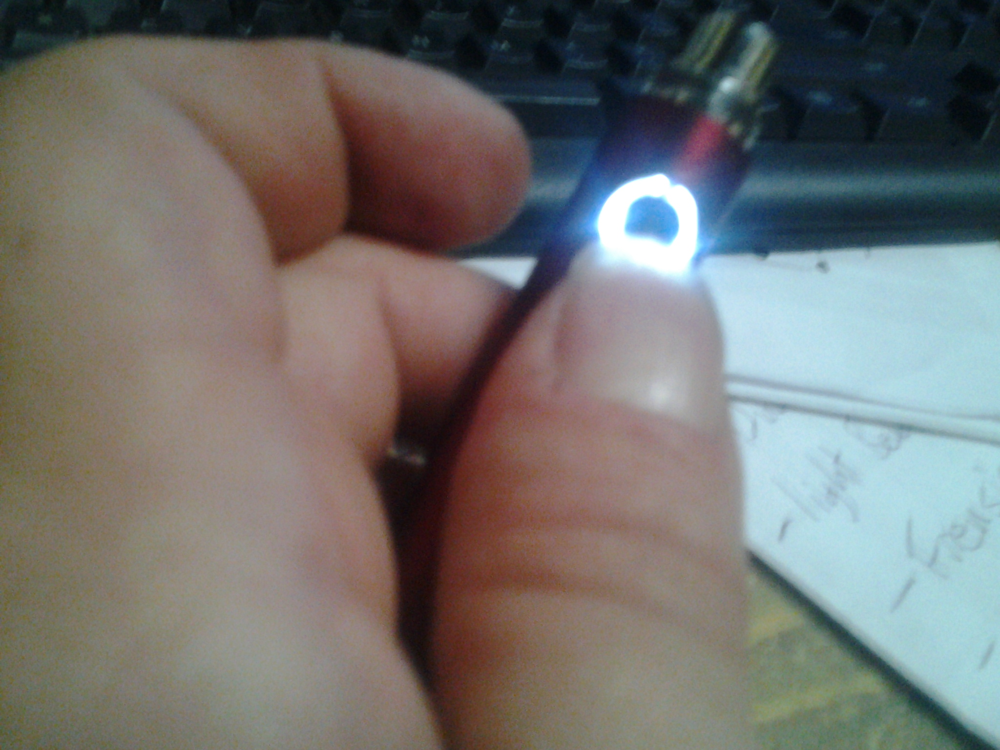

my ecig battery is li-ion i believe, based on the usb charge adapter, it has over current protection as well as a shutoff timer so you can not run it over 15 seconds by accident, mine personally is 3v with 1ohm coil,
the coil screws on the top which holds the juice as well.
View attachment 92448 View attachment 92450 View attachment 92449
We have quite a few of the 510 batteries and tank model clearomizers models. I believe the standard rechargeable batter is 3.7 volts. The coils range from sub Ohm to 2 ohms or so. Is yours a top or bottom coil?
