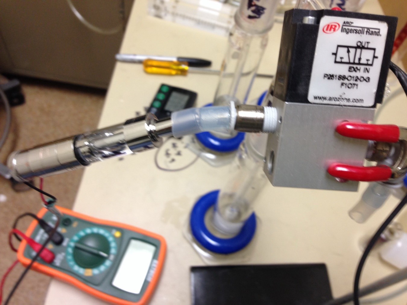

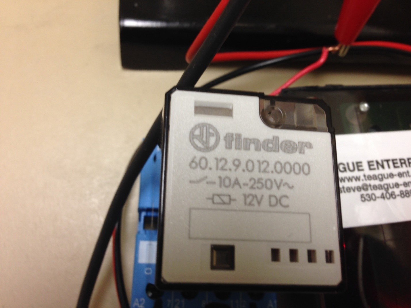

I have built an e-cigarette smoking machine that consists of a custom built controller that sends 12 V dc to a 3-way valve that directs a vacuum to the e-cigarette vaporizer and at the same time triggers a relay to direct the current from a constant voltage power supply to the coils in the vaporizer. The controller sends the 12 volt 4 second long pulse every 30 seconds to simulate e-cigarette smoking. The vapor is then collected in a series of gas washing bottles for chemical analysis.
I am looking for a better and cheaper controller. Does anybody know of an off the shelf controller that will deliver variable length pulses at variable timed intervals? Ideally, I would like to have 2, 3, 4, and 6 second long 12 volt pulses at 15, 30, 60 and 90 second intervals. It would be really great if there was a digital read out of the timing. I have attached a pictures of the smoking machine in action, the relay and the valve with the e-cigarette clearomizer attached.
I am using a 30 watt power supply to power the coil in the e-cigarette.

I did see the use of a 3-way valve, but I'd like to see the final setup in a hood or somewhere where the effluent (vent and after the traps) goes some place else other than the room.
The OP probably doesn't work weekends :D.
90+% of the vapor is in the first trap, 10% in the second and 0.1% in the third. Nothing gets out. No side stream smoke with e-cigs. When I run tobacco cigarettes I'm definitely in a hood. The side stream smoke is 10 times more dangerous than main stream smoke.
Thanks for the concern.
I thought there could be residual smoke from your vent port. e.g. your drawing while heating or your venting the e-cig.
Some valves aren't rated for vacuum, but your probably OK.

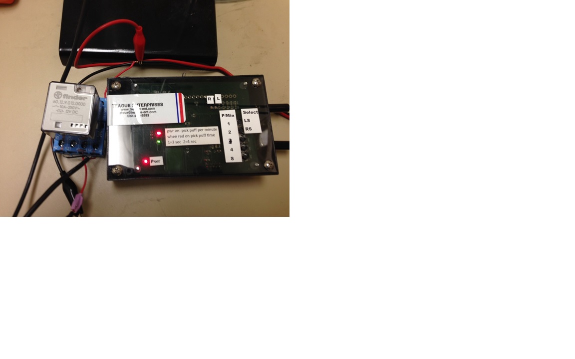

I need something more turn key. the 16F PIC is a chip and I don't know how to integrate it into an IO box let alone program it. Here is a picture of the box I want to replace. It cost$700. It does the job of doing 4 second puffs every 30 second but it is clumsy and doesn't give me much control over the puff duration and timing as I would like. There are other labs that want to build this machine and I would like to refine it a bit more as well as save them some money. Although the guy who built and programmed the controller might charge a little less now that it has been developed.

It looks a bit like chewing gum and paper clips. The case, power supply and real-estate (PCB space) are some of the things that don't seem to be addressed.
