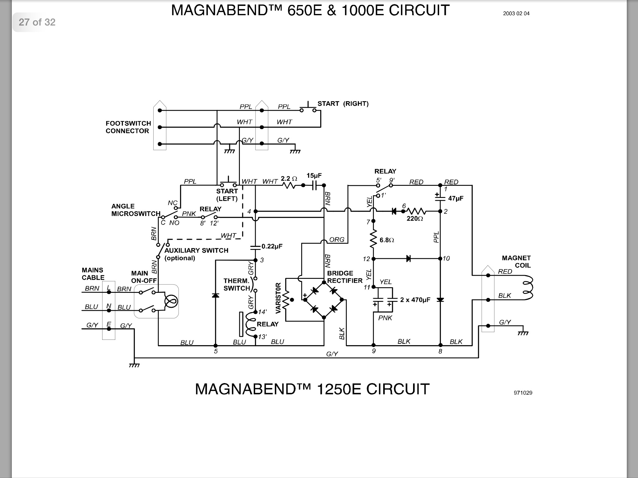

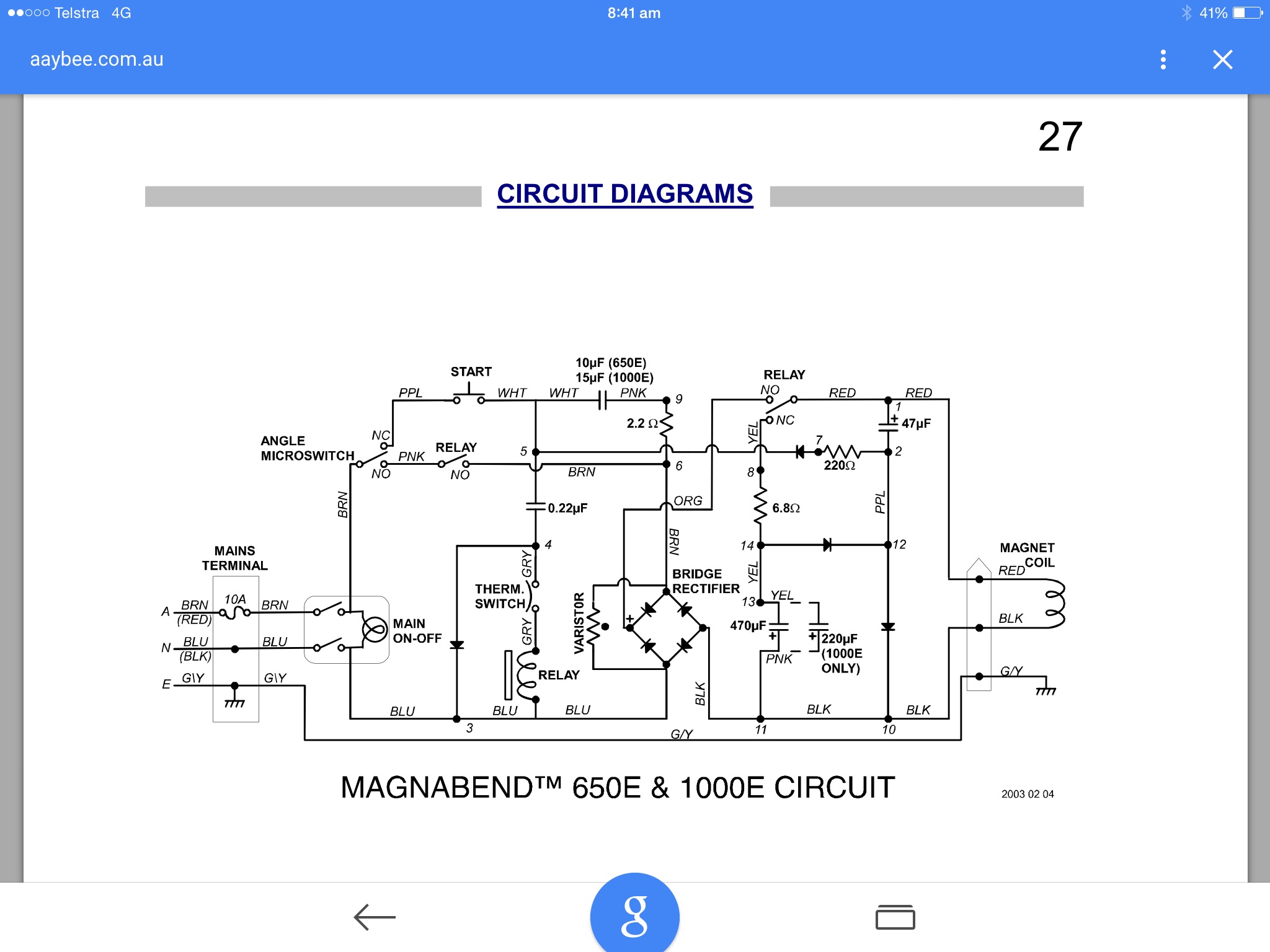

this is a circuit digram for the magnabender.that I got on line.
The current would only be house hold current single fase 15 amp.240 Ac
Can you tell me what is the restance of the magnet field in this circuit.

Having read your post the restance in the Magna bender is .0095 ohms is this correct
No. The resistance of the Magna bender would be about 24 ohms. (240 volts version.) (This is assuming that it takes the full 10 amps of it's current rating.)

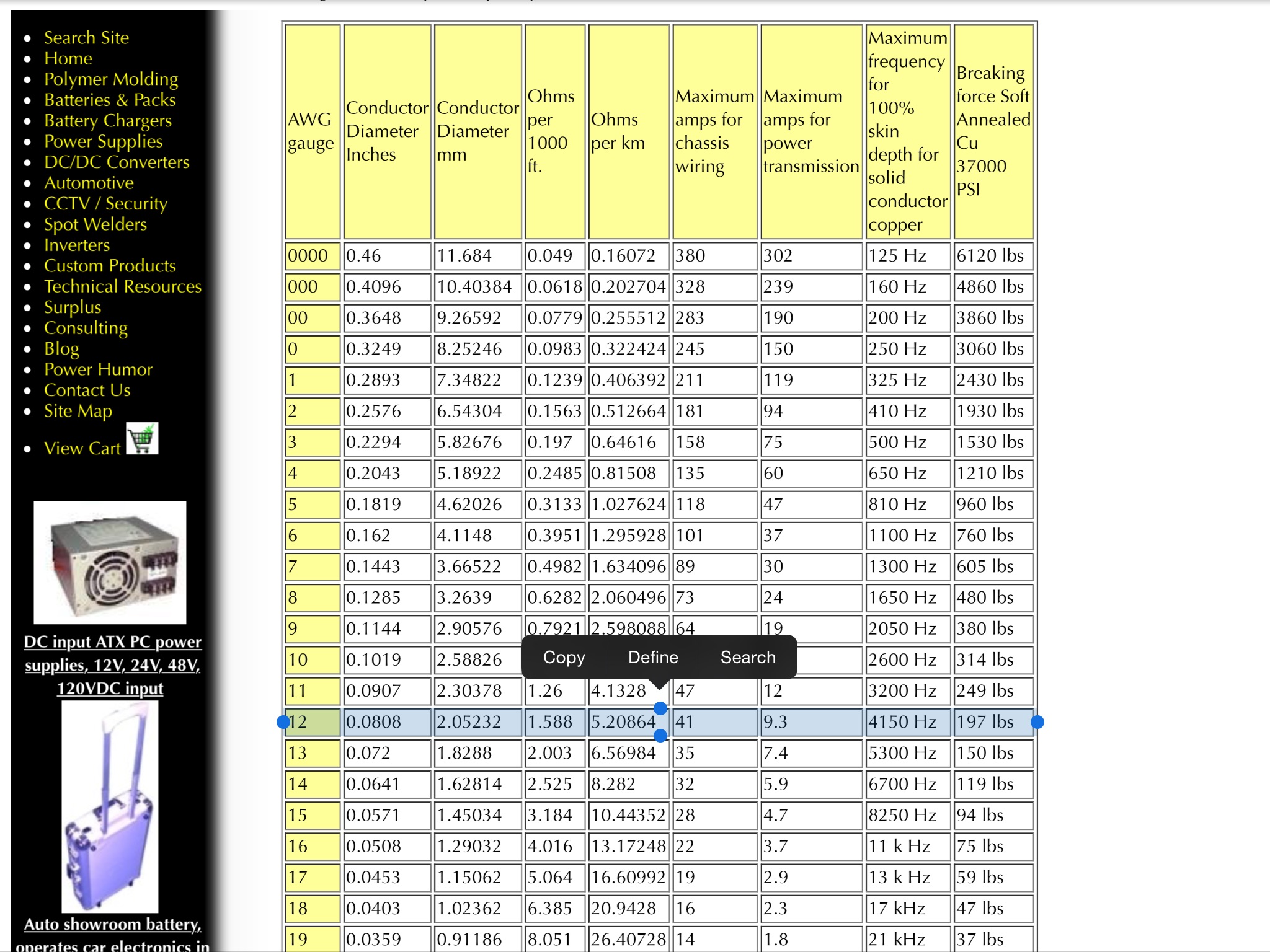

image.jpg I have searched on the net and came up with this wirer size . Using the table the one that is highlited , would this do to wind a winding for the Electro magnet 900 mm long
