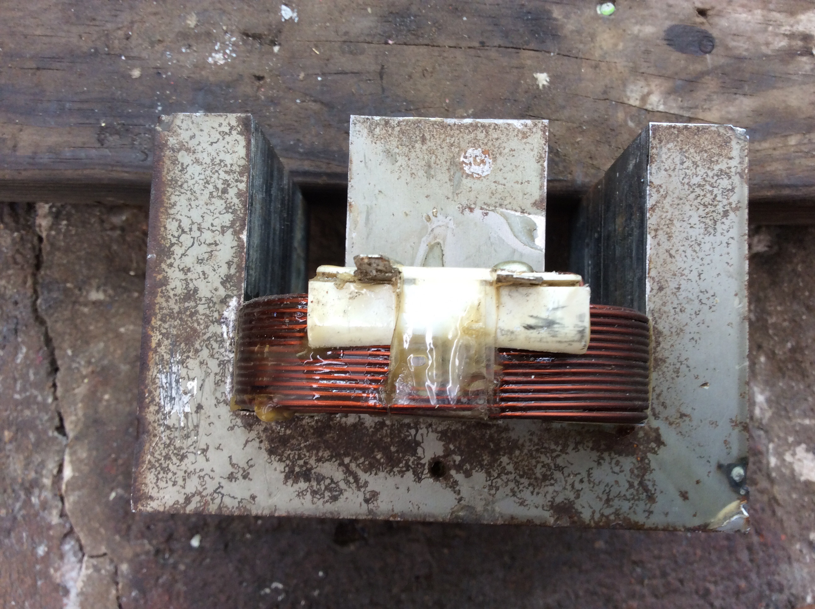

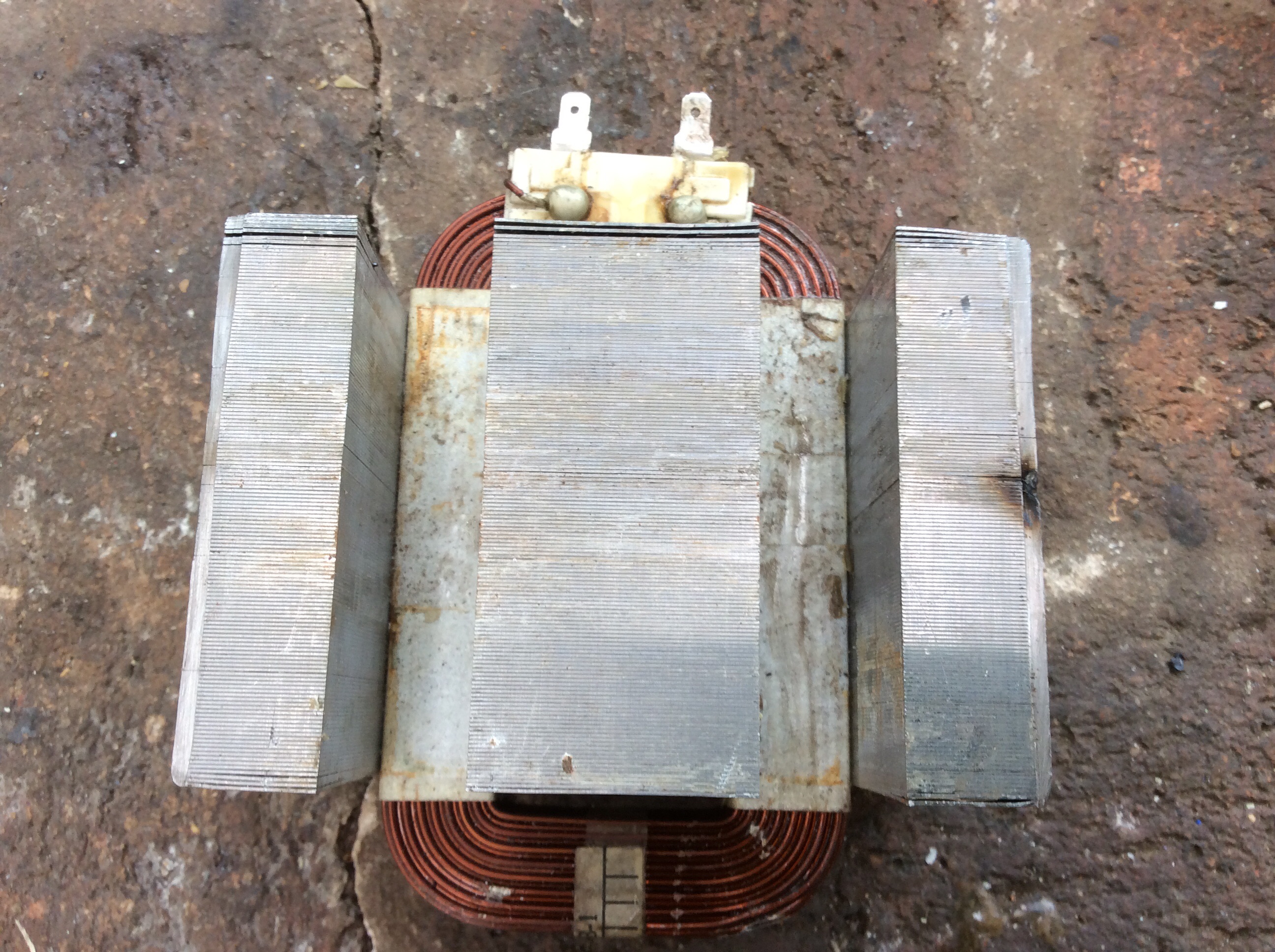

After reading your posts I have decided to go with a microwave transformer winding and field as in the photo.
Having used the transformer as a magnet which was not to bad the leads connecting to the battery did not get hot and the transformer was cool.
The winding wirer is 1.1 mm in dia and the number of turns is 208 and the restance is 1.9 meg omes.
I would like to increase the magnetic field .
Can this be done removing 4 turns on the windings.
I am very great full for your support.

Um what?
You may want to read up on the principle of Ampere Turns when it comes to electromagnetic forces.
Once you know your turns count and the current going through the wire you can figure out your ratios of magnetic force to wattage used.

This is a solenoid force calc, I assume you understand ohms law and are able to work out required resistance for current flow.
I dont know if a transformer with the end cut off is a solenoid, I seem to remember a solenoid being a cylinder with wire wound on it, what you have is effectively a solenoid with the end split then wrapped around itself, so the calc may not be accurate.
https://www.daycounter.com/Calculators/Magnets/Solenoid-Force-Calculator.phtml
For more magnetism, wouldn't finding another microwave transformer of the same size and then take its primary winding and add it to the E-core and wire in series, work? When connecting the newer coil to the first watch that you keep the winding's in phase.
That would give the same strength magnetic field but only consume half the current. Twice the resistance so half the current. But as there will be twice as many turns the magnetic field will be the same. If connected in parallel it would give twice the magnetic field (Assuming the core did not saturate.) but it would take twice the current.
Les.
I do not think it would make any significant change to the magnetic field strength. I do not know this to be a fact so wait for some more replies.
Les.
Because your running at low voltage you might be able to make a tap by sanding the outer insulation off the windings and solder on a wire, if you can find a point with the correct resistance you'll be able to do this, finding a point with less resistance will increase current.
I agree with les on shortening the core not making much diffrence, you'd just be shortening the magnetic path length, which will only have a small effect.
The core you used has laminations which are insulated from each other, chopping the end off has probably shorted them all togther, that probably isnt a problem either if your running it off dc.
I don't think tapping down the winding will give a stronger magnetic field. If you tap in at half the number of turns then the current will double. (As the resistance is half.) But you now have half the number of turns so the product of the number of turns times the current will be the same as before.
Les.
Yes,
There will be a point where everything works as well as it can, the o/p isnt looking for perfection.
Many microwave oven transformers have a weld bead across the laminations tying/shorting them together from the factory.
I think the reason the weld does not cause a problem is that it only shorts one edge of the laminations together (On 2 of the 3 legs of the "E") As a result it does not create a shorted turn around the magnetic path.
Les.
