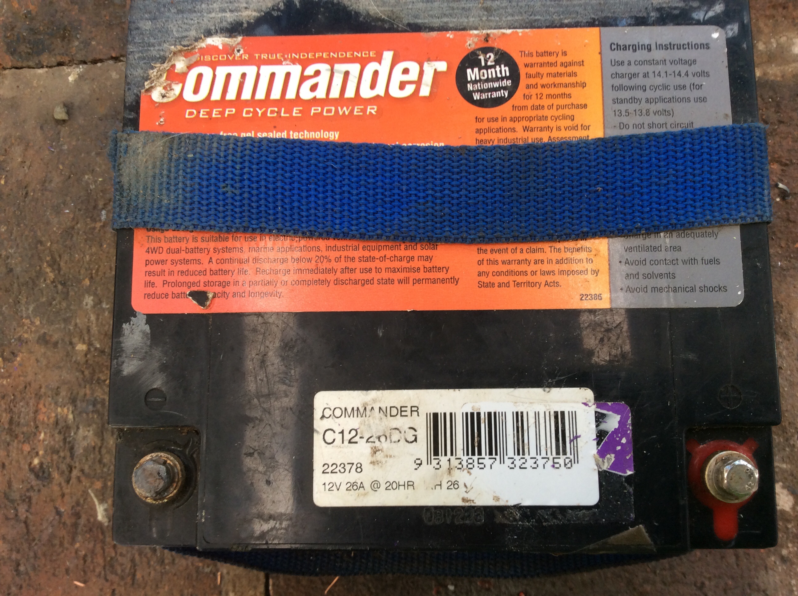

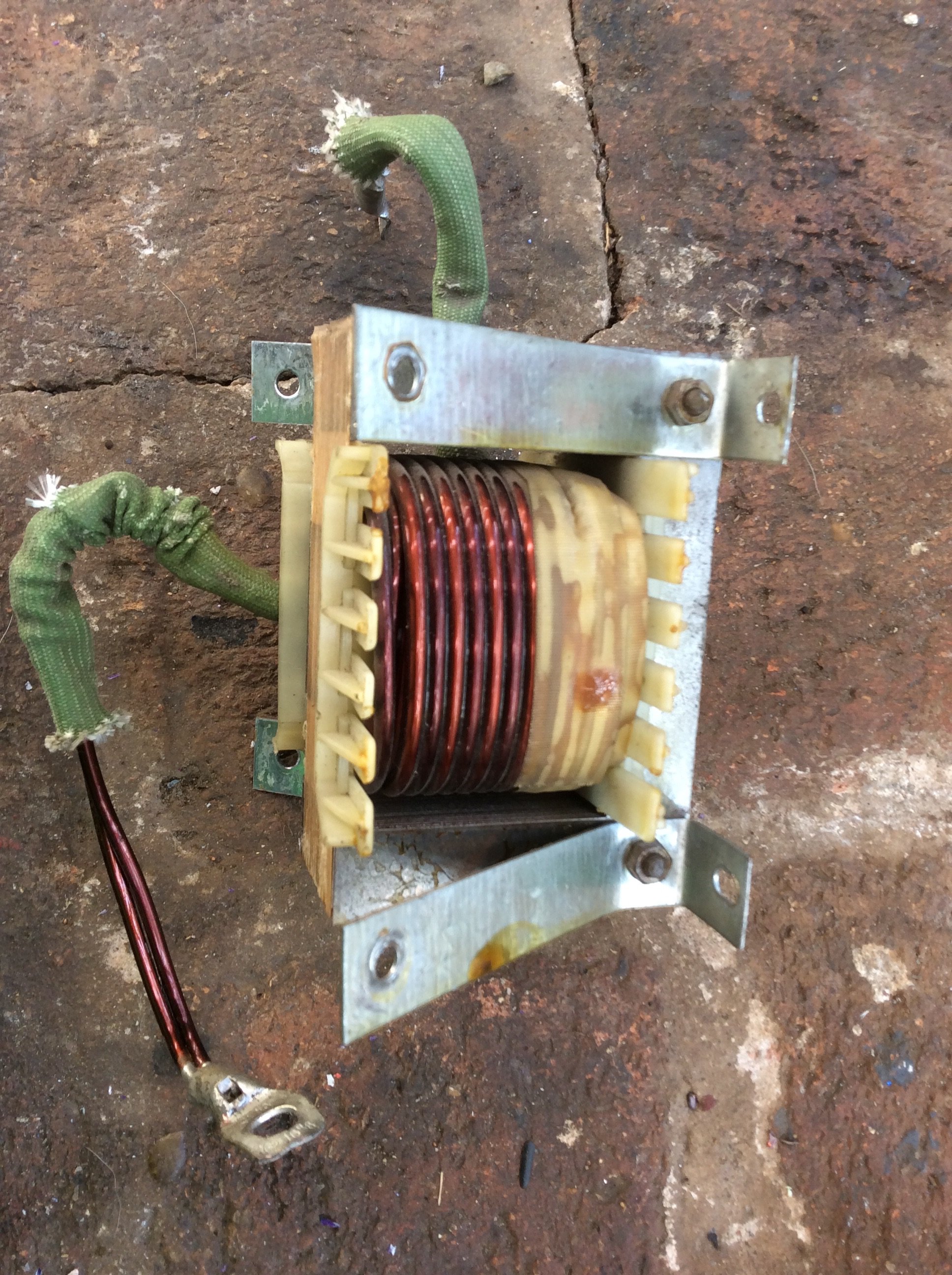

image.jpg image.jpg image.jpg image.jpg I have a transformer that I am making into a electromagnet using a 12 v battery . The wirer size is 3 mm dia and there is 2 wirers joined.
I have provided photos of the battery and trans former.
I connected the wires to the battery but the insulation started to melt but the magnetic field is very strong . What can I reduce voltage or current to prevent the wire I connected to the battery from melting but to maintain the magnetic force.

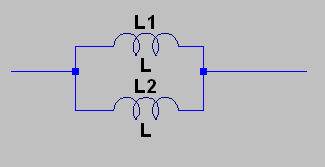

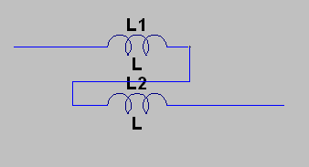

When I change the connections do I have to reduce the Voltage , or current . I should be able to cut 2 wires to arrive at what you have posted and join 2 together .
My change will reduce the current. Give it a try. It may get hot and them we can find a way to reduce the voltage and current.

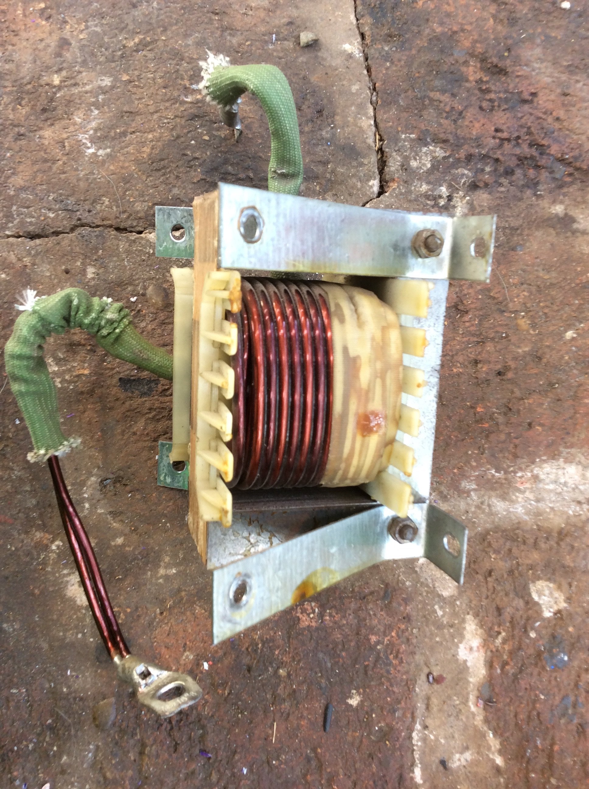

I have done what you requested and the wires melt the insulation and now the transformer windings get hot and started to smoke.
Have not damaged the transformer.
The original windings are probably not suitable for using on dc as an electromagnet, to get it to work well you'd really need to recalculate the number of turns, and wire size then rewind the core.
There is a balance between magnetic field, current flow and number of turns, you'll probably get nearly as good a magnetic field with a lot less power designed correctly.

That thick gauge wiring is unsuitable for 12 Volts DC and will overheat. Better to rewind or find an other transformer with a thinner gauge of wire.

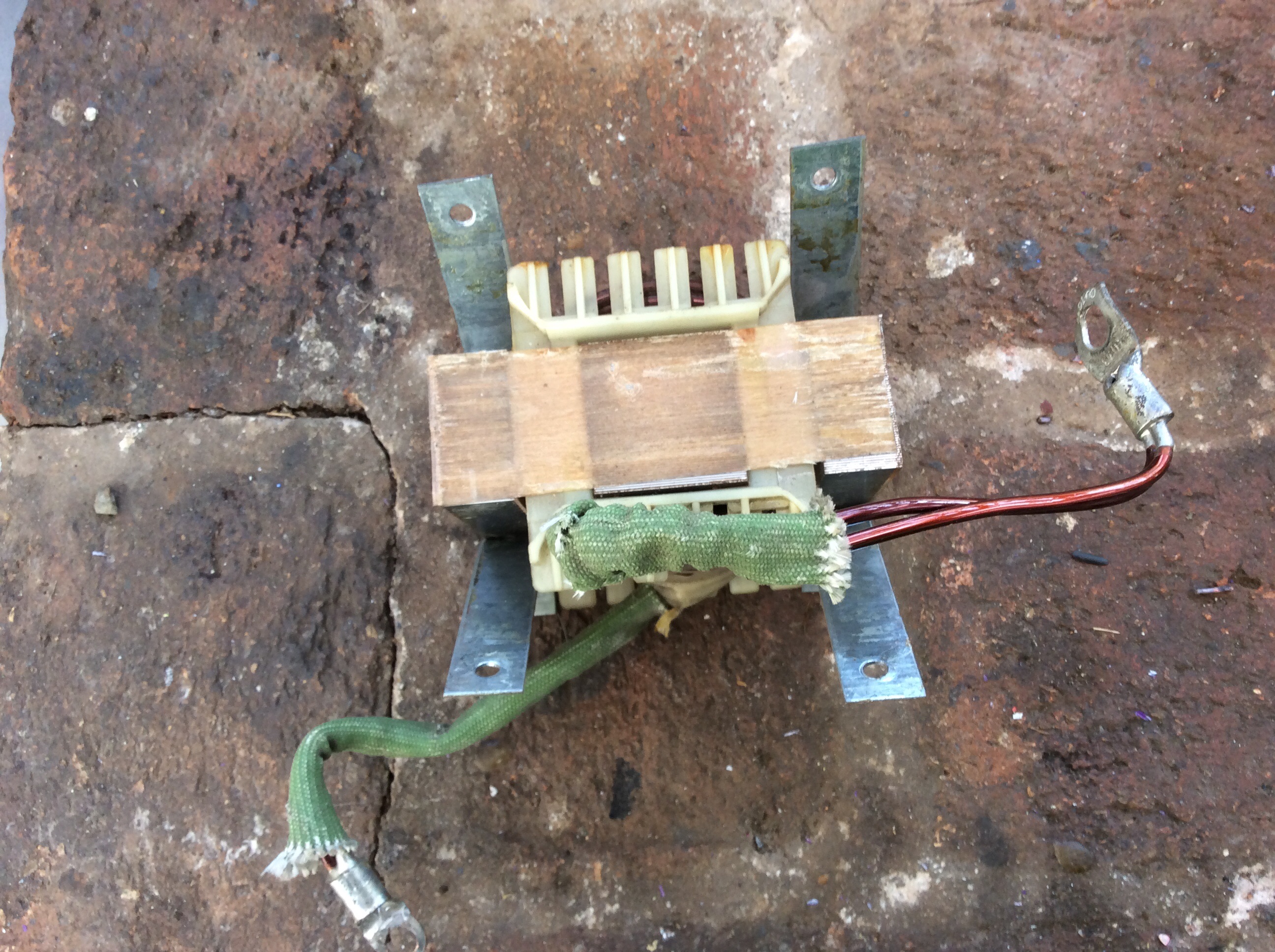

I think Gregory is just using the "E" laminations so the open ends if the "E" should provide a reasonable magnetic path.
I do not think he will achieve the same strength of magnetic field with a sensible winding. From the picture I suspect the original winding is well under one ohm. So the current would be greater than 12 amps.
