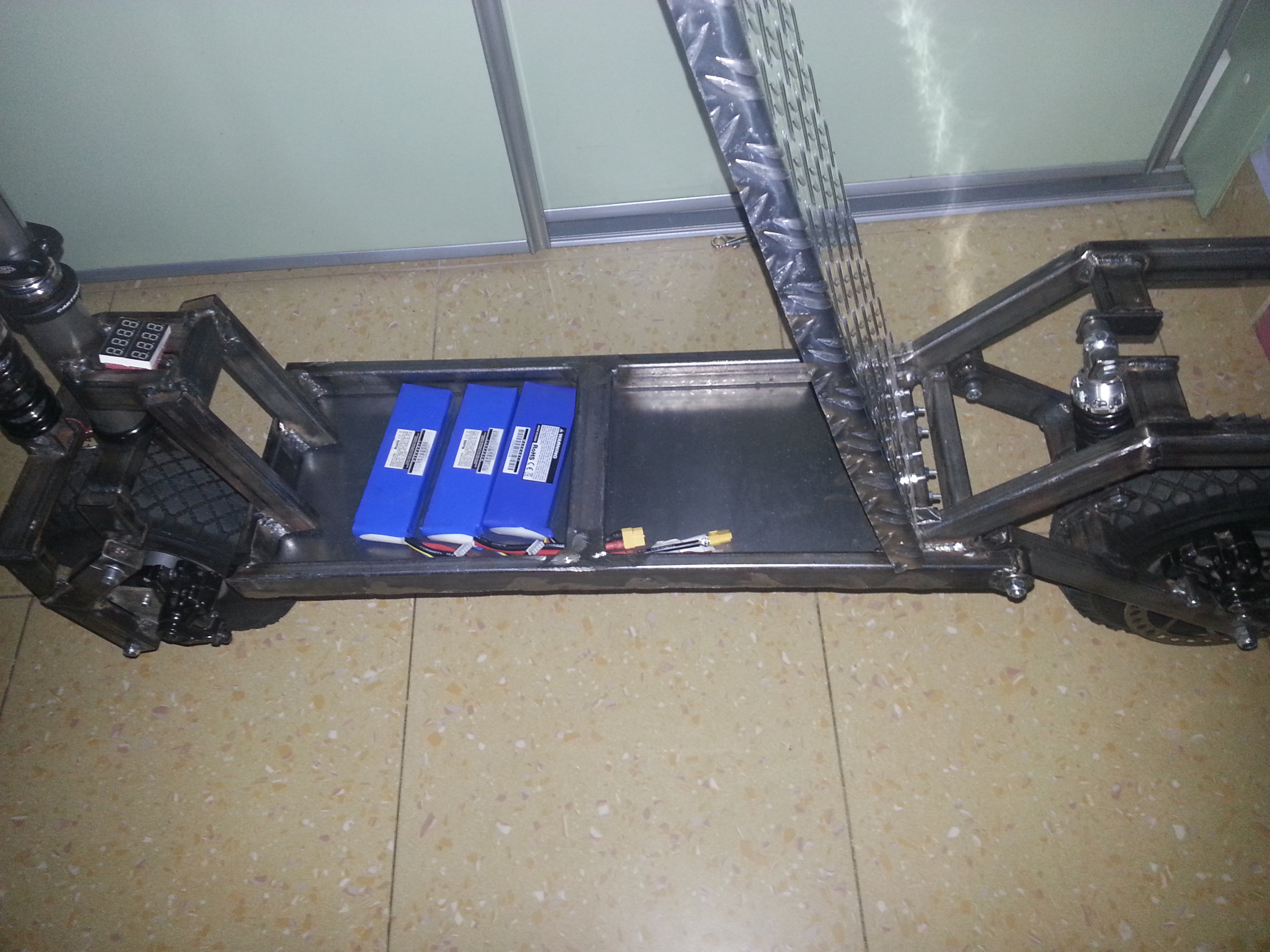

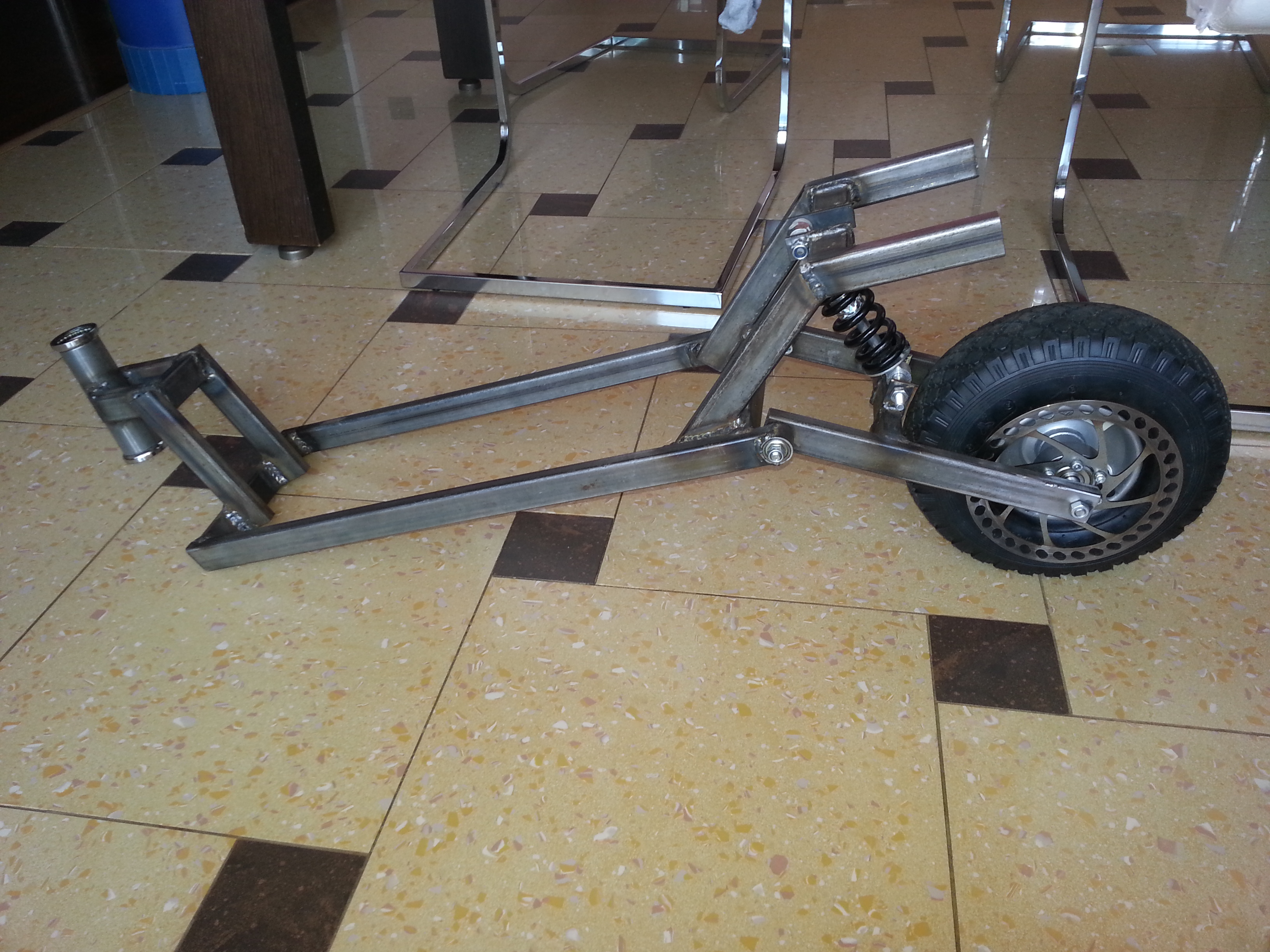

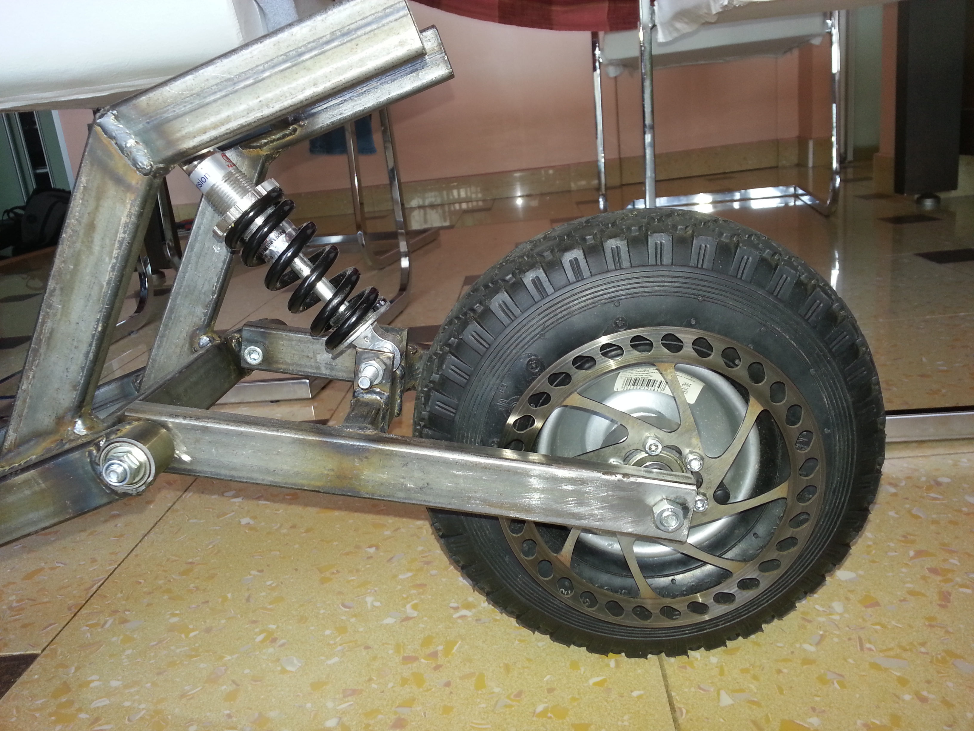

Here are some pictures of what i have done so far :)
Now i need to buy mechanical disk brakes and put them on, and install front wheel and steering wheel assembly (thats what i will do today)
I am thinking weather to use bicycle gear for transmission or transmission that is used in cars (i think it is called "pulley")
Motor and electric speed controler and other electronics will come in the last stage of building it but it may come soon :)

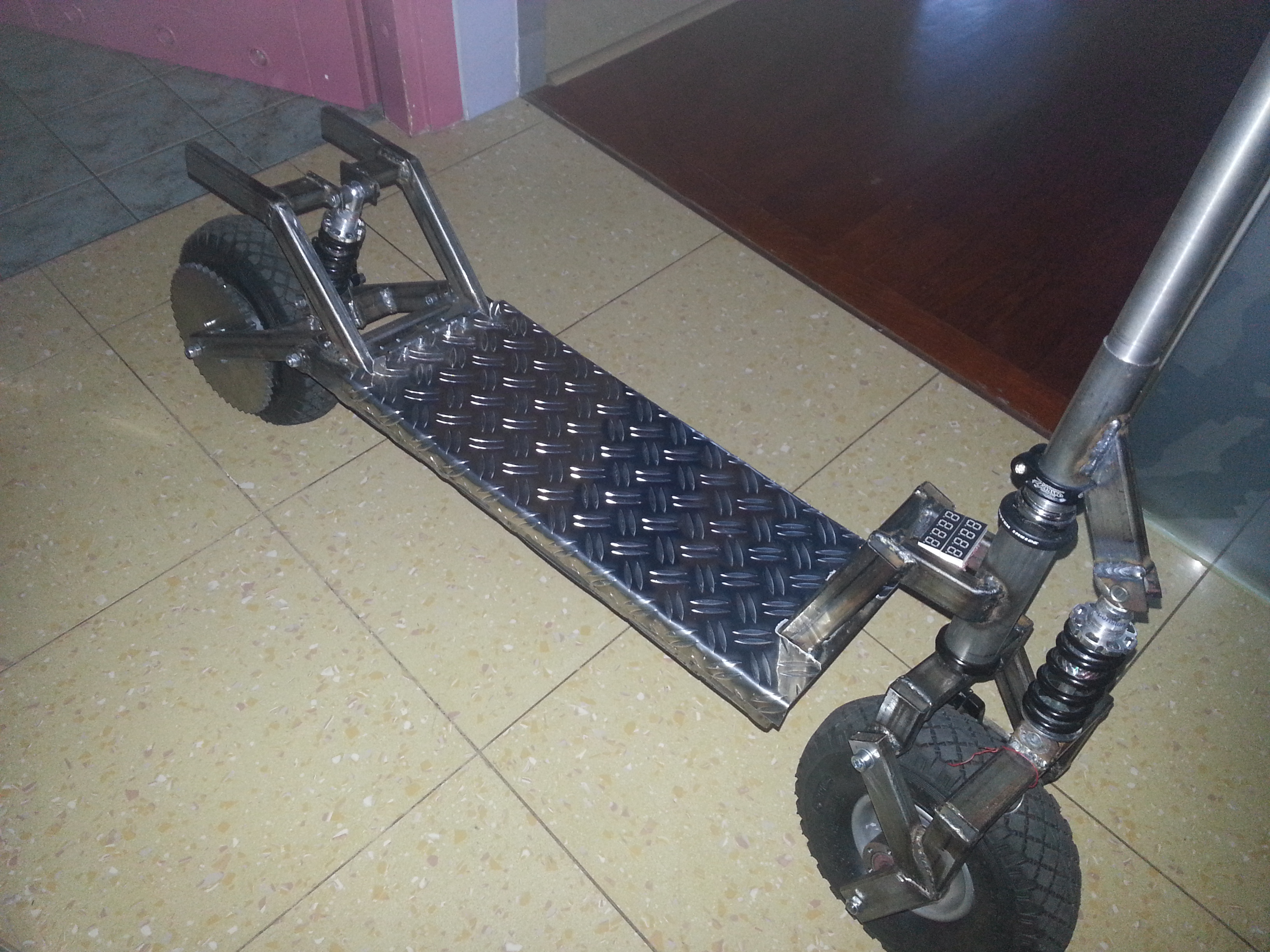

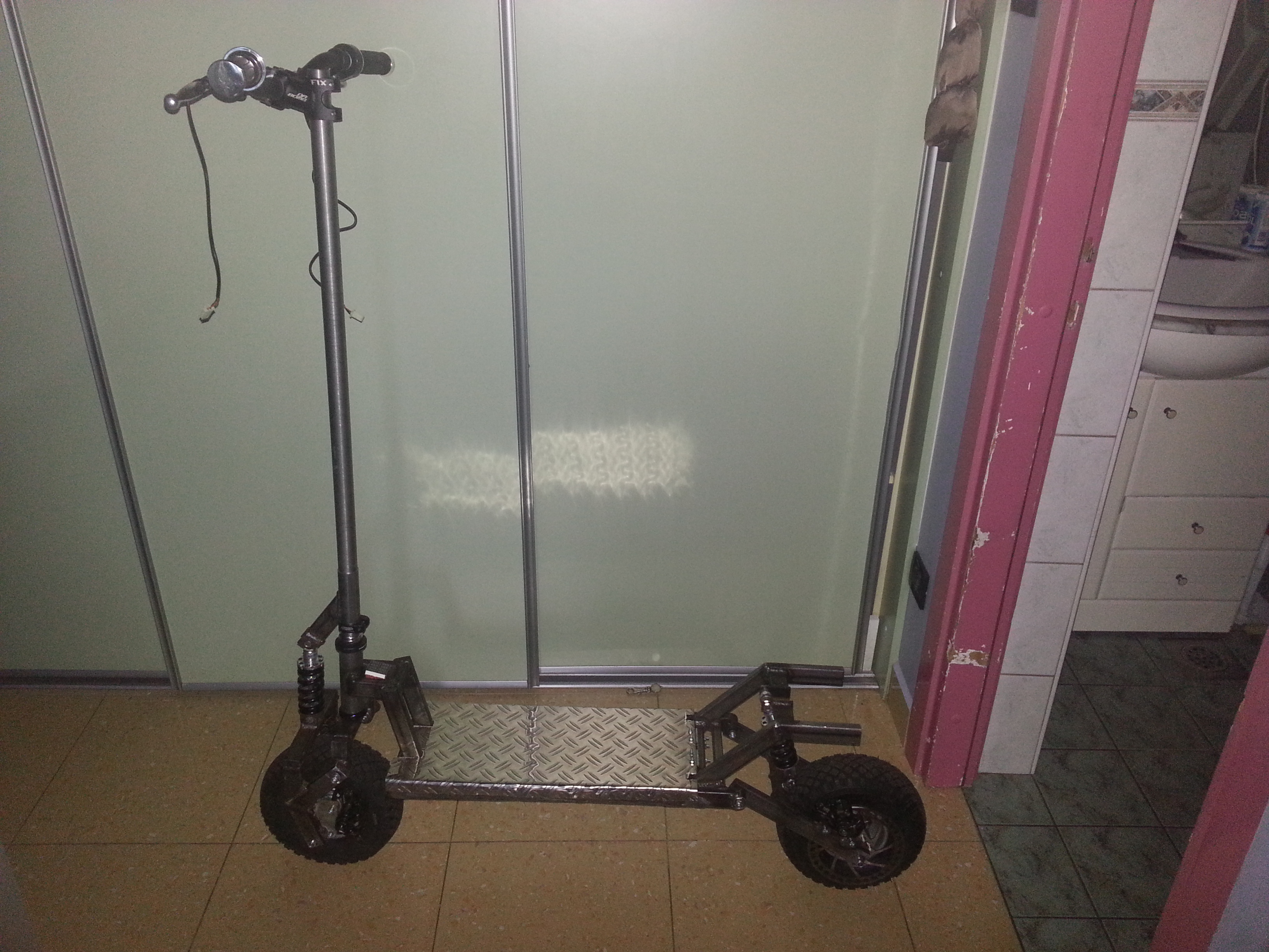

Sorry for so late reply :D i could have done it in much easier way (just put motor on scooter for kids), but i wanted to do all myself. Here is how it is going. Scooter is 95% done, only motor and ESC are missing, and other elentronics. It should all come soon
What do you say about it? :)
High ground clearance! Planning to do some off road riding with that thing? :confused:
I dont know yet :D
But it will be smaller by 4cm because in that space i am standing on i will put all electronics and batteries :)
There will be front and rear mechanical disk breaks with 160mm rotors, but for now, yea i am breaking with my foot :D
It is not finished yet but it would be very soon, and then i could make 20km without any problem and with speed of 27km/h
