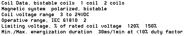

If you intend using latching relays, be aware that their coils can't be powered for lengthy periods. Here's an extract from a Shrack datasheet :
