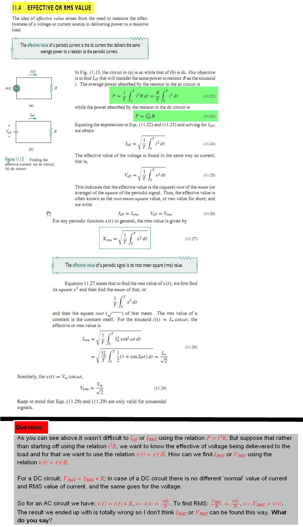

Could you please help me with the query included in the attachment? Thank you.

You have missed the point of my question there. I wasn't asking what the RMS value is rather my query was quite different: Can we find RMS value using the relation V=IR? I would request that you give the question another read.

You can get the RMS value of any periodic signal using the frms function defined here: https://mathworld.wolfram.com/Root-Mean-Square.html
Do you mean v(t)=i(t)*R? or do you mean V=I*R say for a DC circuit. In the latter case V is Vrms, however we normally associate RMS with an AC signal, but we don't have too. e.g. 12 VDC = 12 Vrms
Another definition of RMS is the DC value that would generate the same amount of heat as the AC waveform into the same resistive load R.
Sine waves are special cases that are encountered often, so we know the p-p and RMS values of common sin waves (line voltage) and we need those numbers (e.g. p-p/RMS of secondaries) to design a linear power supply. So when v(t)=Asin(t), t=0, 2∏ you can plug into the rms formula for one period and get the special case equation. e.g. https://www.wolframalpha.com/input/?i=root+mean+square+sin(t) for A=1
Cheap meters measure the average value of rectified AC and multiply it by a fudge factor valid for a sin wave only input to get RMS. High end TRMS or True RMS meters will have options for the AC and the AC+DC waveform. Averaging is easy: you full-wave precision rectify and filter.

For now let's just start over. We'll do the example of the sinusoidal wave which is usually shown with the
required peak value out in front Ep. Ep is the peak value of the sine (or cosine) wave.
Ep*cos(w*t)
Evaluated with w=2*pi*f:
Ep*cos(2*pi*f*t)
To start the RMS procedure, we first square this:
Ep^2*cos(2*pi*f*t)^2
Now we find the mean which first means integrating from 0 to T, so we get:
(Ep^2*(sin(4*pi*f*T)+4*pi*f*T))/(8*pi*f)
then dividing by T:
(Ep^2*(sin(4*pi*f*T)+4*pi*f*T))/(8*pi*f*T)
and since the period T is equal to 1/f we evaluate that with T=1/f and we get the simple result:
Ep^2/2
And finally taking the square root, we get:
Erms=Ep/sqrt(2)
So the RMS value of the wave is the peak value divided by the square root of 2.
And this is true whether we look at voltage V or current I, so we get either:
Vp/sqrt(2)
or:
Ip/sqrt(2)
Depending on either the voltage or current waves.
Now if we wanted to find the RMS voltage from the equation:
v(t)=i(t)*R
we would just substitute i(t)*R for the voltage. Since R is constant if the current
wave is sinusoidal then the voltage wave is also, so if we use i(t)=cos(w*t) again
we get for the RMS of the current wave:
Irms=Ip/sqrt(2)
but since it is multiplied by R (to create the voltage wave) we have to multiply that by R:
Vrms=R*Ip/sqrt(2)
This works because R is not a function of t and so can be taken out of the integral so the
whole integral simplifies to that of finding the RMS value of the current and then simply
multiplying by the resistance R. If we kept R inside the integral we would just end up
squaring it and then later taking the square root so we'd still end up with the final
result being the same where Ip/sqrt(2) is just multiplied by R.
If you are talking about a DC value rather than AC, then the DC value can be taken out of
the integral because it is not a function of time. So we'd end up with Vdc^2/f and then
divided by 1/f which would give us Vdc^2, and then taking the square root we'd get
just Vdc back again with no multipliers. So for a DC voltage we just end up with:
Vrms=Vdc
In this case f would just be any f such that T=1/f is any period we care to choose (because a
DC voltage is the same over all time).
If this doesnt help with your question about V=IR then you have to present some example
about what you are talking about because that would mean that your question isnt clear
enough by just writing V=IR and asking about that.
BTW im not sure about what you said 'does not come out right'. What did not come out right?
We could do other examples here too no problem.

It seems like there has been miscommunication. Seriously I wasn't complaining about any typos etc. As a matter of fact I didn't know if you had made any mistakes there. I was merely saying that you had failed to see the angle of my question and part of the blame could be laid upon me - perhaps I didn't state my question clearly. Right now I don't have much time to rephrase my original question because I have a lot of assignments due next week and that question is part of series of questions which I ask for my own understanding so it can be postponed for sometime. Right now I just wanted to make it clear that I wasn't making any complaints about what you wrote. Thank you for the understanding.
Best wishes
PG
Yes i guess you'll have to take a moment to try to restate the question. Usually the question is just how to calculate the RMS value and that's it. You must have thought about something related and want to know how it works and that's understandable, so now you have to convey exactly what it is you want to know.

Hi PG,
I can give you my opinion about your question.
The page you show makes it clear that the intention is to find an equivalent DC current that would deliver the same average power into the resistor. This is why using v=Ri is not the correct way to go. Ohms law does not give you power, so it is not good for finding the effective voltage and current.
When you use the power formula I^2R or V^2/R, you directly get the RMS current and RMS voltage formulas. Hence, the fact that the operations of square root, integration (averaging) of the square is a direct result of the definition of the expressed problem. In other words, you state the problem (find the effective value that gives the same power) and you determine the answer by applying the power formula and you discover that root-mean-square is the value that works.
Finding the RMS value via the defined calculation is a separate problem, and solutions for common waveforms (usually periodic ones) are well-known. I hope this is clear.
Thanks a lot, Steve.
You have understood my query and I'm happy I didn't have to rephrase it.
