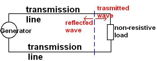

I'm currently taking a course that deals with waves and transmission lines, and according to what i learned, in order for the power to be radiated, there must be some non-resistive load that matches the transmission line's characteristic impedance:
untitled-jpg.34674
How does this model exist in our household system of Neutral and Live wires and appliances?
I'm not sure what causes the power to radiate outside in this system.

The transmission line wont put out too much at 50 or 60Hz,
We never talked in the course why is it that at 50Hz/60Hz you dont talk in terms of "impedance matching/mismatch".
Why isnt power radiated outside at low frequencies even if the amplitude is large?
but at the multiple
other higher harmonic frequencies there's got to be some bad mismatch, as it cant
be matched for every single harmonic frequency. It probably becomes one big
antenna.
Thats new to me, perhaps because we only learned so far about lossless transmission lines without dealing with the effects of a non-ideal environment.
The transmission lines acts like an antenna because parasitic capacitance that is created since there are wires close to each other?
Hi again,
I guess even at 60Hz something would get radiated, but it doesnt seem to bother
anything except maybe audio amplifiers which pick up 'hum' from the line.
Wouldnt anything that carried a current act as an antenna to some degree?
I think you are right about the capacitance having an effect as that would
be somewhat low in value and therefore cause more current flow for the
steep voltage wavefronts with the high harmonics. Even lower capacitance
would cause current flow at the higher frequencies.
The electric field is probably going to cause interference too.
It's been quite a while since i looked at these issues however so i dont have
all the answers right now :) We havent even talked about corona yet :)
hahahaha, I'm more into Vodka rather than beers ;)
I thought of parasitic capacitance since a resistive object won't be able to radiate the transmitted power since it will dissipate all the power.
However, an inductive or capacitive load will radiate the transmitted power since it doesnt dissipate the power.
*When i'm saying transmitted power, i mean that part of the wave (power) is reflected back to the generator, and the other part goes to the load.
