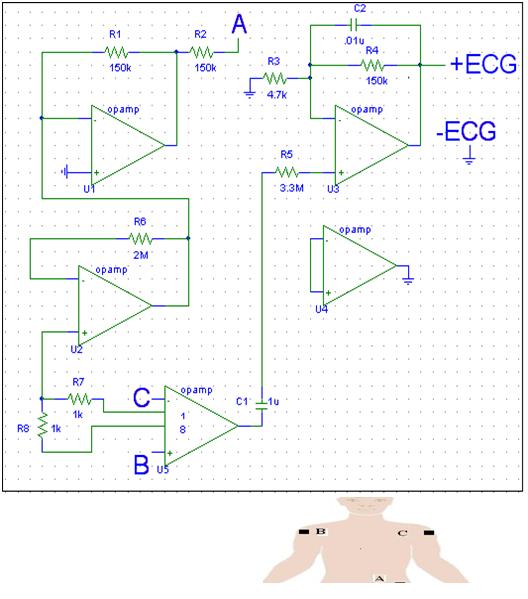

Can somebody please expalin me the working of this circuit?? its urgent
Can somebody please expalin me the working of this ECG amplifier circuit?? All opamps are TL074 and the bottom one which has B and C inputs is an AMP02.
Thank you....it's really urgent for me
