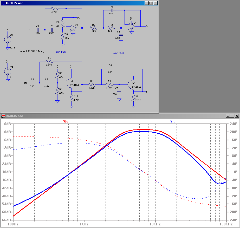

I used TI's "FilterPro" to design the opamp version, and then substituted an NPN transistor and pull-up for the opamp. Looks like it may have some possibilities.

Sallen-Key 2 pole Butterworth High-Pass cascaded with Low-Pass. I converted the unity gain opamp to an emitter-follower, which is almost unity gain...
Note, it is ac coupled, so you cannot rely on the dc level info....

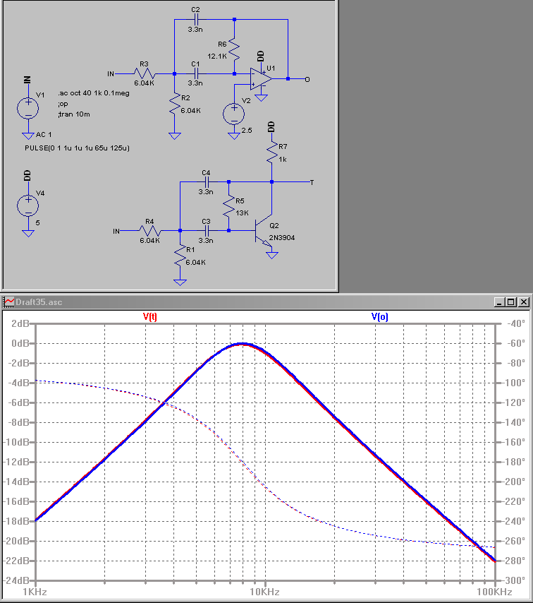

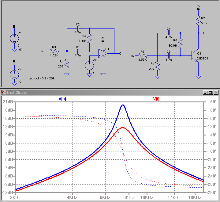

Yet another, this one is a 2-pole bandpass with a Q of only 1. Also converted to using an NPN transistor.

Thanks again everyone for the ideas and especially Mike for the schematics and sims.
At the moment the best shot looks like Mike's last schematic, it's only 2R and one transistor more than my 2R 2C kludge and better performance. And all parts I can use 0805 + SOT23 which can be spead around the PCB so it's pretty good for size.

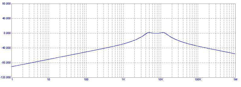

Here is why the LC filter looked attractive:
