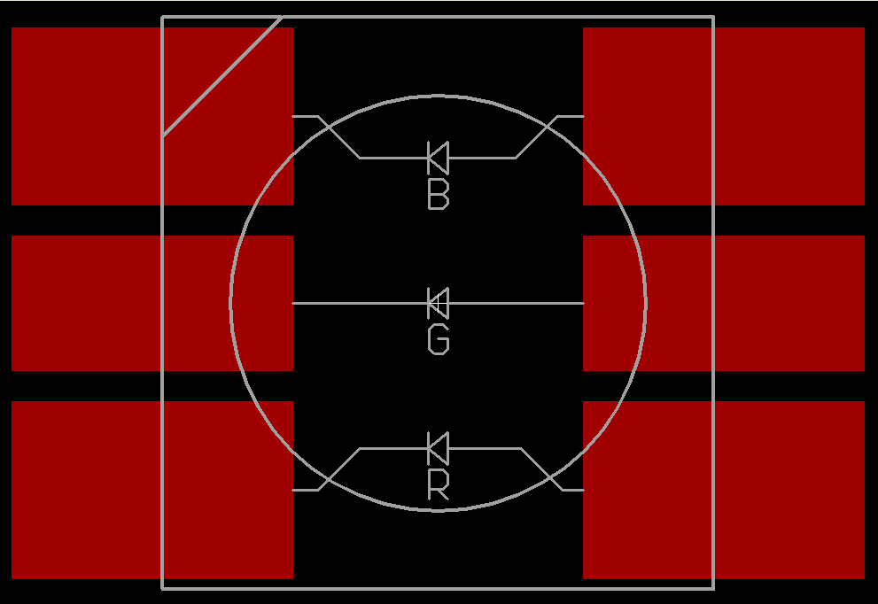

When using SMD parts don't miss to use layer51 instead of layer21 for the part outline. That way the solder pads won't be overwritten with the component layer in case you order the PCBs at a board house.
If there is anything printed on an SMD pad you will have severe problems when populating the PCB for soldering.
Layer51 is never used when printing a silk screen.

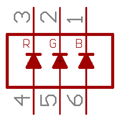

Hi Dan,
if your LED is a CREE PLCC6-3 here are package and symbol.
Regards
Boncuk

Hi Boncuk
Only just checked back to this thread, I managed to save my botched up old version I made
That looks like the right package - where can I find it :)
Many thanks
Hi Dan,
I guess you won't find it in Eagle.
I created a new package for curiousness to see how it works out. You may have the (separate) library for it.
Just PM me your full name and your email address.
Boncuk
