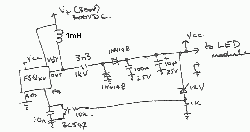

I might even go through with the following crazy idea:
The supply to the FSQ is shared with the LED driver board for now (possibly a bad idea - so may want to isolate it somewhat). I reckon it will work as shown (or with minimal mods).
