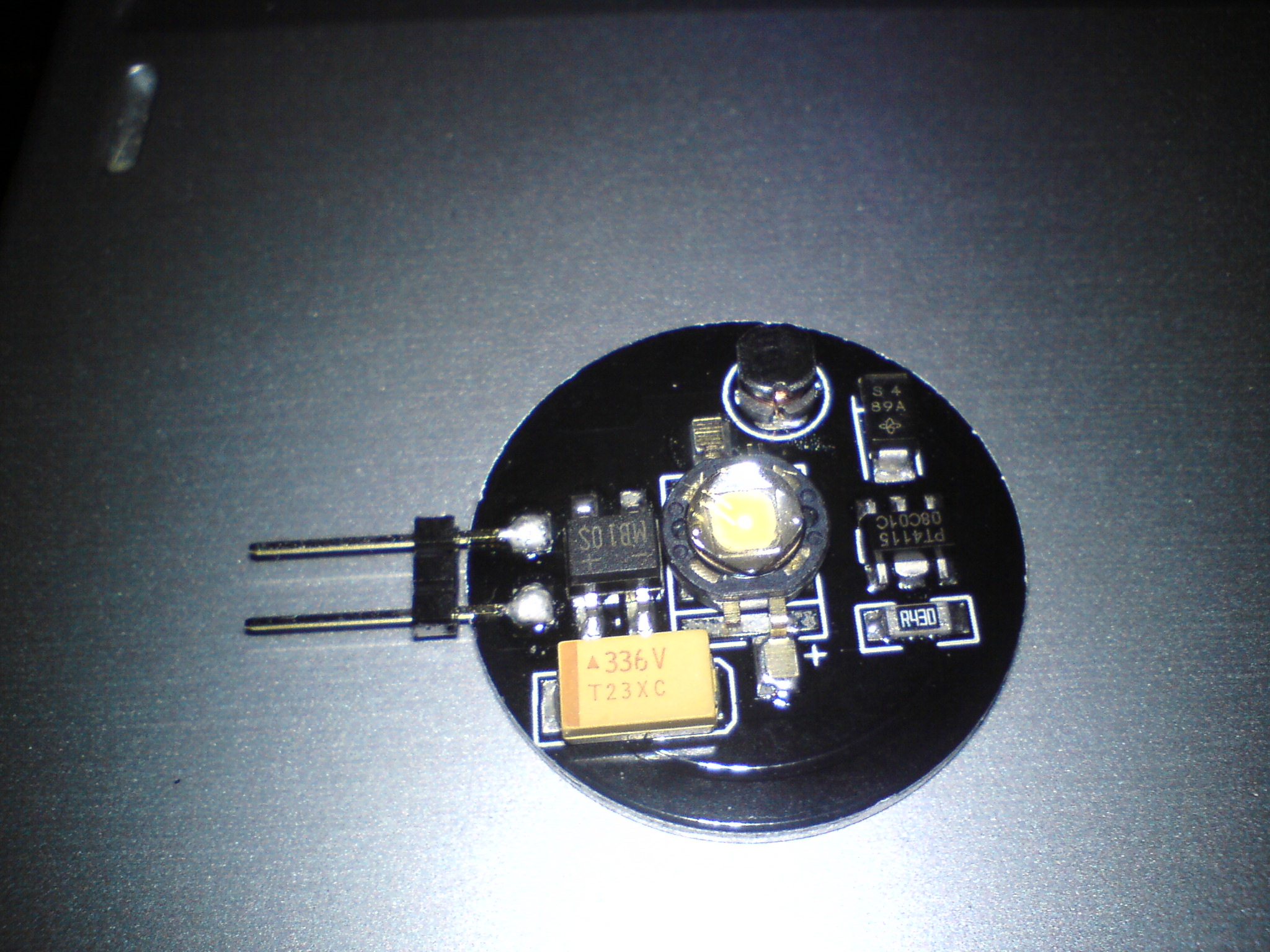

I`m trying to build a LED in to a E27 220V. housing. My big Q is, What do I need to drop the current to 12V. the LED is using 1,3Watt ?
and the 220V. is AC, and I need 12V.DC

What you need to drop the voltage from 220V to 12V is a transformer. 1.3 W for the LED sounds a little high. The power dissapated by the LED will be the product of the current flowing through it and the voltage drop across it. You can obtain the forward voltage of the LED from its data sheet but it will probably be between 2.5 - 3.5 V. The current flowing through it will be dictated by a current limiting resistor that you must place in series with it. The current can be calculated by using V=IR and once again you should obtain the appropriate value from the data sheet. If you're uncertain start around 15 mA and work your way up until you reach the desired brightness. Also, you don't need 12 VDC. You can use the 12VAC from the transformer. The LED will only be lit half the time but it will be blinking so fast it will be unoticable.
without knowing what the operating voltage and current of the LED is, it's a little hard to give definitive answers. Basically, to drive an LED from mains, you will want a converter: maybe a transformer (very big), or a SMPS (small, efficient & output voltage/current adjustable). You can get a 2.5W SMPS for under $3, and with a little tinkering you'll be able to get it to output a constant current to the LED (and maybe even get it to fit in the lamp housing).

I googled the components used in the circuit you showed and found the datasheet of the buck converter that drives the LED. It's the PT4115.
In this datasheet, at page 15, figure 1, you can see the schematic of the bulb's circuit.
The strange thing is that the recommended maximum input voltage the PT4115 takes is 30 V (after the bridge rectifier), but the datasheet doesn't specify if it's RMS or peak voltage. Even if we assume it's referring to the RMS voltage (meaning that it could hold a voltage as high as 42.4V...), something is still missing.
Look inside the bulb for a little transformer. There may be one 220/18 transformer there. Or else the circuit wouldn't work (I think...). If there isn't, I don't know how it works...
And using the LM7812 is not a good idea. It's a linear series regulator, so it's not too power efficient. You can use it to build a smps, yes, but there are better integrated solutions. Besides, you would still need a transformer as the LM78xx series doesn't work at high voltages (higher than 40V).

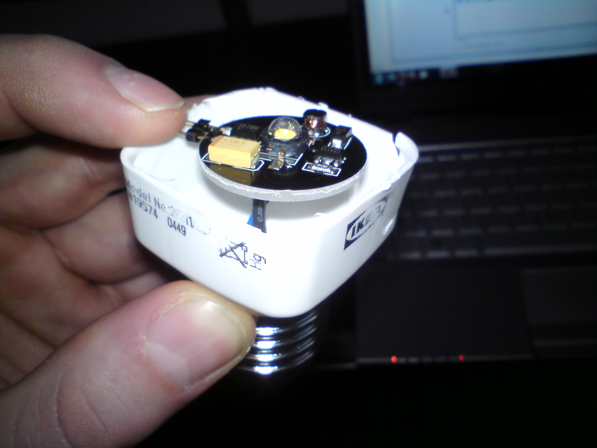

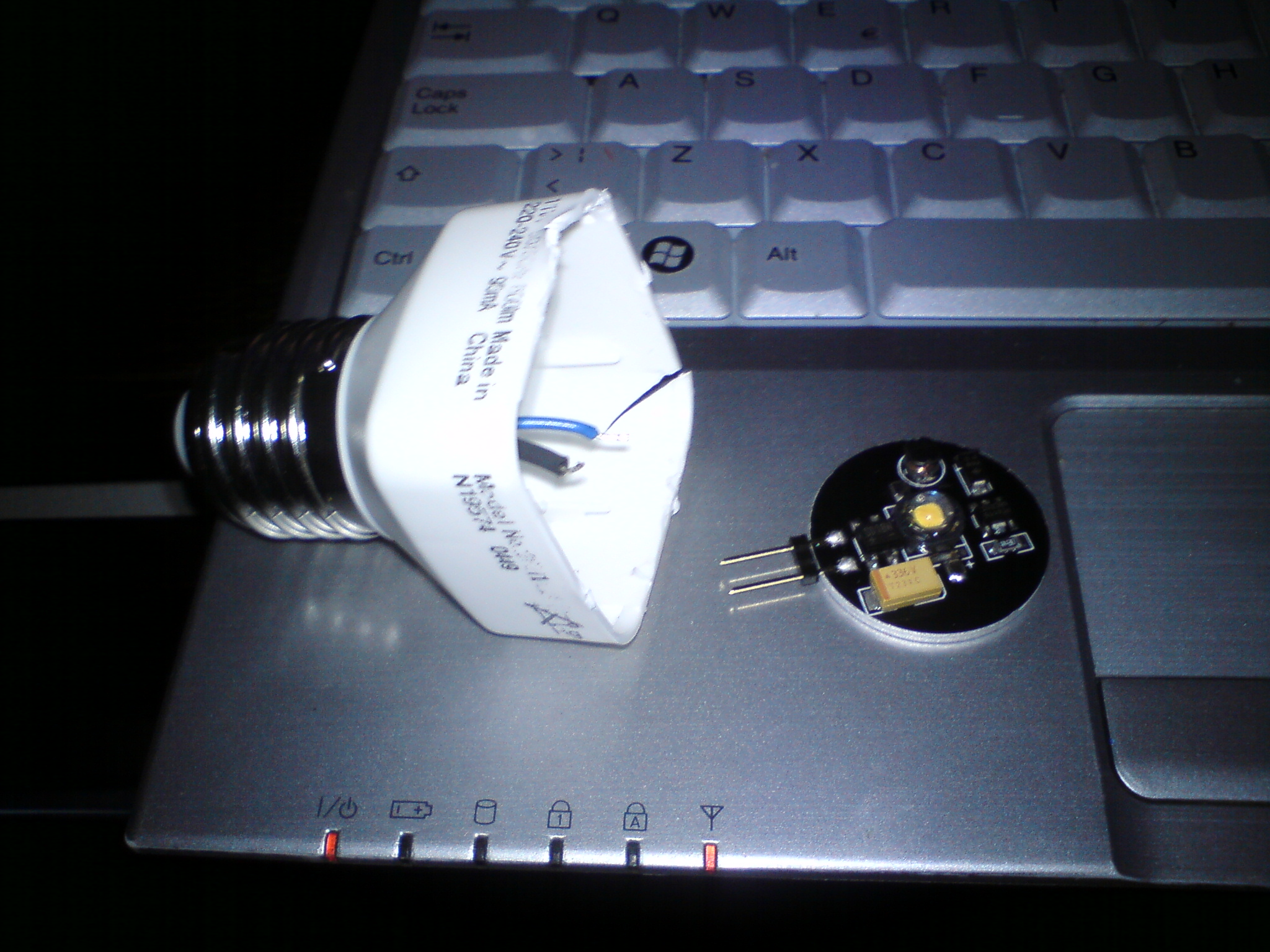

the pic. I added are what I want to built together.
The light bulb is designed to work directly from 220V. AC, the housing, is from a 220V. CFL
and the LED is designed to work directly from a 12V. DC
So I want to convert the 220V. ac to 12 AC or DC, and it has to fit in the housing :)
The point of this, is that I dont want to buy any thing, just using what I have lying around ;)

The IKEA led light that you took apart probably uses a capacitor for current limiting. It would have to be a 400 V capacitor and I can't see it in the pictures, but I can't see how else it would work. It could be inside the screw part of the light.
The component labeled S489A is a voltage supressor, which is really a high voltage zener diode. The 400 V capacitor lets a few mA through, limited in voltage by the "S489A" to somewhere around 40 V and the PT4115 and its associated inductor etc increases that current, while reducing the voltage, to drive the LED.
If they had just limited the current with a 400 V capacitor, the light would have taken more current and had a very poor power factor. The capacitor would have been very large. The design that they have used supplies 10 - 20 times as much current to the LED as is taken from the mains, but doesn't need expensive components.

I think you should read up above (caster.cp's post regarding the PT4115). The LED board is a low voltage buck converter. The S489A would be a schottkey diode. The IKEA housing is taken from a CFL; the OP seems to want to make a converter to sit in the IKEA CFL housing to make 12VDC to power the LED converter board.
