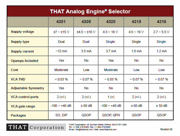

I am beginning to solder one of my first circuits, an amplifier for a parabolic microphone, and am trying to find a method to cull out loud sounds while leaving quieter sounds intact (because I don't want my eardrums to bleed when I have the gain turned up to hear faint sounds). If I were doing this on audio editing software, I would use dynamic range compression and I had hoped to find a good IC that could do that, but such isn't the case. A selective attenuator would be ideal because I could easily apply it to the projects I have in mind for radio when I have gotten enough experience to move onto them, but attenuators affect the whole amplitude spectrum while I am only interested in reducing loud sounds.
So, in summary, what can I use to cut out loud sounds while preserving (most of) the detail on quieter ones?

Yes, it is. First, Maxim makes thee MAX9814, a single-chip electret microphone preamp with traditional volume limiting built-in, and Adafruit sells a module based on it.
But for true dynamic range compression, go here:
http://thatcorp.com/Analog_Engine_Dynamics_Processor_ICs.shtml
A simple volume limiter is very different from a true dynamic range compressor. A DRC delivers significantly better audio with way fewer compression artifacts and noise pumping, but it is a more complicated design. Look at the 4315. THAT has a ton of app notes that explain everything, and you can use their app circuits part for part as an excellent starting point.
Analog Devices makes the SSM2167, an equivalent all-in-one part. It is less configurable than a THAT design, but might be all you need to get started.

  • THAT_Analog_Engine_Selector.pdf

Fantastic! That is what I was looking for. (BTW, I was talking about my finding a compressor in IC form when I said 'such wasn't the case'. I had no doubt they existed.) Anyway, I think I will try one of the THAT designs - they seem to be what I am looking for. A question concerning getting them, though, I am afraid I will end up frying it with my soldering iron when I try to tack it onto a breakout board. When you request a sample, do they give more than one? (It doesn't look like they sell in quantities less than 50-100, so I can't just buy 3 or 4 of them)

THAT is expensive, but the gold standard. SSM from Analog Devices is much less ($2.85), and easier to implement. Both are a pain to hand solder. The LM13700 is just a voltage controlled amp, and needs a fair amount of external stuff to turn it into a complete compressor.
And to Ron's comment - "limiter" and "compressor" usually are used interchangeably to mean a relatively simple peak detector driving a variable attenuator, usually in an opamp feedback loop. Better versions use something like the 13700 with a true multiplier cell, but they still are peak limiters. Separate from those, a true dynamic range compressor is based on RMS signal conversion rather than peak detection, a logarithmic transfer curve rather than a brick-wall comparator, and produces a very different output and listening experience.

The LM13700 is just the variable gain amp. No level detector.
Most of the THAT parts include everything.
Look at the SSM2167. It includes everything for $1.34 at DigiKey.com

Thanks for all the help. The SSM series looks like a good cheep start, and I can branch out into the more expensive ones if I think I need the additional quality. (Anyway, it will be good knowing they exist when I start doing other projects.) I've found adapter/breakout boards for the different chips I want to experiment with, so I am ready to start buying components and finding out just how bad I am at soldering.
