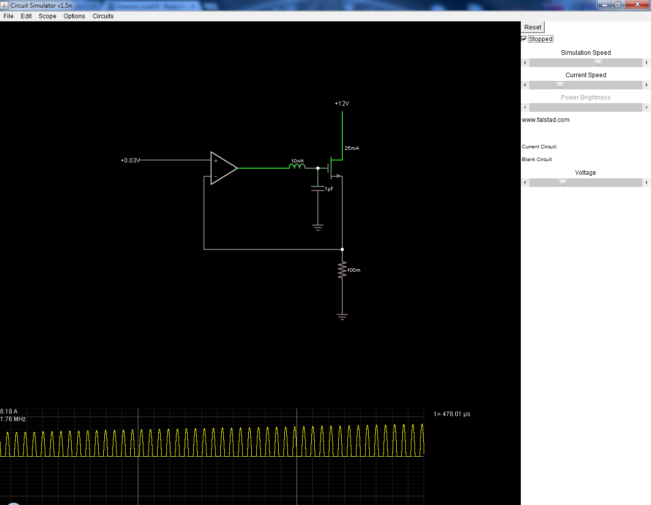

To me, one stops oscillation with a low-pass filter (slow things down, because the opposite of AC is of course DC.) But I understand the implications of what ronv is saying and it makes perfect sense too. However, what he says is in direct contradiction to the above idea. The more delay in a closed loop, the more it should tend toward oscillation.
I think I understand, but I'm not really sure :confused:

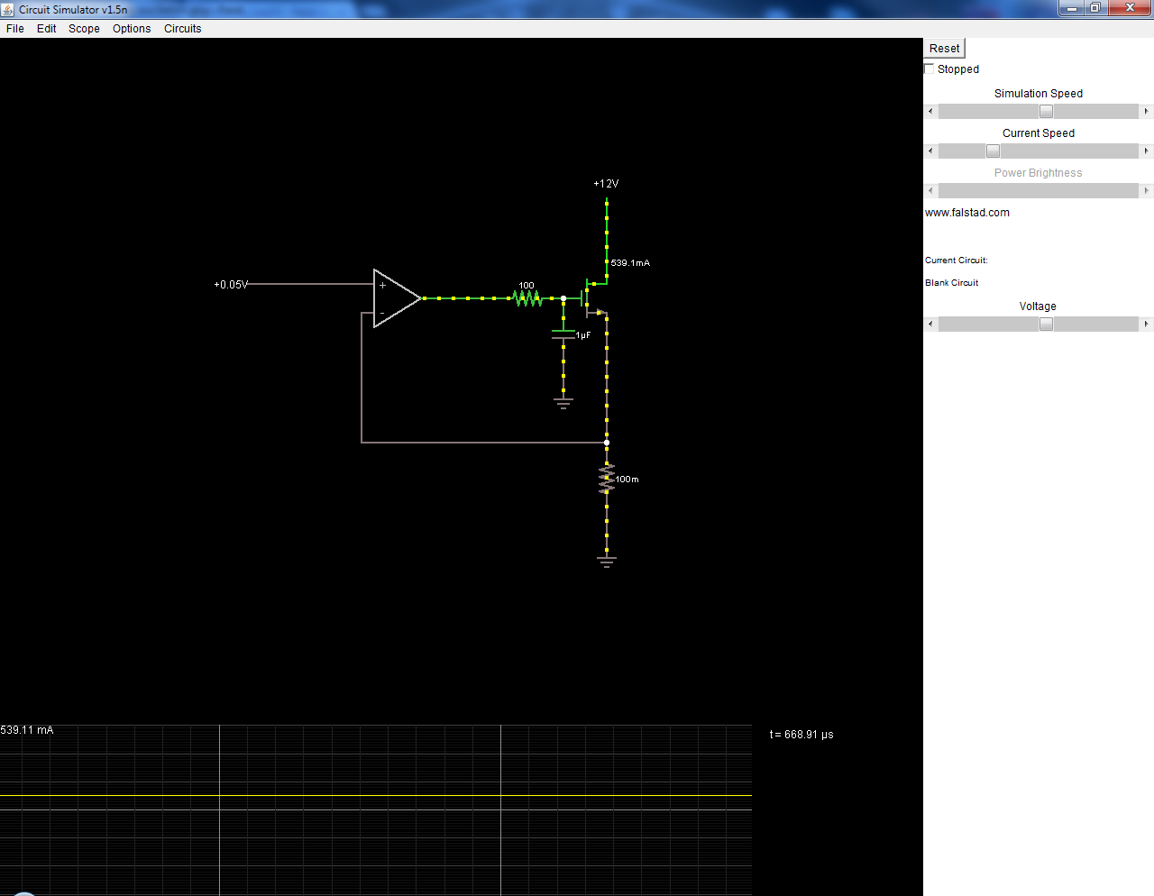

During simulation I can only get our FET/Op-Amps circuit to oscillate if there is some significant inductance in series the gate/output wire.
But with the resistor and capacitor integrator it hasn't produced any negative results, which is not in accordance with ronv's take on this, as this configuration does add a whole lot of delay. More than the above inductor + cap does.

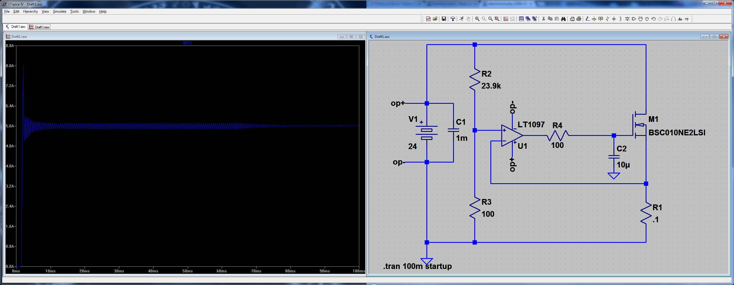

It looks like the RC version has delay, but is not phase delay, and that is making all the difference. If I had known that, I would have finished my original thought and suggested we use a RC low-pass filter on the FET gate like Mr RB has done.

This could indicate that the circuit is in fact genuinely oscillating and needs to be worked on. But it could still also be a misbehaving power supply. We can't do anything about the power supply really, but it is fairly easy to fix oscillations.
My simulations above show that the system will oscillate if there is an inductance (the wire) in series with a capacitance (the FET gate) if there is little to no resistance in line with it. My sim also showed that if you put a resistance in the circuit, it will stop it. This is about the only thing I could see causing oscillations.
(), Try it in spice with a little pulse on the reference voltage and you will see the ringing on the voltage on the sense resistor.
Hummm.... Looks like you are more or less right, here are the results.
Though I'm not getting a full and steady oscillation out of it, just the ringing. We are seeing a steady oscillation in the real circuit, which is what I am trying to reproduce.
I only just started playing with it though. Still want to try some more things. . .
