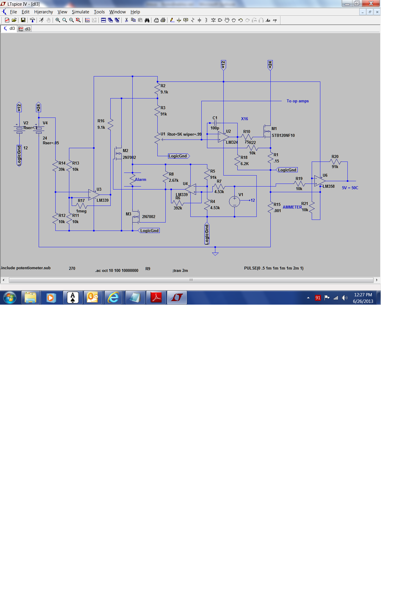

Dummy Load II
One last tweek. I'm trying to keep this one from oscillating. I think I'm done now.:D:rolleyes:

()blivion, so on the other hand I think I would want as much separation between the MOSFETs on the copper pipe for cooling purposes so is it just a trade-off between these two things and if so which one wins out, what is more important? Or I wonder if there is some way of shielding the wire from interference?
Here is one thought. If you make the square say 6 inches on a side you could put a board inside of it. Since there are 4 op amps per package - one on each side. Put the 75 ohm close to the FET. The rest of the stuff could go in the middle. Just my 2 cents - and worth every penny.:)
Ohh. Use the STP80NF12 like last time. It has a DC spec the one I used in the sim doesn't have.
Hey Ron, in the latest updated schematic above in post 381, is R15 really still just the ammeter, or did you add another resistor there?
Ok, that's what I thought. Thanks, I am working on building my order at Mouser. Did you get a chance to look at that box I put a link to in post 386, do you think it will be big enough?
It may be hard to bend 1/2 inch pipe to fit nice in there. It will need a pretty large radius for the bends I think. If you don't mind the big one it would be better for the heat.

Hey Ron, I found the ASC file in an earlier post, but it was not the updated schematic. Can you post the most recent version of the schematic in *.asc format from LTspice? Thanks!
update:
got it via email, thank you Ron!

For the MOSFET's and how close they can be on the pipe, I really don't think you will see much of a heat difference with them close together or far apart. The pipe being copper, should share heat from one end to the other at a really fast rate, and the whole thing should transfer heat to the water at light speed. So don't worry too much about the most efficient spaces between them. As for noise, as long as you keep all the gate wires short and don't twist them all together with other wires, you shouldn't be able to get them close enough to see any noise issues either. The issue with wire proximity is really about touching wires, or possibly long runs of two or more wires that are consistently somewhat close to each other.
Edit: Don't be afraid to get multi-dimensional with your wire layouts if you can. Having say, all the gate wires pulled up, then all the drains pushed down, can give you just as much separation as if you did it left to right or forward and backward. But may or may not be easier to do.
Thanks ()blivion. I think I am going to try to get plugs for the MOSFETS/Current adjusting POT/+12v PAmmerter...basically anything that will reside off the PCB so that I can easily take it a part for possible future repairs. If I get a socket and put the signal wires to the gates next to the power wires going to the MOSFETS, will this create a problem?
