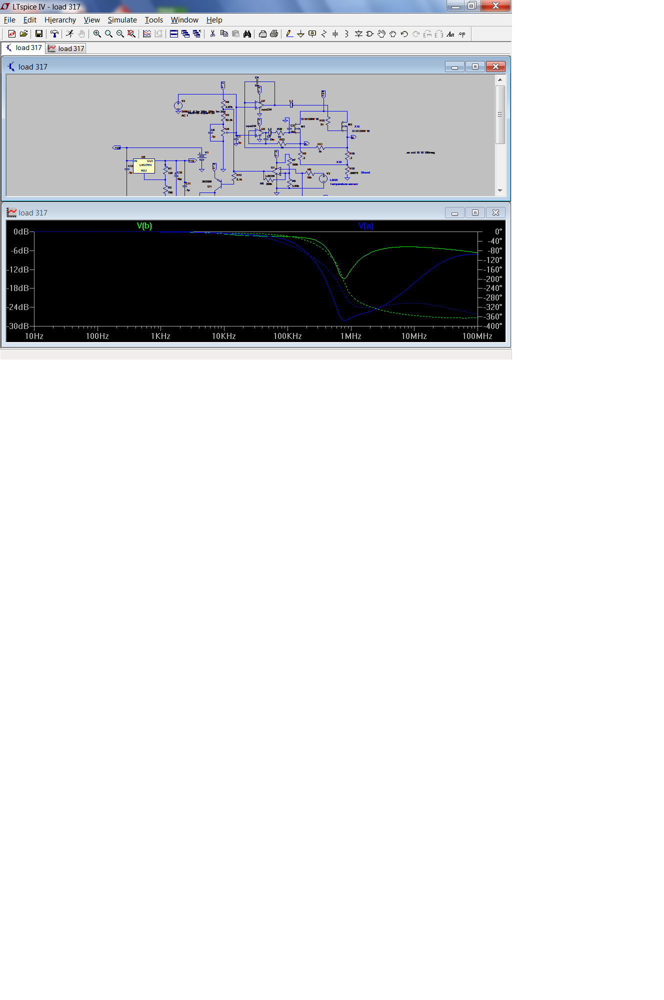

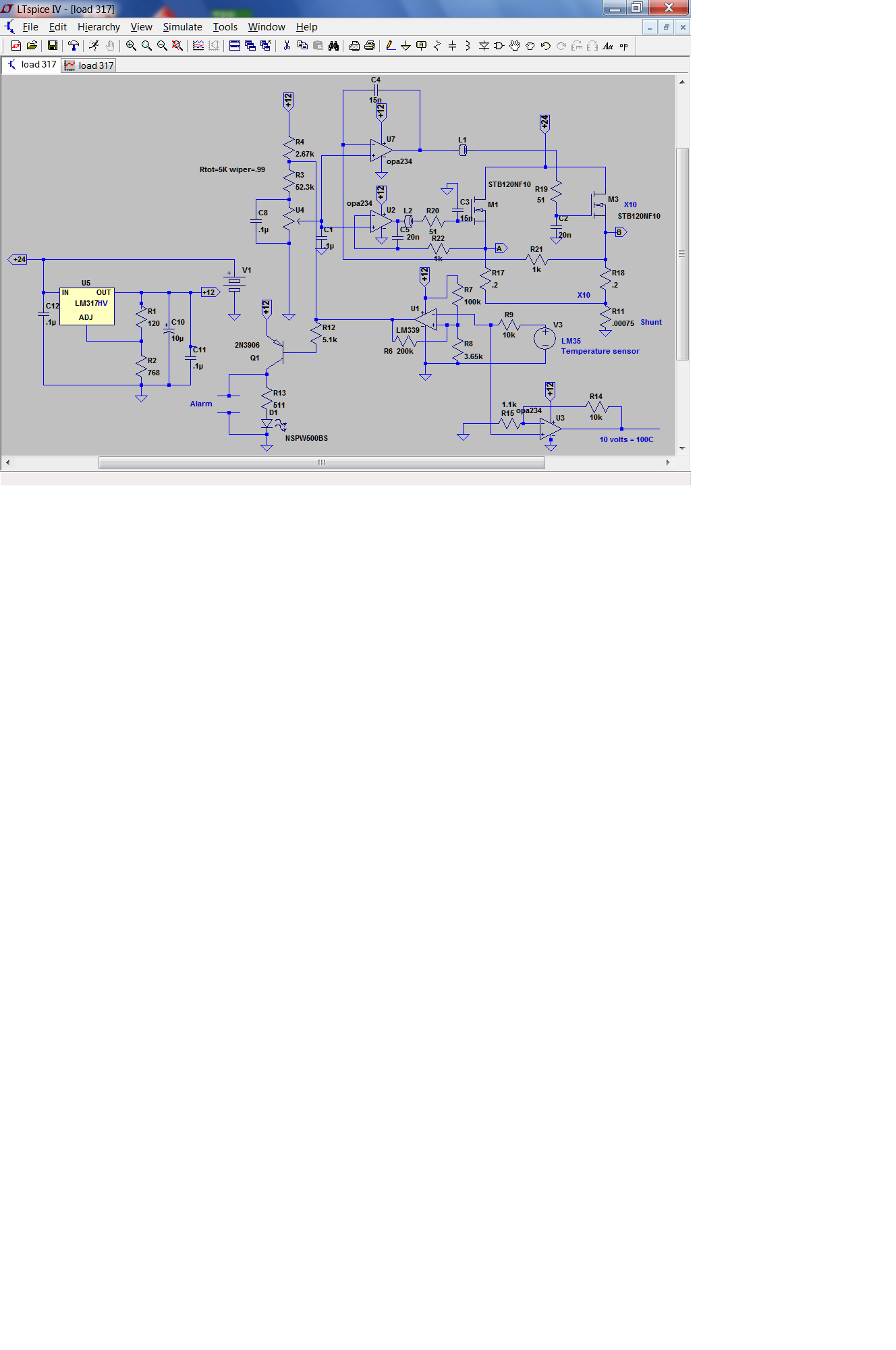

Hi TC, I think your right something is oscillating. So here's the latest.
I added a voltage regulator so the 12 volts will come up after the 24. This makes the reference more stable and it would let us use Mr. RB's idea if we like. The +12 is really +9.5 now - I forgot to relabel everything.
Raised current sense to .2 ohm.
Rescaled divider for 15 Fets - 8 op amps.
Lowered the temperature cut off to 50C.
Added the current shunt.
Changed to Ducey's op amps for less offset and better phase margin.
Changed FETs for slightly better ones.
Added roll-off to the op amp and to the FET gate to hopefully improve margin due to layout etc.
I added a bead, but have no idea which one to specify. I need to read up.
I didn't show the fuses, but we can add them. I'm a little concerned that the path from the FET source to ground is going to have a lot of inductance in it now. We may want some clamp diodes for when the fuse blows. I also want to model it.
Looking at your most recent post, I'm now not sure how the opamps and FETs are configured. You say 15 Fets and 8 (dual?) opamps. Does this mean that one opamp drives one Fet? From looking at earlier schematics I thought 1 opamp was driving 10 Fets. In the later case, you are likely to have a parasitic oscillation between Fets.
If each opamp is driving 1 Fet, then you might be able to omit the ferrite beads. But there is still some possibility that there is oscillation between Fets. He would need a scope to be sure. In your schematic, I would swap the position of the gate resistor and the bead. Slip a bare ferrite bead on the gate lead of the transistor.
Thinking about it more, a ferrite bead may or may not be necessary. Just adding enough gate resistance might do it. But without a scope there's no way to know what is required. This isn't a high speed switching circuit. The time to charge the gate isn't so important. And besides, the opamp current limits at 10 mA.
C2 and C3 can be omitted. They just cause more work for the opamp and might decrease stability.
Your idea about the fuses and resistor inductance is interesting. What is the inductance and how fast does the fuse interrupt? You might be able to estimate peak voltage from V = L*di/dt. But if the fuse blows, something else already died and it might not matter.
Yes, 15 FETs and 8 dual op amps. Since they are running in the linear region they can't just be put in parallel because of the potential difference in threshold voltage, so each needs its own closed loop then they share the current.
Yes, I think the ferrite should be last in line. They are cheap so I think they are a good idea since we are going for the gusto before Jeremy needs to buy a scope.:D
I added the 2nd rolloff for a couple of reasons. One was if the 24 comes on or off quickly the drain to source capacitance couples it to the gate. Since in the come on situation the 12 volts isn't up yet I was worried about the op amp latching up. If the big supply (DUT) crowbars the negative transient may go past the gate source breakdown voltage. It also adds a second rolloff that brings the bandwidth down to 100Khz from 300Khz. Below:
